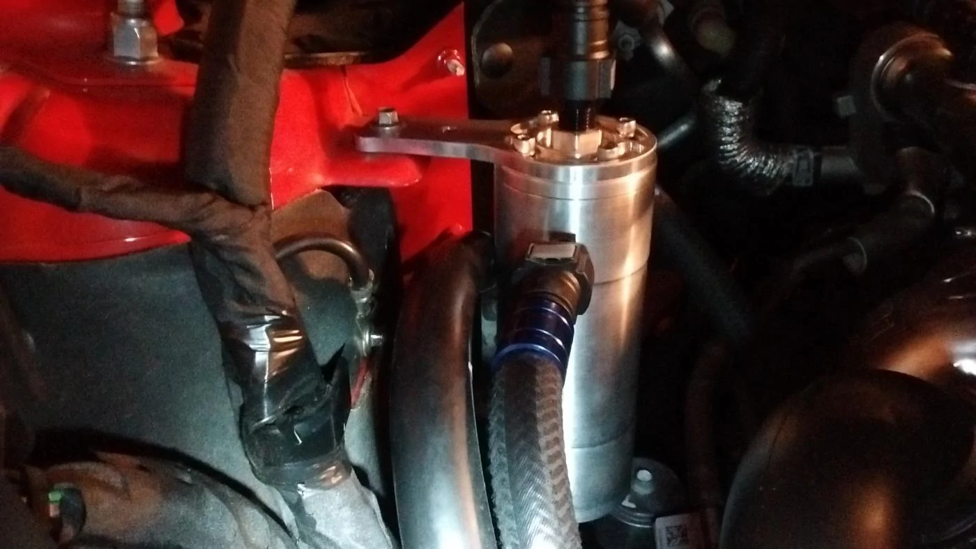

Came across this same issue when I installed mine. I moved the ground to another spot pictured below.

Thank you guys for the suggestions and letting me know I'm not crazy. I was starting to think I was just missing something or doing something wrong.
I ended up doing this and it's working great! If you ever end up in Buffalo I owe you a drink :cheers:
