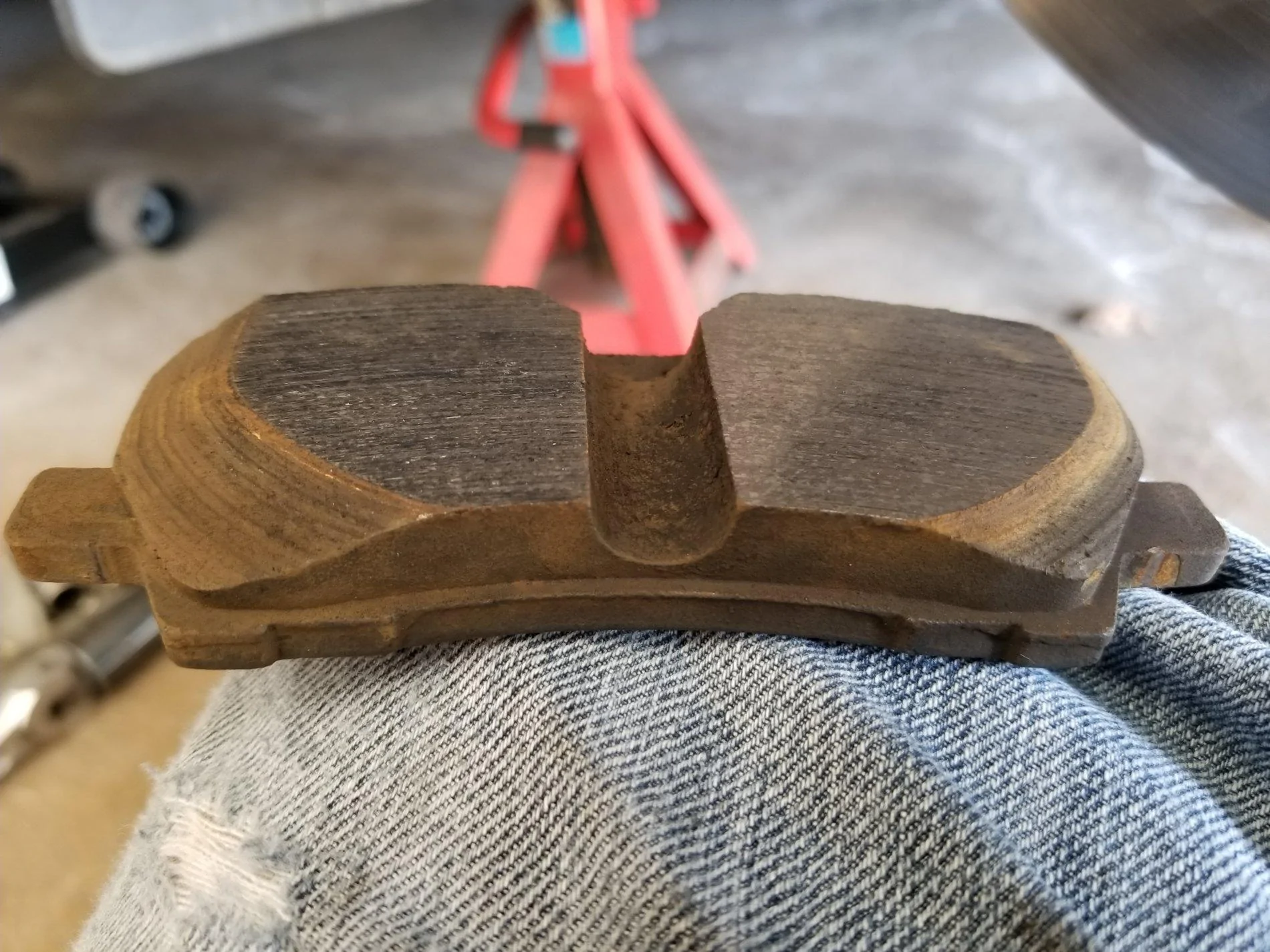

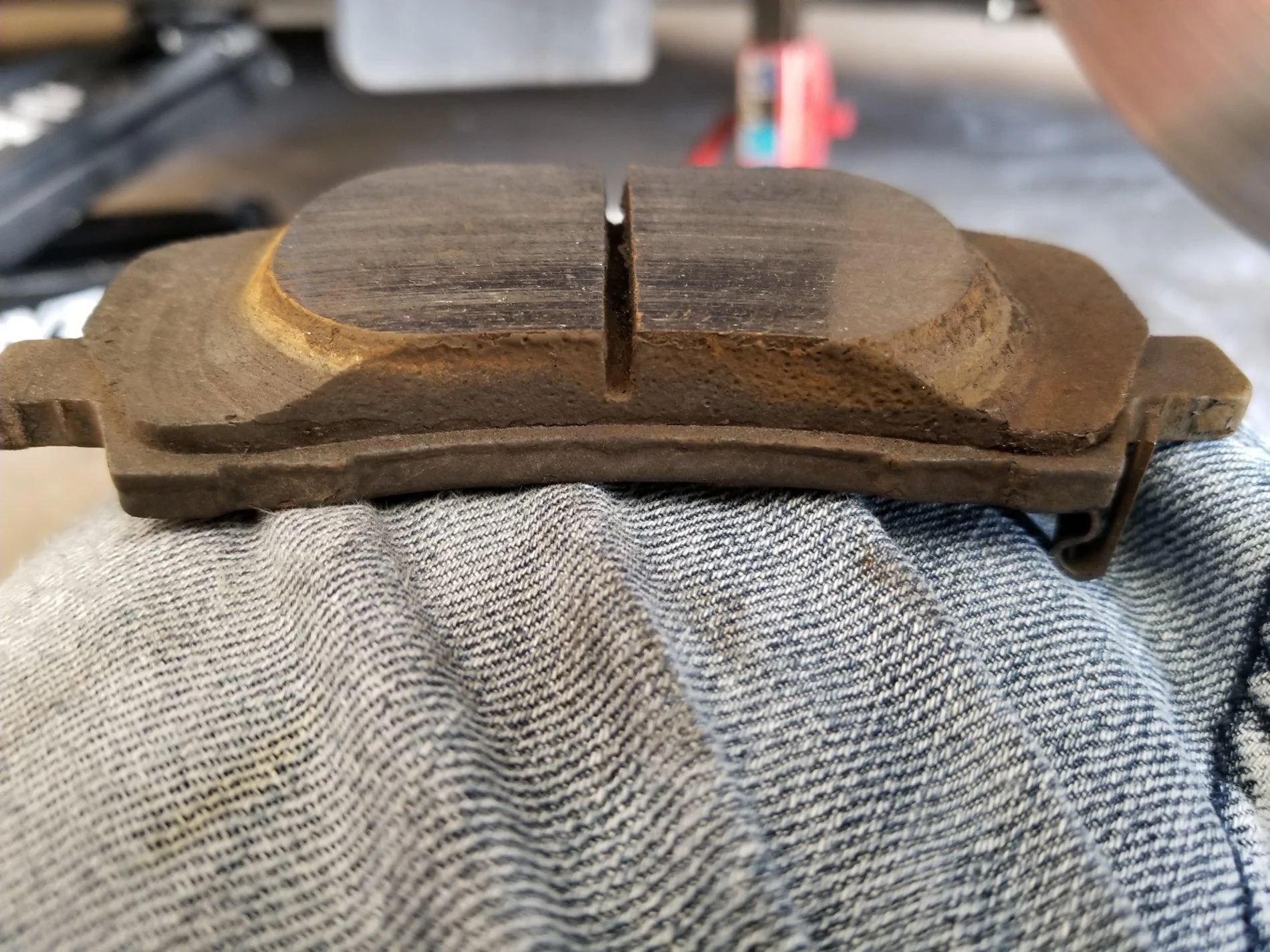

Was messing around with the spindle nut today cause i ended up with a loose tire. Decided to go a little more indepth and look at the bearing itself when I found this. why would the rear brake pads be made this way. Heat dissipation maybe? Seems like you would waste clamping power till mid life of the pads. Everyone else's OEM pads look like this?

Best guess is that it eliminates some vibration frequency or "moves it away" (frequency-wise) from where it would be noticeable. When pad edges are chamfered like that, it's typically for noise reasons as well, at least for the early stages of pad wear.

This is really interseting to me. I never thought about the noise aspect. Ive always heard that Mustangs preform better on the track with a lesser pad in the rear, so I assumed the design was to just give it less surface area/clamping power. When I swapped out rotors and went to a race pad that is more traditional in design, not slopped like the stock one, my brakes are MUUUCHHHH louder now. Also have stuff like diff busing inserts, toe bearings ect to transmit noises into the cab.

Brake noise is a big matter at both the OE and repair industry levels - very few drivers are willing to put up with brakes that sound like an old school bus or trash pickup truck.
Coincidences being what they are, the April 2019 issue of 'Brake & Front End' magazine (a repair industry periodical) that was just dropped on my table this morning headlines yet another brake noise article in big bold lettering on the cover.
