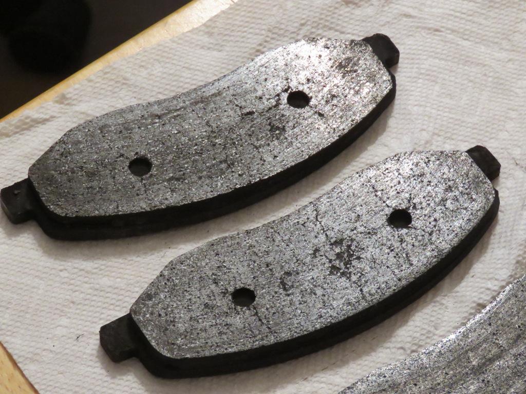

You'll probably find that 10's in the rear will outwear 10's in the front maybe 2:1. That's about what I was seeing earlier this week, with about 0.20" worn off the fronts, 0.10" off the rears.
Your car and mine are probably pretty close in both power and weight, and I don't think there's all that much difference in front-rear weight distribution, so I'm assuming that the brake heat loadings are similar. I did get 6 track days, though I do have slightly better front rotor cooling than stock.
XP10's will crack ↓↓↓ - it looks worse from other angles. You may well want to end up with a 12f/10r combination.
Don't know about Hawk track pads for the EB, but given that XP10's are significantly kinder to rotors than the entry-level HP+, it seems like a moot question.
