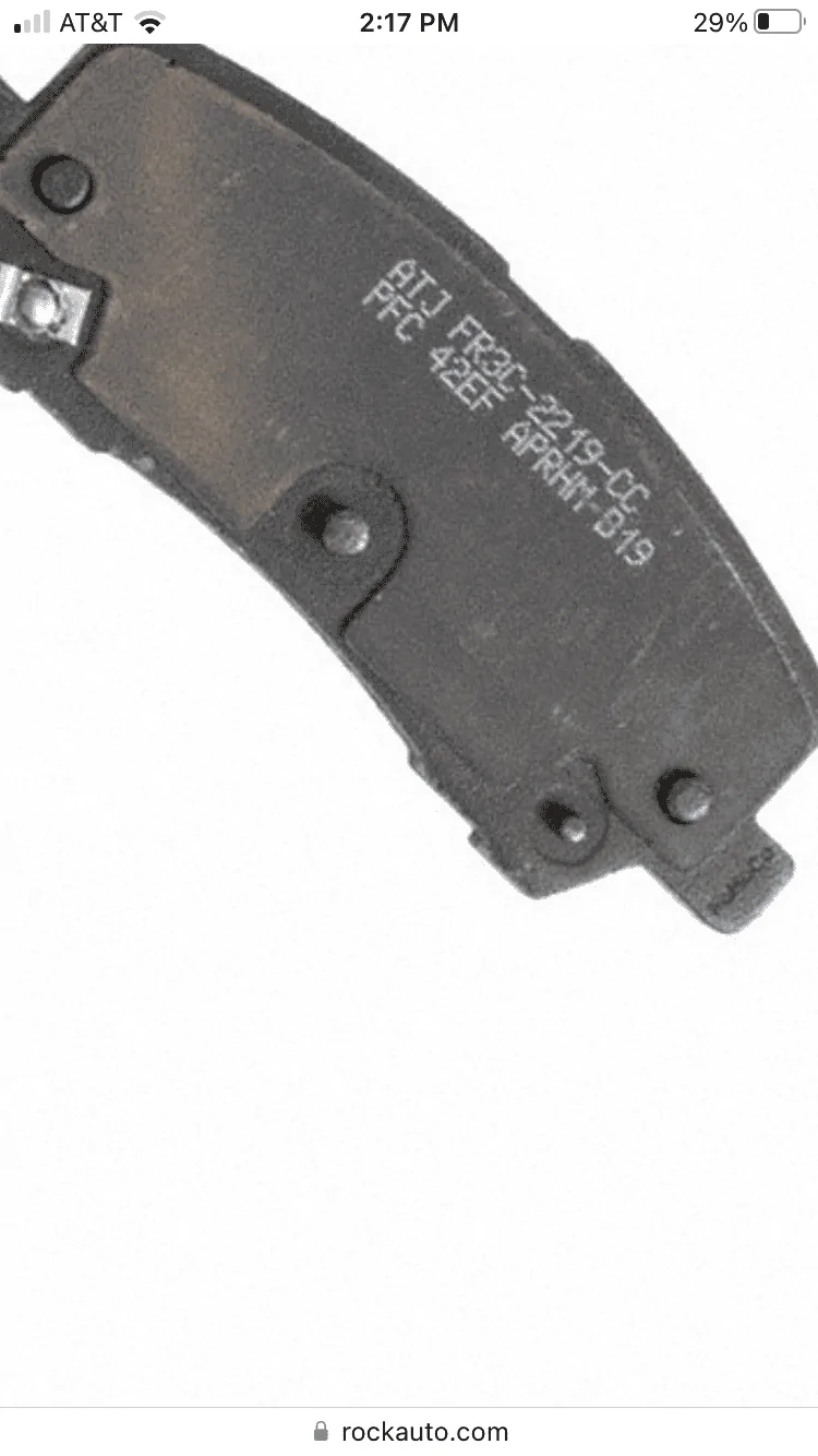

there was a recent post about which rear pads you need for a PP gt.
the answer was FR3Z2200G. i think this is only partially correct. it depends on if you have a manual or automatic transmission.
Manual trans PP uses brf 1566/ FR3Z2200G. this is a Peformance Friction Corporation pad with an EF friction code

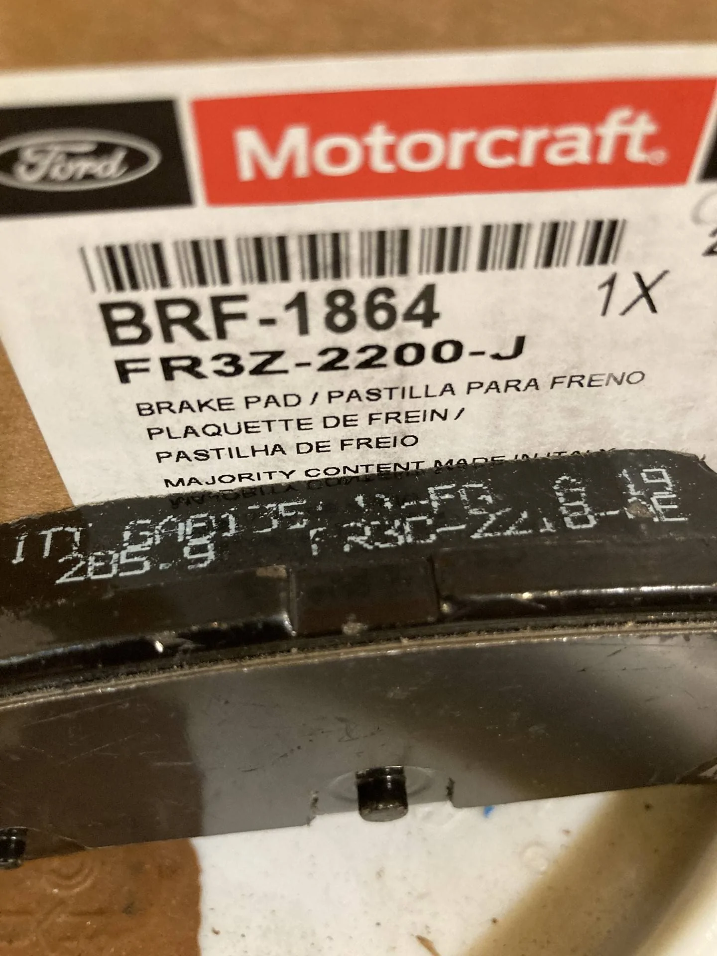

Auto trans PP GT uses part number BRF 1864/FR3Z-2200-J. this is made by ITT corp (makes koni shocks). it is made in Italy. it has an FG friction code.

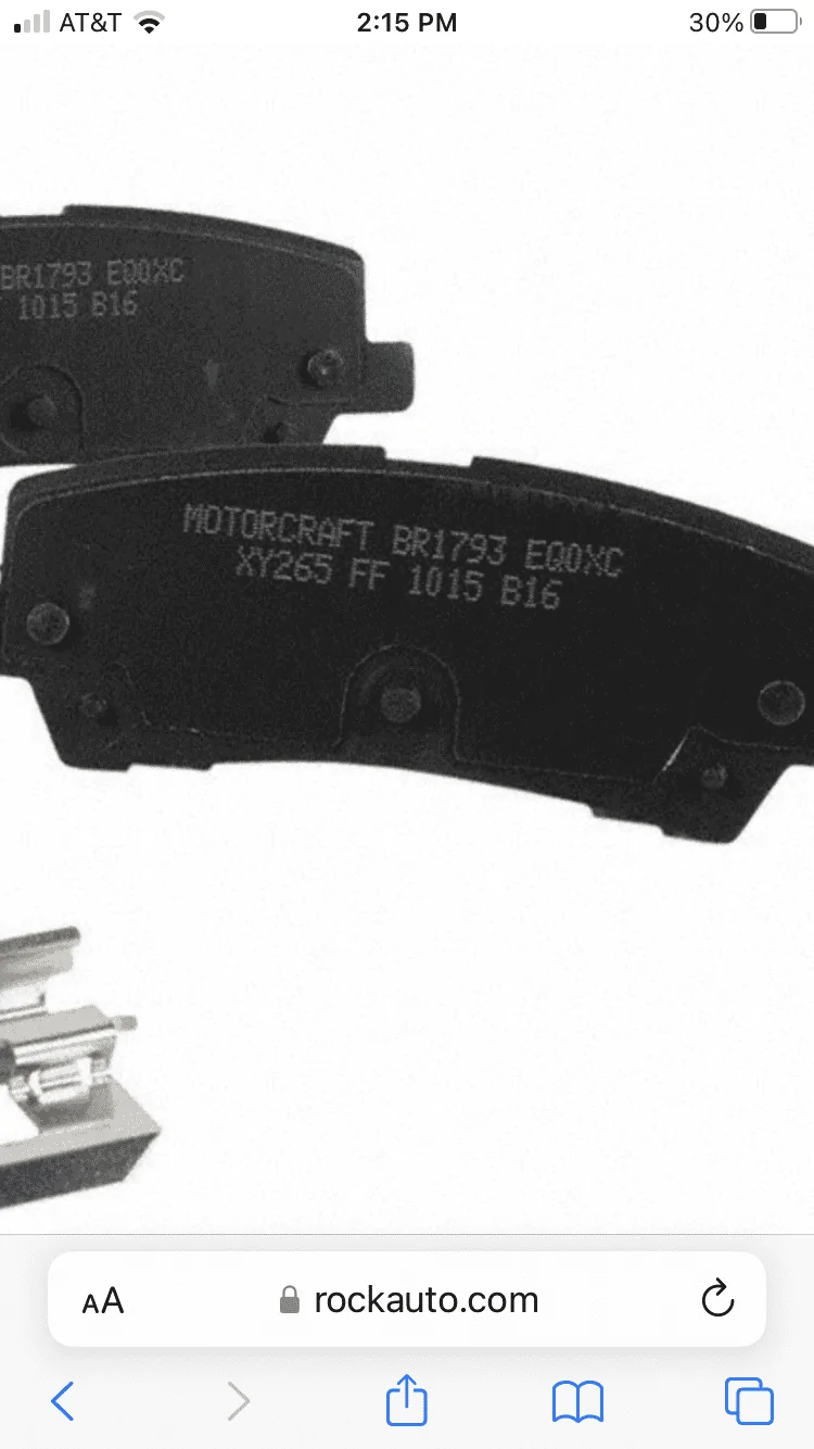

Standard GT uses part number BR 1793. it is an FF friction code
from highest to lowest friction is 1864>1793>1566
strangely, the manual PP GT uses the lowest friction. lower than a standard GT

I used the following items for the brake change:
Front rotors: BRRF448
Rear rotors: BRRF336
Front brake pads: BRF1955
Rear brake pads: BRF1864

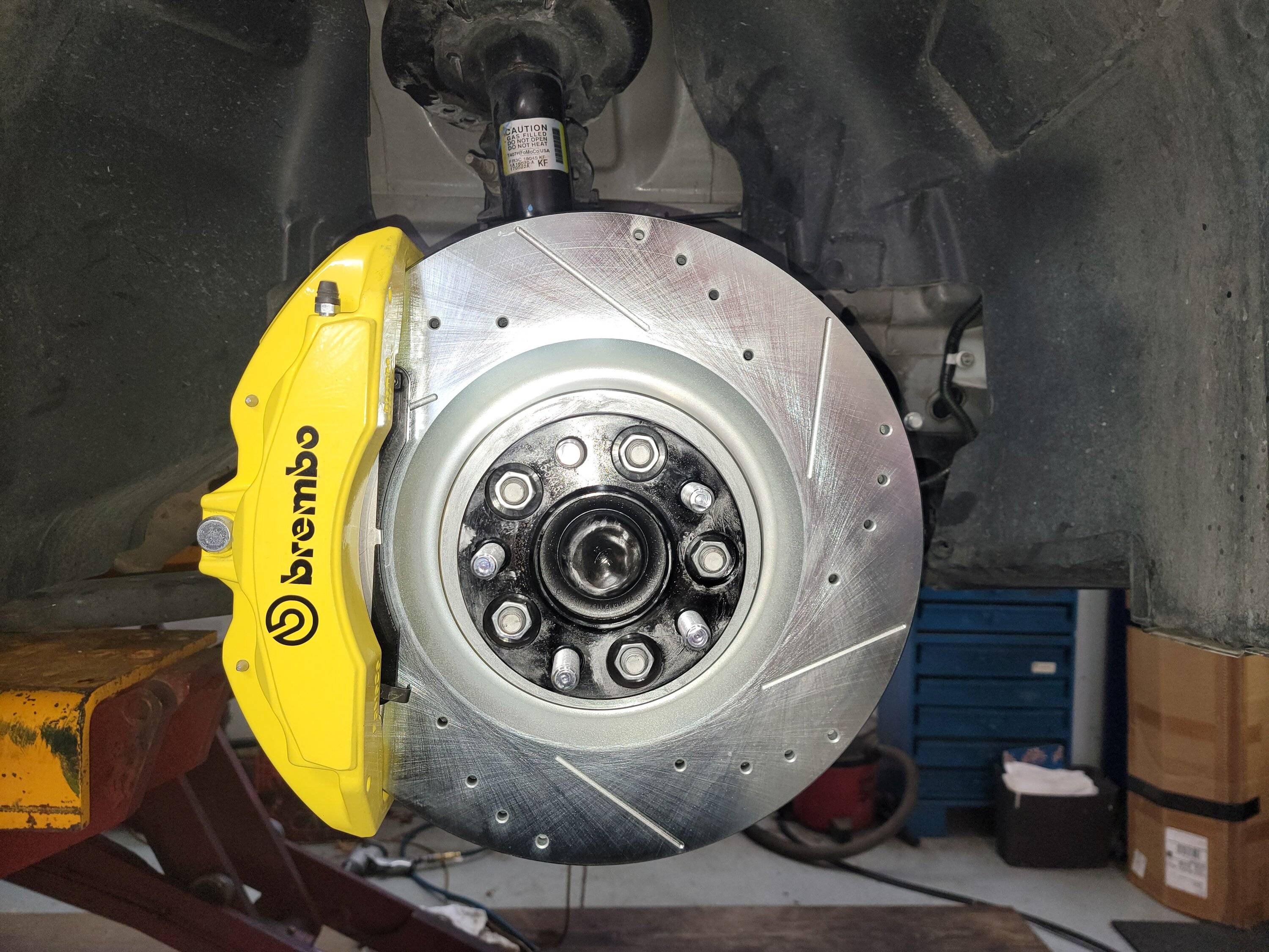

Everything worked out great. I will post pictures of the used rotors because the front left rotors have these deep gouges like there was something between the pads and rotors that ate away at the rotor.

@thornclaw , that's interesting. The stock rear pads that were factory installed on my 2020 GT PP1 Manual trans (I took a picture when I performed my first rotation) are FR3C-2218-CF, not -CC.
According to parts.ford.com, and using my VIN, the replacements are BRF-1864/FR3Z-2200-J, not BRF-1566/FR3Z-2200-G. When I try to use BRF-1566, the site tells me these are incorrect for my VIN.
If you are correct about friction from highest to lowest( 1864>1793>1566), it might explain why my rear rotors are wearing out faster than my fronts. I've never encountered that on any other vehicle I've owned. I'm not complaining, as these brakes are among the best I've ever had.
You are citing RockAuto results for the part numbers and friction ratings, I assume? I'm not trying to pick a fight, just trying to understand the conflicting information on pads(not just here on 6G, even the vendors are listing conflicting information, eg Tasca, Levitown, etc)
