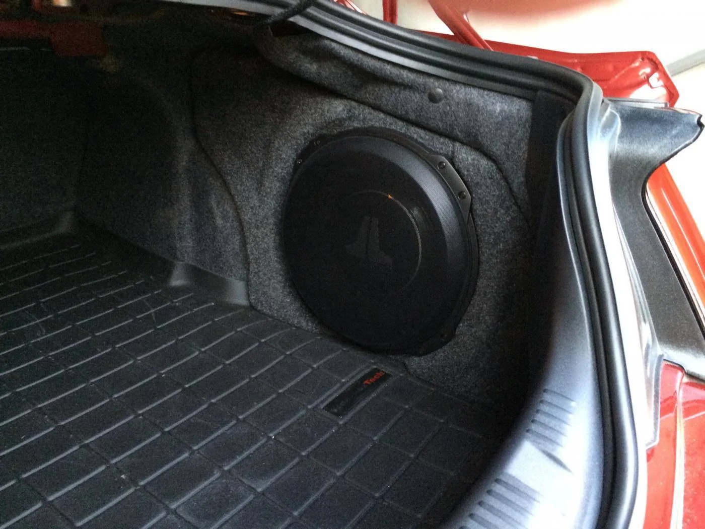

I don't personally believe it. I installed my little alpine Mono-D amp under my driver seat, and that was a tight fit. No way can a speaker fit under there, especially if you have a premium, the wire harness etc.. sliding forward back, it just won't work.
Not a chance- IMO. I wouldn't even attempt it. the money/time/reward isn't worth it for the slight bass that will put out.
If you want bass, just get an JL stealth box, put the amp under the seat, and bam. clean install; (its what I did)

I bought my JL Stealthbox used for 6 months off this site for $400.
Bought an amp 100, and wires, 50
550,‘I had an amazing bass. 10x more than regular shaker subs.
I’d look into them, or look crutchfield see if any open boxs

+1 on the stealthbox.
i had the upgraded speaker in the original sub box, then upgraded the amp, then went stealthbox.
Should have.saved money and went directly to stealth.
that thing slams with the 300a amp I used.
