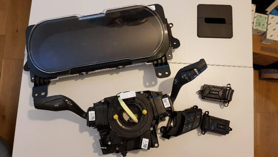

Lots of people asking on facebook etc where/how i did this so thought i'd post something here for all to see. I know lots of us don't venture out from the UK section very often :)
Firstly, all my info came from the guys over in the US sections. This post linked below is a goldmine of information.
https://www.mustang6g.com/forums/showthread.php?t=99275
Credits: [MENTION=20657]db252[/MENTION], [MENTION=32917]p6cl[/MENTION], [MENTION=29356]breeves002[/MENTION], [MENTION=6944]zackmd1[/MENTION], [MENTION=25893]DanMc85[/MENTION]
The actual screen I ordered from the US because Ford UK parts department wanted ~£2,600! :eyebulge:
Part numbers are in the first post on that link. There are different screens for auto/manual.
I eventually managed to get one from OEMFordPartsDirect for $1294 (inc $300 core charge which you won't get back).
https://www.oemfordpartsdirect.com/oem-parts/ford-instrument-cluster-jr3z10849alc
This was the third supplier i tried to order it from, the first two both cancelled my orders without any communication at all.
I've been in contact with some of the US guys who are doing this too and one of them ordered it the same day as me from the place i did succesfully get it from and had his order cancelled because "they can't do orders for clusters over the internet."
Levittown parts also say something similar about the GT350 dash on the forums that they can't sell them online. Yet i did get this one and so have some others. It seems a bit hit and miss.
They wanted a ridiculous amount of money to ship to the UK, and I also worried that that might harm my chances of a successful order so I had it shipped to my US Stackry address.

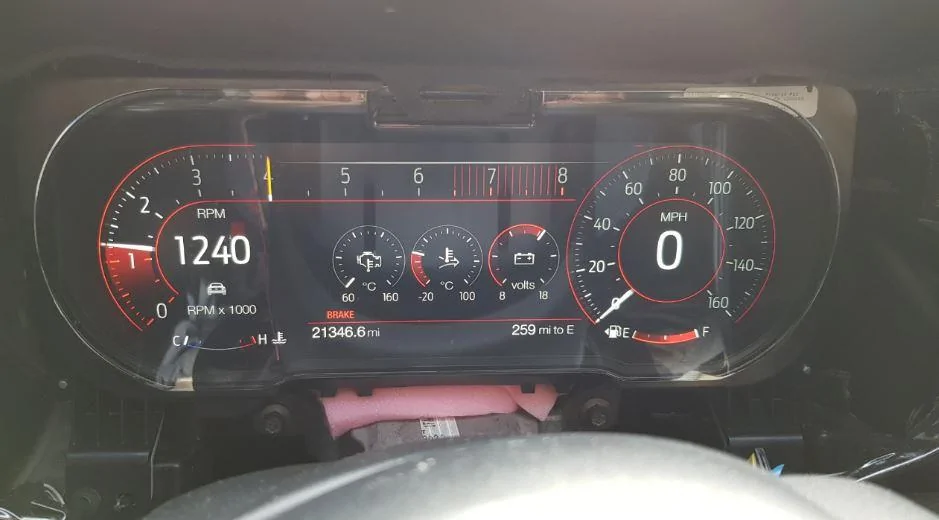

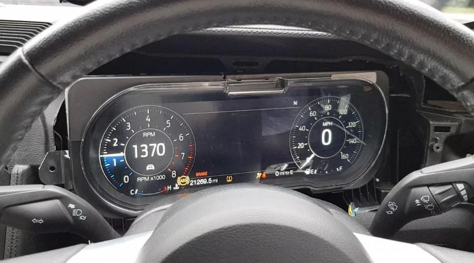

When ordering the cluster they ask you your mileage and it then comes pre-programmed with the figure you provide. They will ask you why you want it too, and I just said I was retrofitting it to an older model and they were fine with that.
The rest of the bits, switches, steering column have/had back orders in the US so although they were much cheaper, i was very impatient and ordered them from Ford UK as I was told they were all in stock in Germany and would be here in cpl weeks. Could have saved £235 if i'd have waited and got them from the States, but that could have been weeks/months.
UK / US part numbers & prices
2150670 / JR3Z-9C888-AA- Switch (upper left)- £49.46 / $18.01
2150672 / JR3Z-9C888-CA- Switch (upper right)- £49.29 / $18.01
2161894 / JR3Z-9C888-EA- Switch (lower right) - £50.63 / $17.90
2165236 / JR3Z-3F791-AA - Steering column housing (w/ SCCM) - £178.84 / $81.70
2198276 - Bezel (RHD) - £123.63 (still backordered)
Cheapest cost by buying most parts from the States, $1,430 + shipping (~$50) / taxes (~$350) so total from States $1,830 (~£1,290)
The Bezel from the UK is £124
so total £1414.

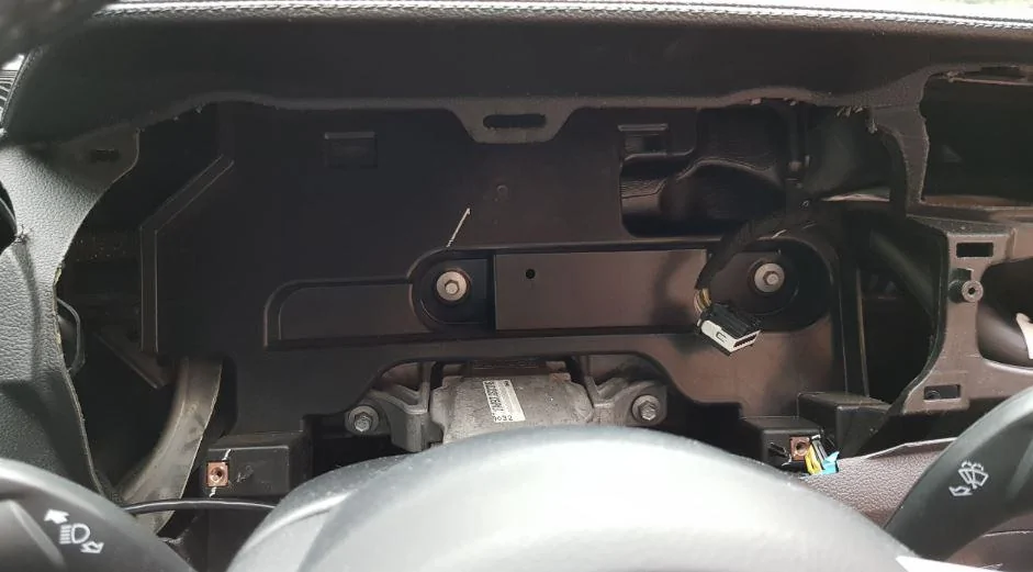

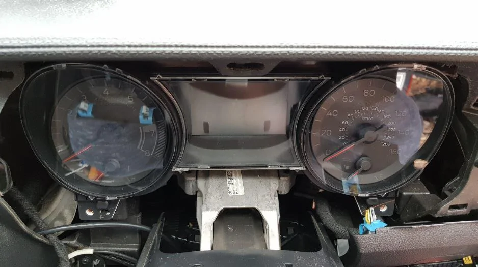

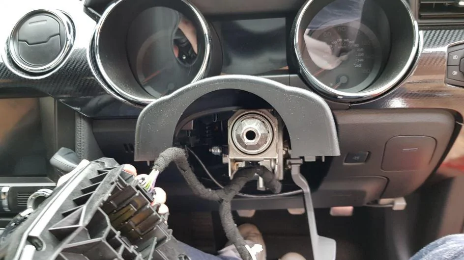

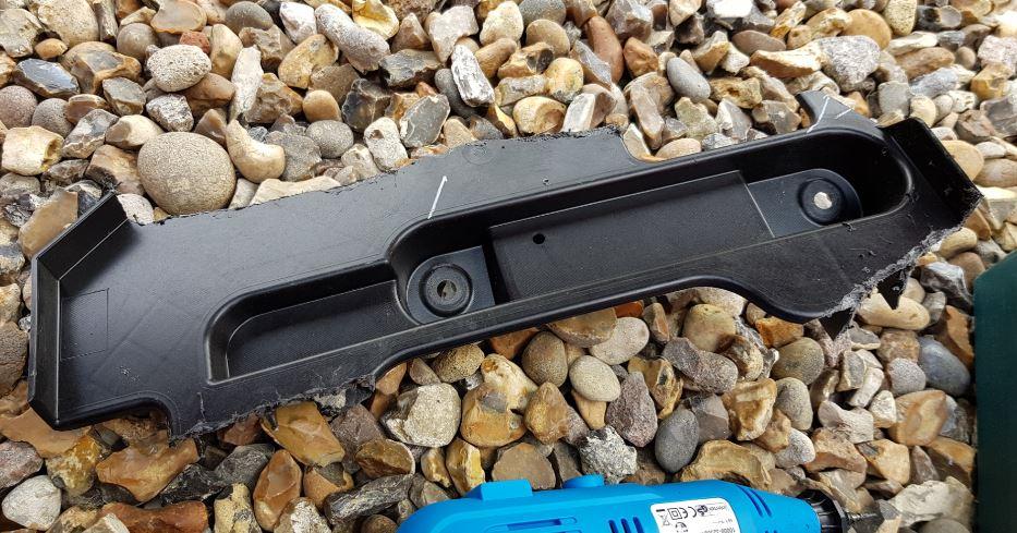

Installation involved removing most of trim around dash/steering column area, replacing Steering column control module, replacing 3 of the 4 steering wheel switches, unplugging old cluster, cutting the bit of plastic behind to make room for the deeper sitting new dash (dremel jobbie), mounting new cluster, programming via OBD2 port with Forscan removing all the american luxuries that we don't get, finally replacing all trim.
The installation process is detailed further in the link posted above. The only difference for RHD is the plastic trim behind the clusters' cutting points are reversed.
If you find the above daunting and live anywhere near Bedfordshire i'd be happy to lend a hand.
Unfortuntately I'm still waiting on the trim bezel part from Ford UK, on back order but i was too impatient, and the mileage has to be pre-programmed by Ford into the speedo so if i'd left it any longer i'd have been understating the mileage (it's reading 120 miles more than my old one did) :headbonk:
massive thanks to the guys over in the US section of the forum for all their help on this & hopefully this will help some more UK owners to be brave enough to take the plunge as I've proved it works!!

ok, so the americans are ordering with an inflated mileage reading and then just lining it up best they can. no one has reported anything critical. mine is about 100 miles out and I have a DTC on the IPC of "Invalid data received from the ECM/PCM - Alive/Sequence Counter Incorrect/Not Updated" which i assume is related to the mileage being not 100% accurate?
it is not causing any lights or notifications on the dash itself, I've just seen it in Forscan. I have been told that Ford can reprogram if necessary if you find a helpful dealer, whether they will or not is a different matter. guy on facebook group says he has tools needed to do it too although i can't verify that.
Safest/easiest thing to do I guess is to order with higher mileage and then wait to install when they line up.
