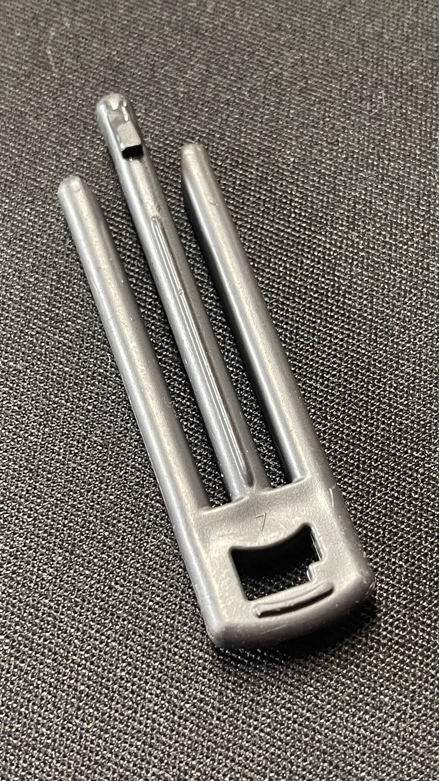

I found this random thing trapped under the loom under the rear seat when I was checking the plugs etc
anyone any idea what it is?
