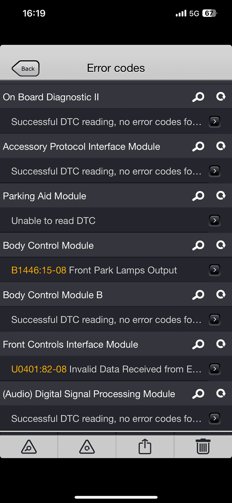

I have Forscan lite, so plugged the dongle in, screen shoted the codes and cleared them, started and drove home 30 ish miles with no issues.
Here is what I found…….

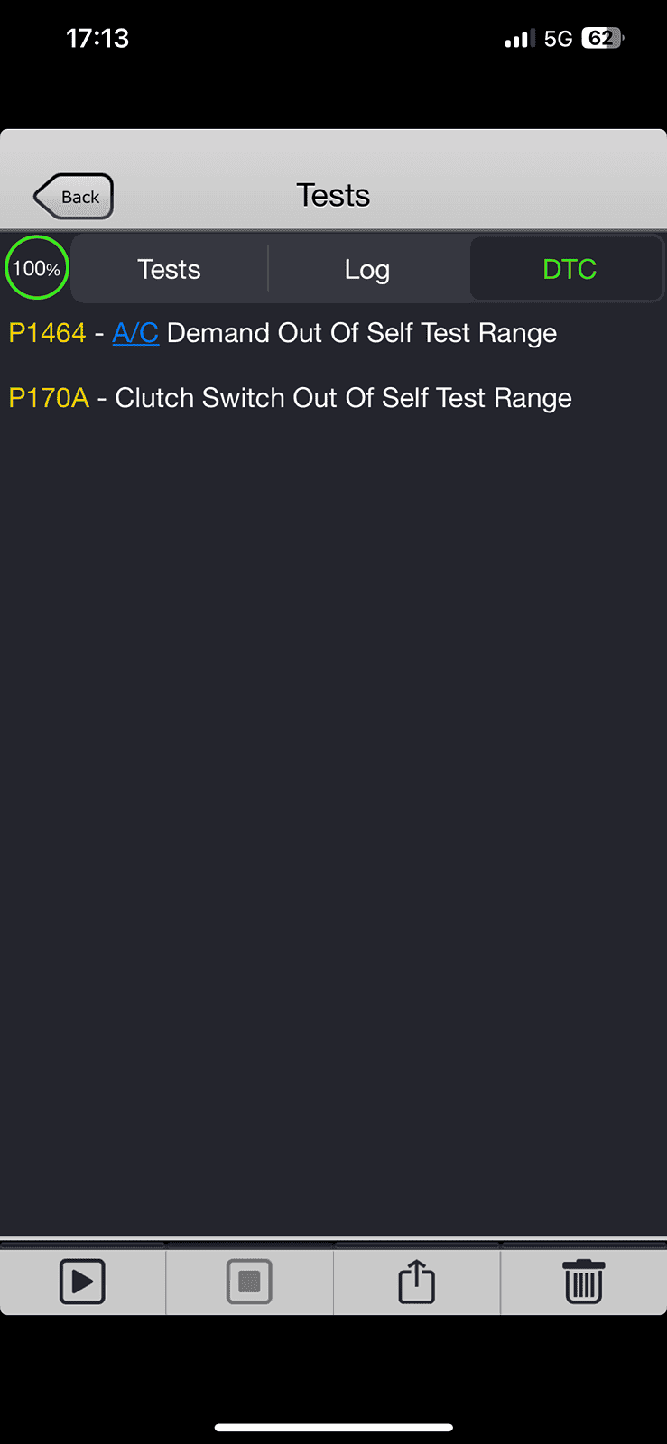

At home I did a self test which also flagged these,
Bearing in mind I’m not a mechanic but feel very much on my own with this as no one anywhere near me seems to have the knowledge or desire to help.

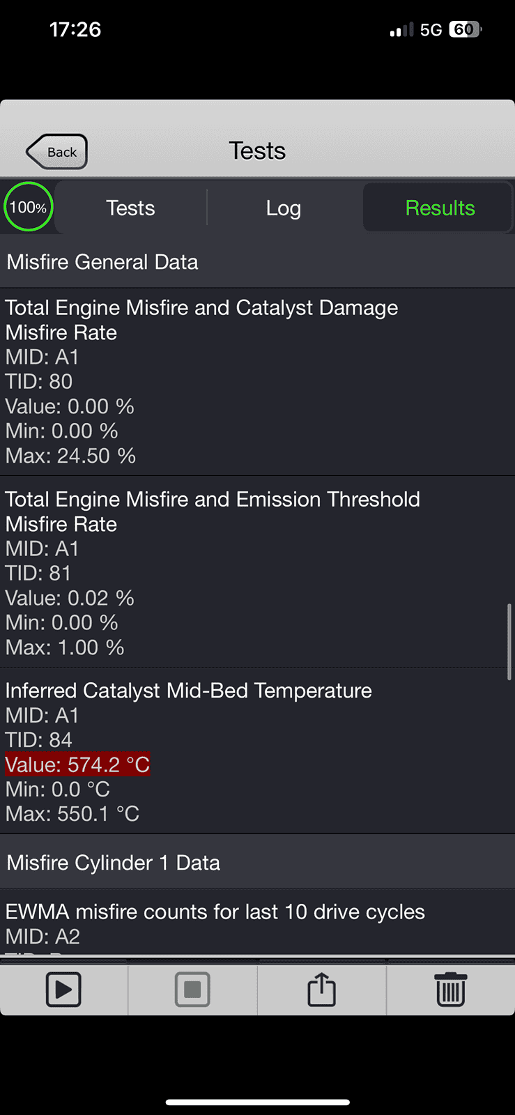

Browsing some live data, I found this….
Can anyone make any sense of this and give me some direction please? It’s been 9 months since my original issue and I’m losing the plot :(

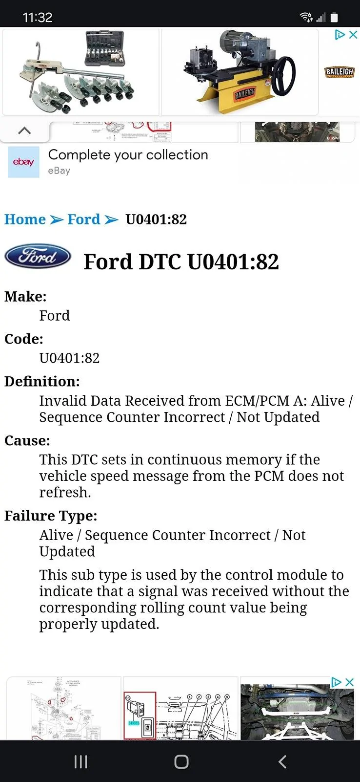

This is from kbb
https://www.kbb.com/obd-ii/u0401/

This is from kbb

The b1446 have you checked for a broken wire or connector? Is it wet inside the light or connector? I'd check all my light connectors if you haven't. Maybe leave them unplugged to see if it's causing a weird problem with the electric system
B1446:15 Front Park Lamps Output: Circuit Short To Battery or Open A continuous memory and on-demand DTC that sets when the BCM detects an open from the front parking lamp output circuit.

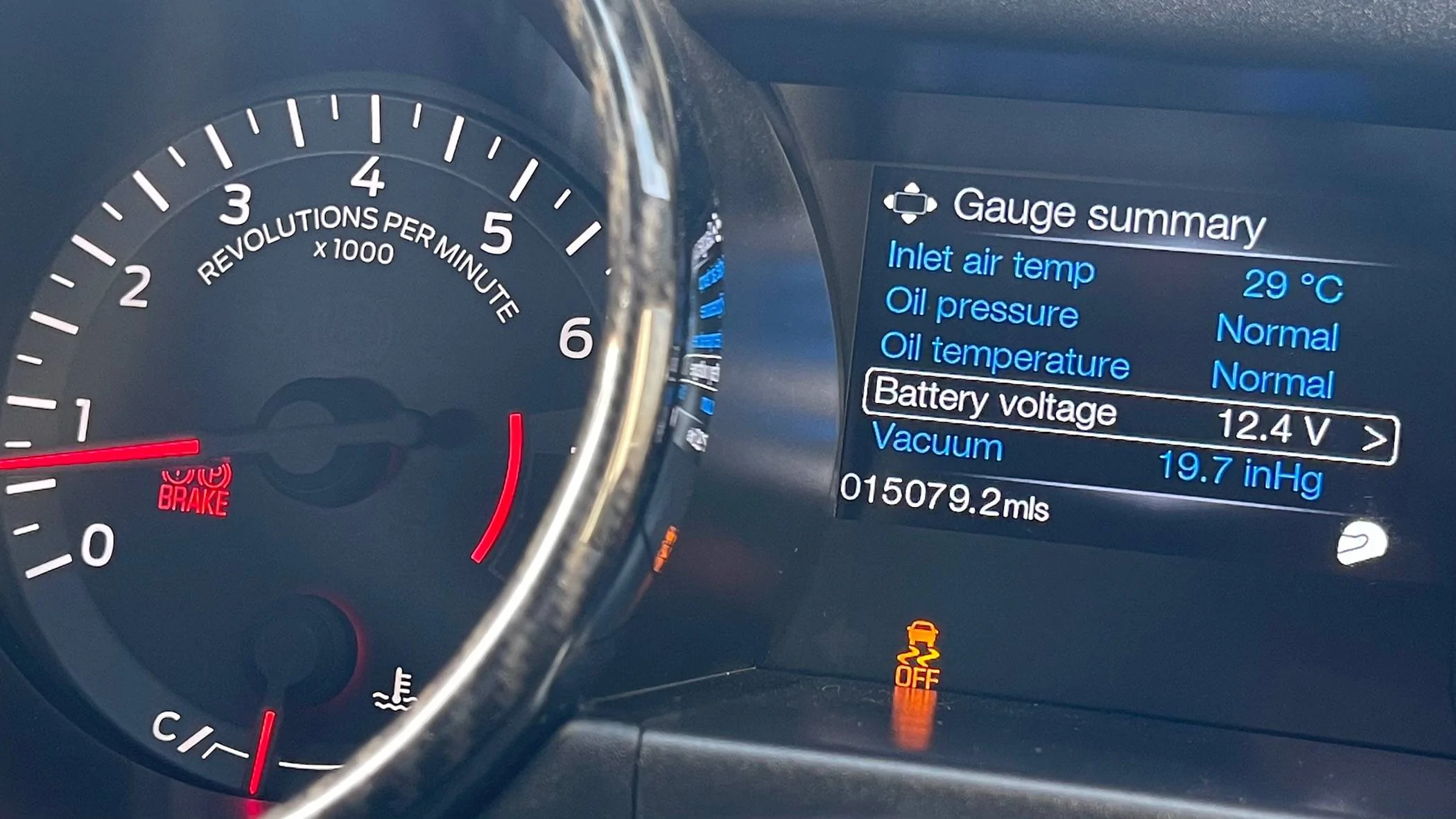

Ok, I’m assuming this voltage fluctuation isn’t right? On the numerical screen I saw it as high as 14.5v off throttle and 12.5v on.
Idling went down to 12.3v

Shouldn't be that low. 14s at least
