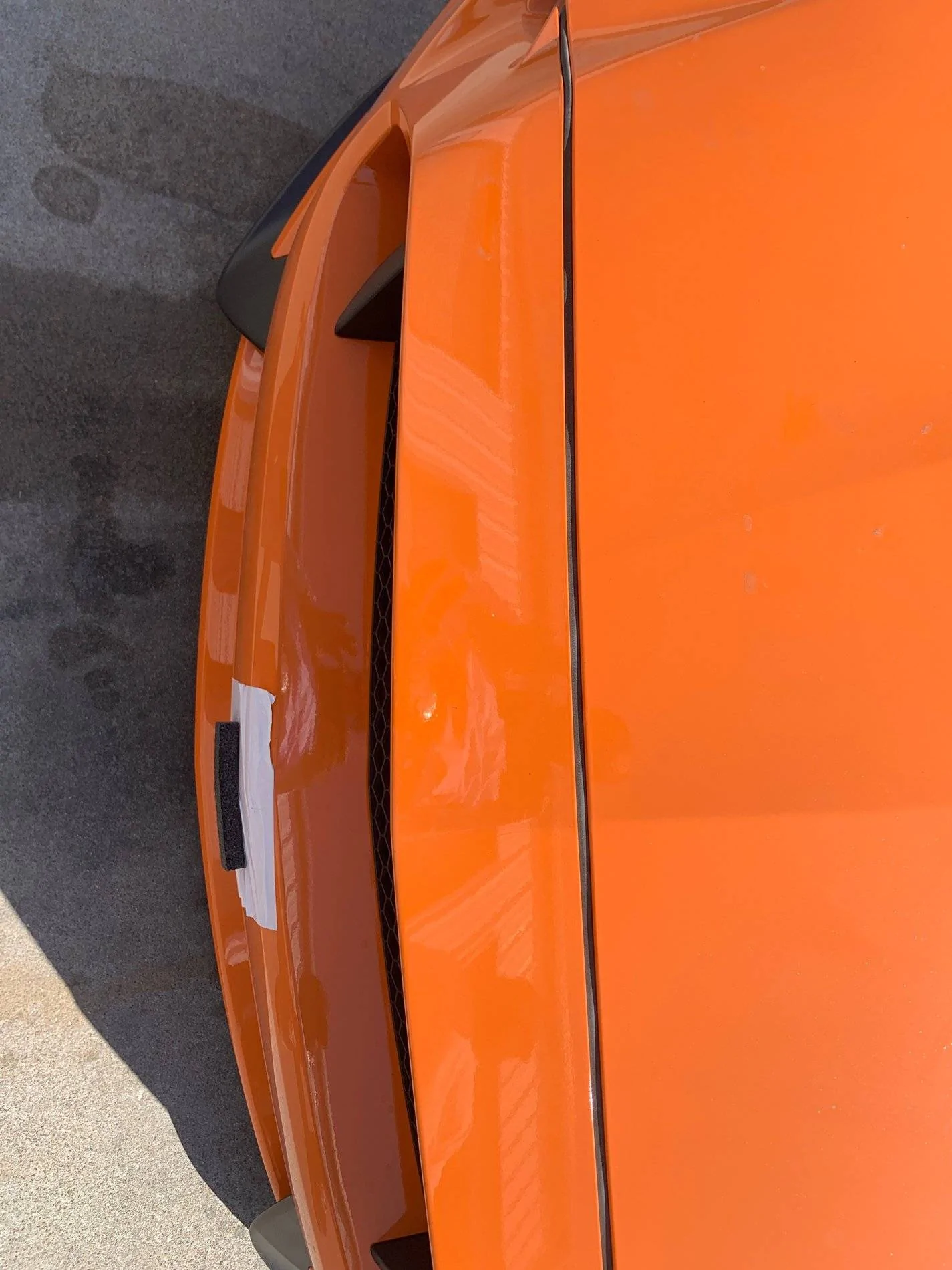

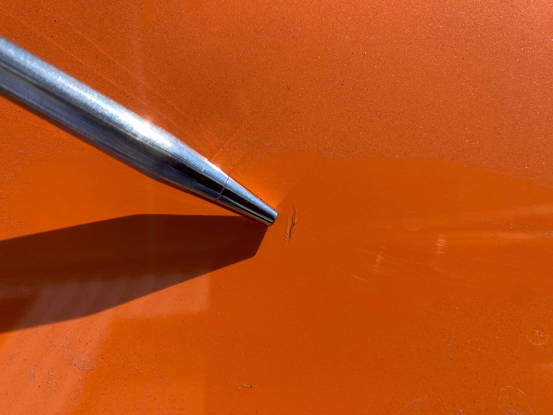

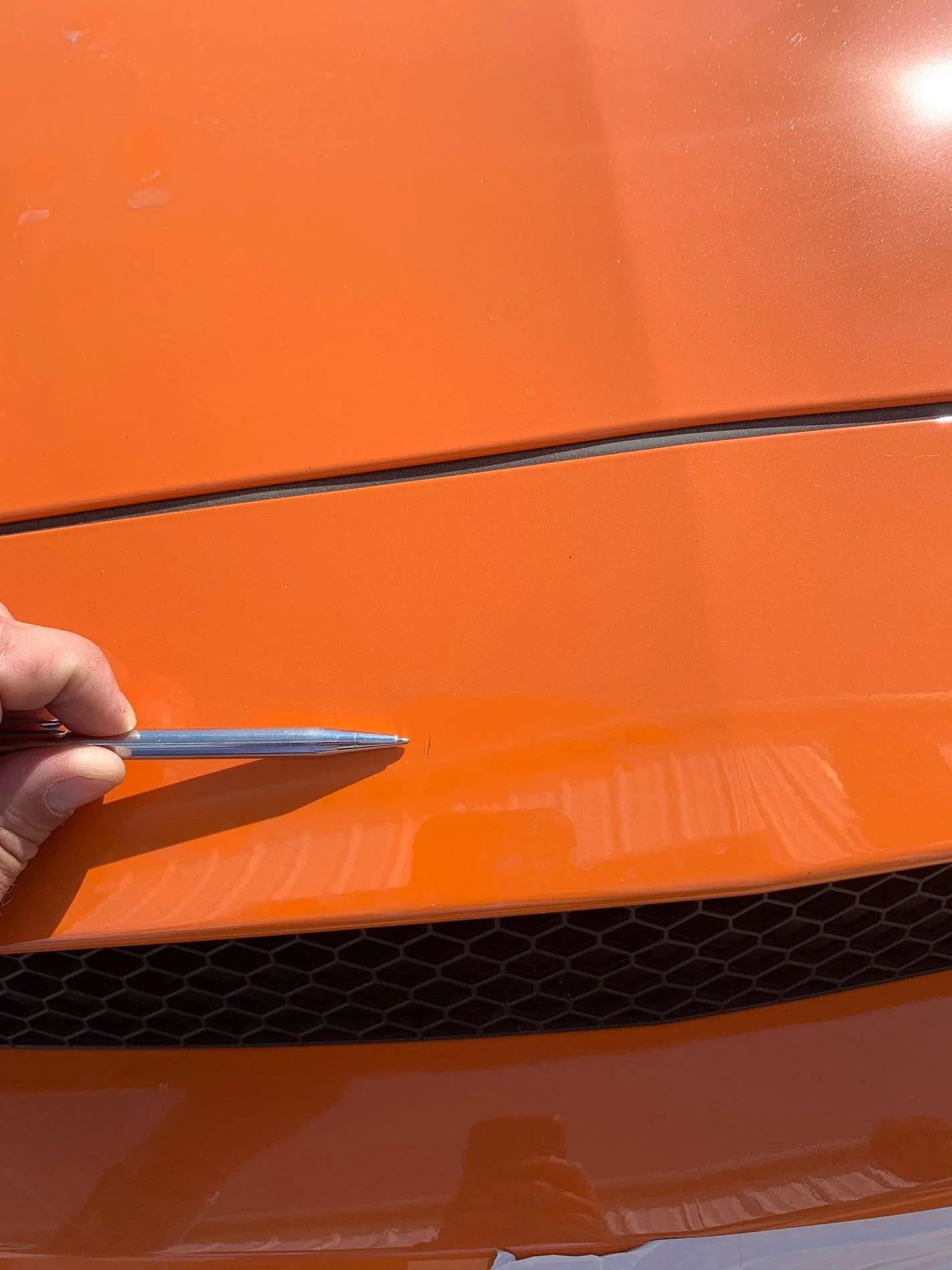

Any recommendations on this? I'm not to keen on having a new car
repainted. It appears that something hit the front fascia, while the
paint was still wet.

That can be touched up and blended fairly easily. And while I'm not a big fan of wrapping an entire car, wrapping the front fascia may be a worthy consideration.

Thanks. Wrapping the front fascia is not a bad idea, especially since I'm not
a big fan of PPF. I suppose a partial wrap, could serve in a way as a form of
PPF?
For Ford to charge $495 for TO paint, and then use the Ray Charles visual quality
control method, to me is slightly egregious. Nothing surprises me, we cannot
expect Porsche Quality at Ford pricing.

Could have very well occurred anywhere between the factory and when you took ownership of the car.................................................................................................................................................................................................

I would go back to dealer where you purchased this car and ask them to fix it.
Absolutely, I agree.
Touch up happens all the time on new cars, some are just better at it than others.
I have something similar on the rear bumper below the left side tail light. I knew the cure was worse than the damage so I’m living with it. If it was on the hood, I’m not sure I’d feel the same.
Edit...Now when I zoom in I can see why you think it happened while the paint was curing. Those ripples don’t happen with cured paint, chips happen. That should have never made it past the quality check, Ford or not.
