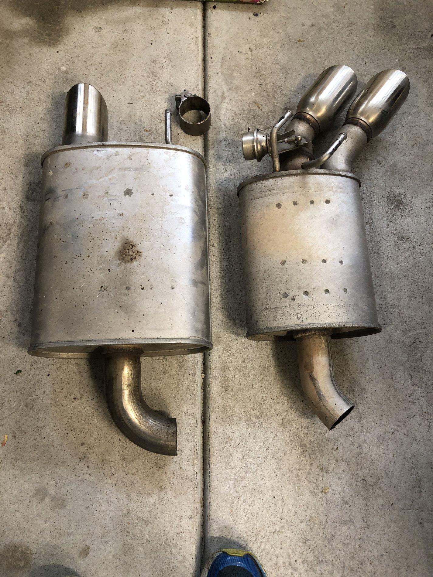

So while it just sits there I have decided to do surgery on the exhaust! Going to be Frankensteining some Chebby active mufflers into it. ZL1 Camaro quads. Picked some up for hellas cheap on the facespace.

Damn these mufflers sound good! Need to get a sound clip uploaded to youtube or something to be able to post.
