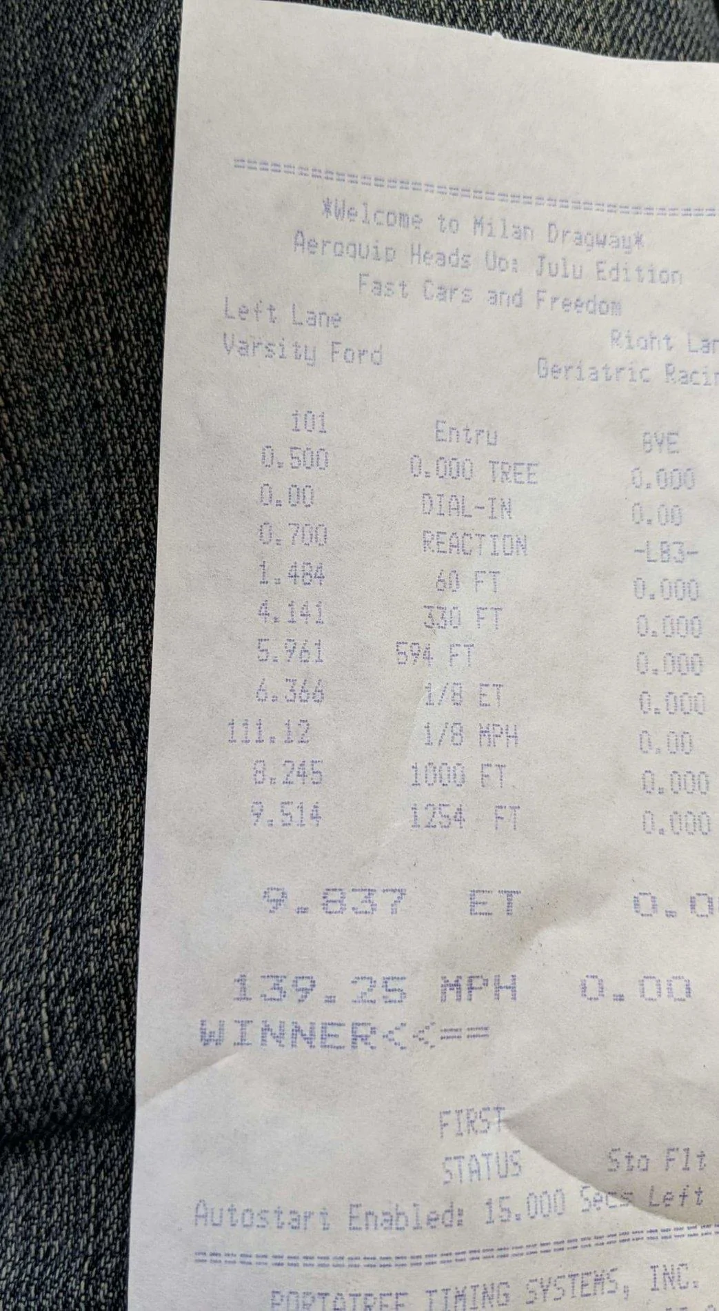

Made it to the track Wednesday.
First pass [email protected]
Second pass [email protected]
Spun pass three, 1900 and quick stab of the pedal.
Forth pass [email protected]
So 1600 and a half Mississippi on the flooring.
1.48, 1.48, 1.60, blazing the tires and 1.48.
Notes on current tune, kissing limiter in 1-2, hitting limiter on 2-3(my fault) I logged 2-3 from a roll and that's with the converter locked. At the track its not locked until after.
Prep was Wednesday night test and tune prep so it's not really good.
D1X, 4.88 pulley..4C, 3.55.

I presume gout back with tune adjustments these 9.83 passes could or would be 9.75 @140.
DA was 2200 or so and 82 degrees.

Strong passes! She's really moving!
