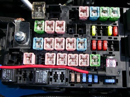

It's just a simple fuse tap in your fuse box. So when the ignition is on, the lights go on.
So a fuse tap means putting an extra fuse in the fuse box with a wiring that requires to be soldered onto wire coming out of the ballast? :headbonk:
It'll just look like this. No soldering.
You can always take it to an auto electrician of you're not comfortable attaching a wire into the fusebox :D
Id be able to do that haha......why didn't you just say that :lol:
