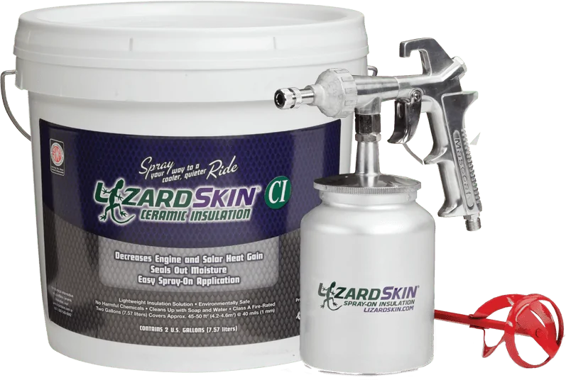

Anyways - I'm looking to minimize the heat inside the cabin. I would preferably like to remedy the solution without dropping the transmission but I can do so if absolutely necessary. Any thoughts or opinions on the subject would be greatly appreciated.
This is the best I know of. You will have to pull the console and carpet. Stay away from dynamat etc.. that type is a great sound insulator but not so good for heat.
On my 63 Corvette restoration, before installing the dash and interior. I sprayed the whole floor, inside firewall and rear bulkhead with it. Amazing stuff.
https://lizardskin.com/
