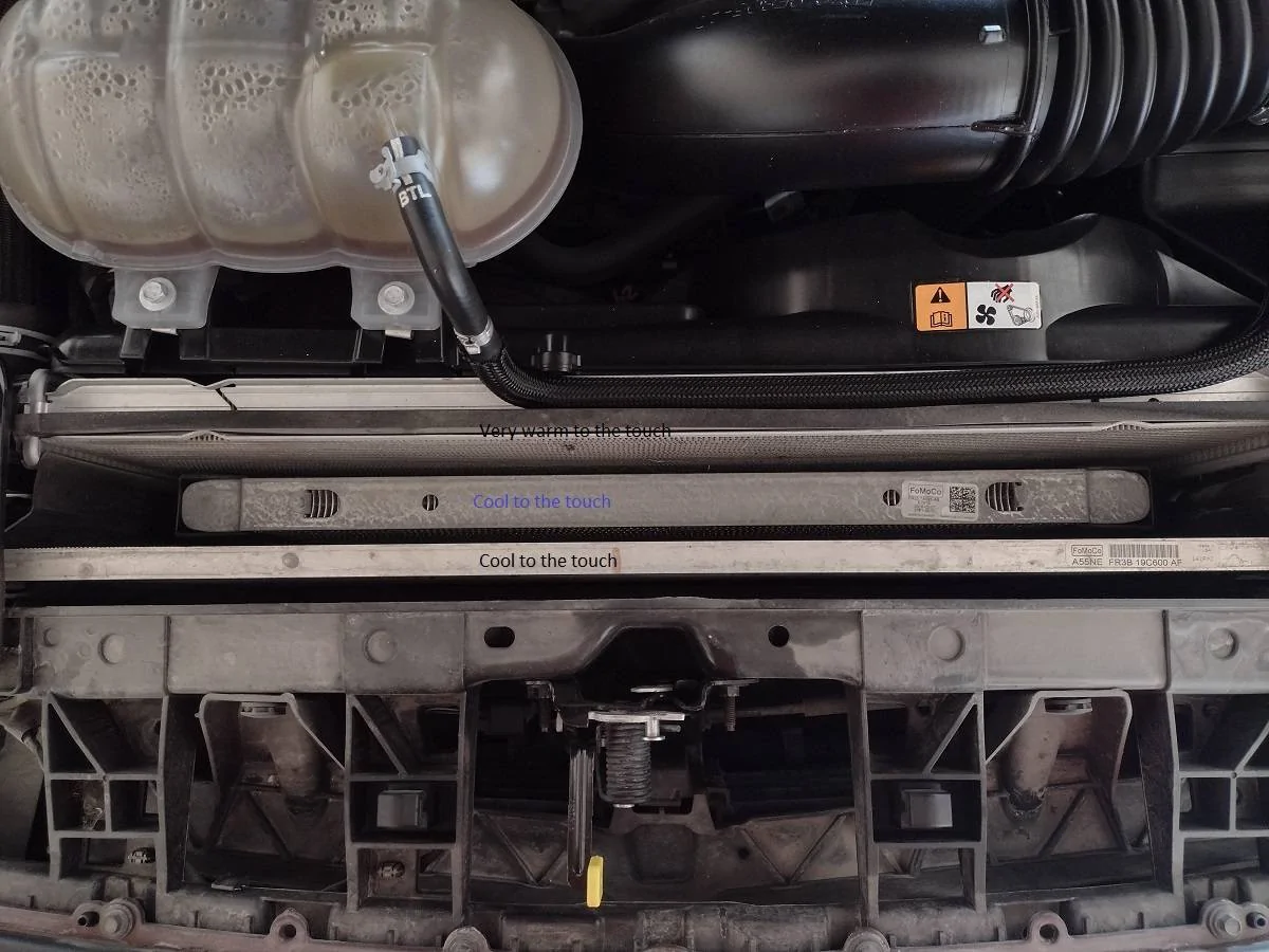

My discovery 10 minutes later: I took off the radiator shroud, and just started feeling around. The cooler in the middle is STONE cold on its top, and as far down as I can stick my fingers. Shouldn't this thing be burning hot?
I was assuming that this transmission may be one of the units that made it out of the factory underfilled, but I'm now also wondering why the transmission cooler wouldn't be even a little warm, if its full of overheated fluid. Thermostat not working?
