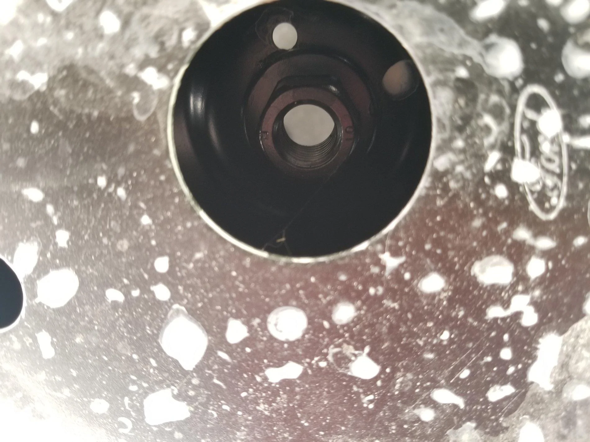

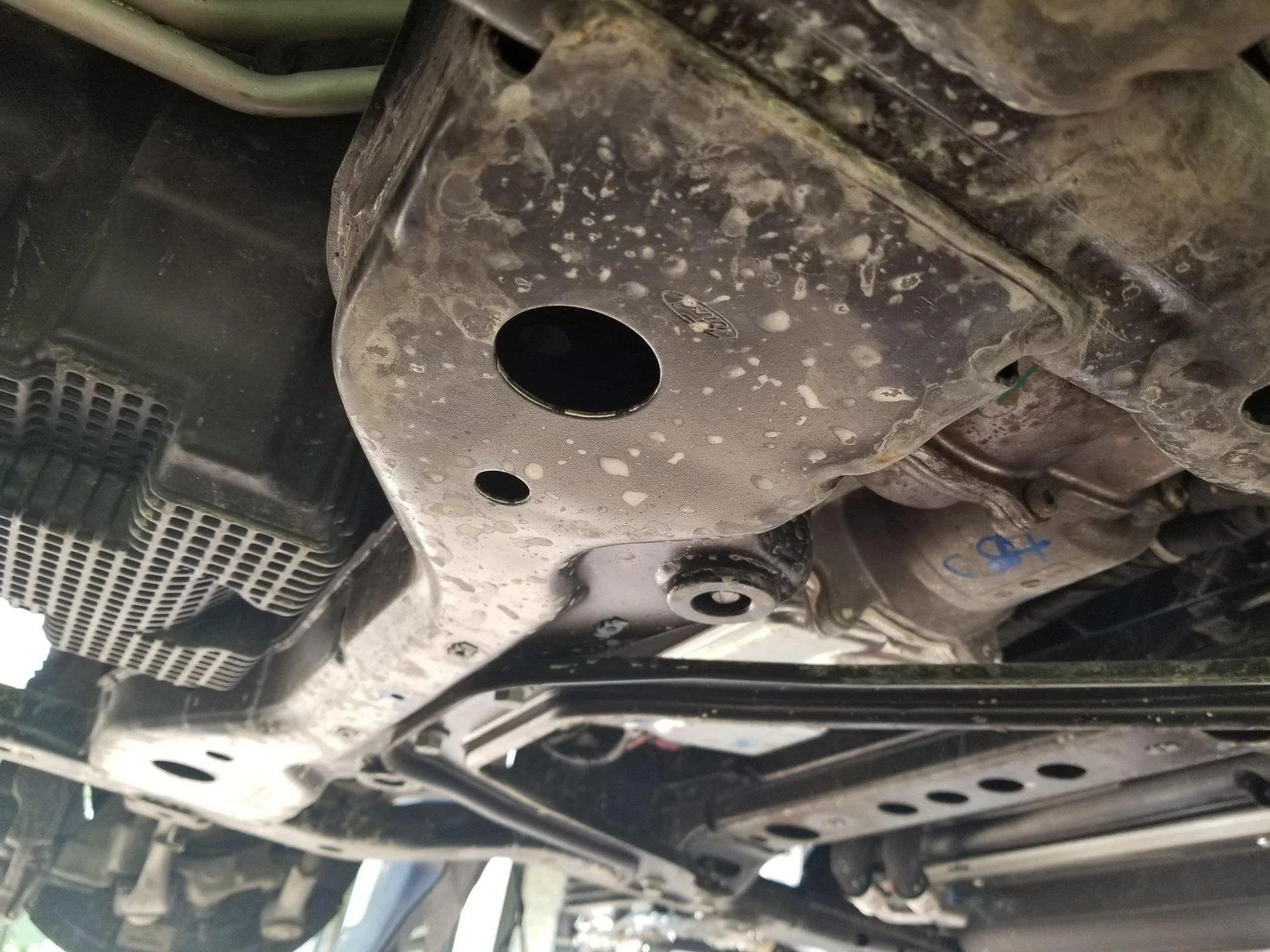

Any reason it can't go here? There's a cavern on top of the engine cradle and I don't see any interference. It also has a threaded hole to mount it on. What option would mount to that nut or is that part of assembly line tooling?

The location should be the best balance for hoses and wiring, whatever works for you.

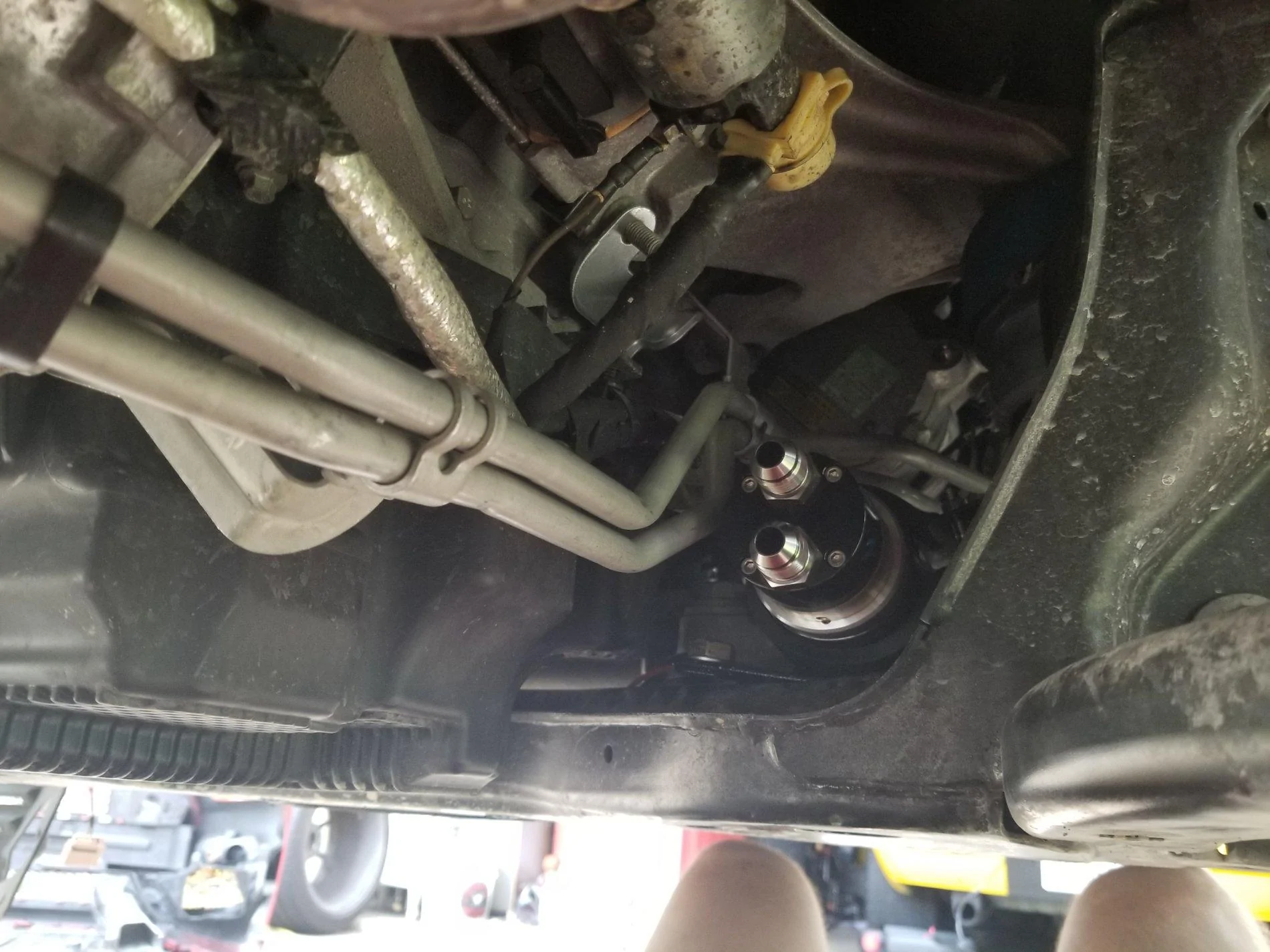

I mounted my pump under the spare tire compartment between the cooler and differential.

Seems nice and we’ll protected. Not sure what pump you’re running but my only concerns are hoses/fittings packaging within that nook and if the electric motor in the pump will get stressed handling not only the heat from the trans fluid but also the ambient heat from the engine.
Mine is in the pass. fender behind the front wheel; the cavity that gets purged by the fender vent.
