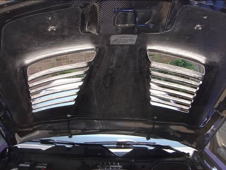

I do love the underside of the Tiger Racing hood

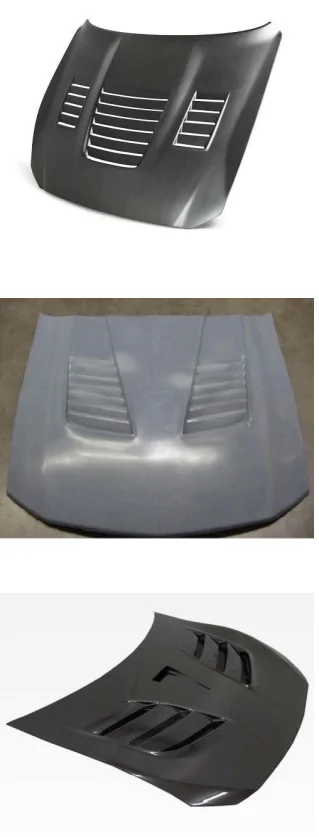

Race Louvers says these are the 3 best hoods:
