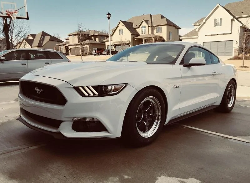

Member(KAR)posted that he bought Dill Air Metal Control Stems Part#VS-925-C and used his factory TPMS Sensors install on them. He informed me they would work on Weld Racing Wheels.Your Mustang looks great!

Best looking wheels on S550 I've seen. What sizes are you running? I've got to get something lighter than these PP wheels. I had Prostar XPs on my 03 Cobra but I definitely couldn't daily drive a set of polished wheels.
17x5 (28x6 tire) and 17x10 (305/45 DR)
