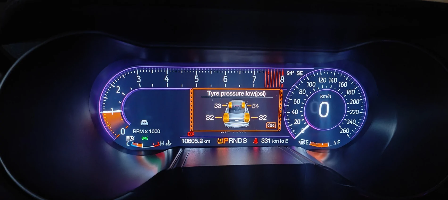

I am going to need a reset tool , i got issues and need a relearn . I have a low pressure warning while all my tyre pressures are ace and yes I've tried driving it I've driven it 400 kilometers . I've adjusted the tyre pressures god knows how many times .

Perhaps it's a 2018 plus thing my cars a 2017 and I didn't do anything. Hope you sort it out 👍

I take it you've tried pressing & holding the ok button to reset them after getting the pressures where you want them?

I put an aftermarket set of wheels on my 2017 around 3 months ago and used genuine Ford TPMS sensors. I bought a genuine Motorcraft reset tool off a place here in Australia called Autoware (autoware.com.au) for about $100.00 bucks as I had read about problems with resetting without the tool or cheap chinese copies of the tool.
The bloke at the tyre place said I should be right as I was using Ford OEM sensors and it should auto detect them.
They were ok for about 20km's then the warning light came on so when I got home, I followed the procedure to put it in training mode and then used the reset tool on each rim and haven't had a problem since. This was very easy to do and I was glad I had the tool onhand.
Just my experience anyway.
Fantastic just the information I was looking for . Thank you
