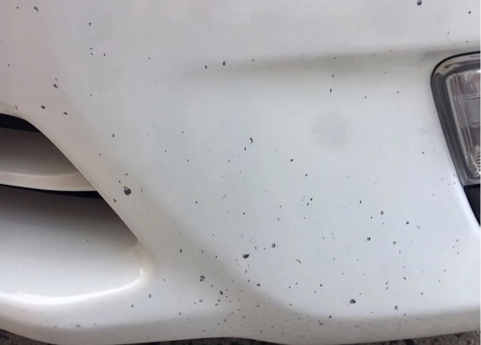

Okay I have a few chips in my Ruby red gt and I'd really like to make them invisible. I've narrowed it down to either Dr color chip or touch up direct. If any fellow members have experience with these touch up paints please post up the results you had. Especially any Ruby red owners.

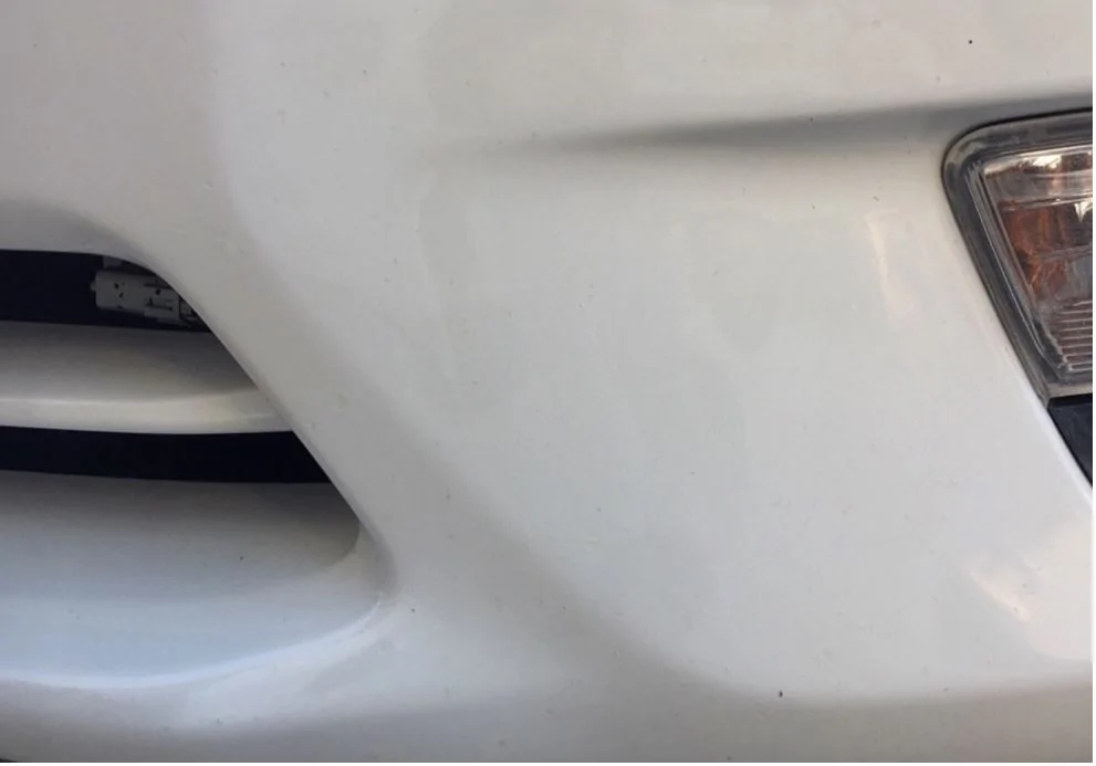

Mine has always lasted for years. I had a Z4 that I had to use a squeeze on (like shown above) and even that did a great job. Dr Colorchip does a great job on paint chips, harder to use on scratches, but even those are doable just takes longer. Just rub EASY when removing the excess.
