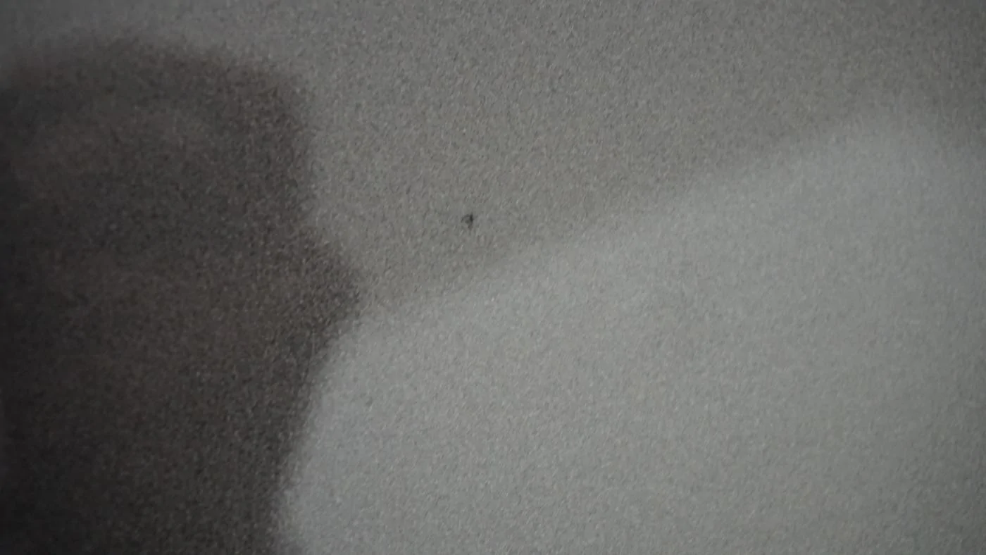

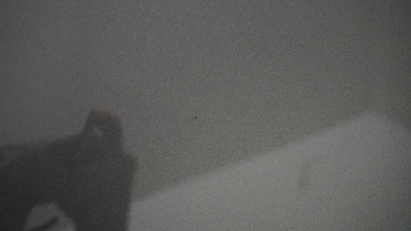

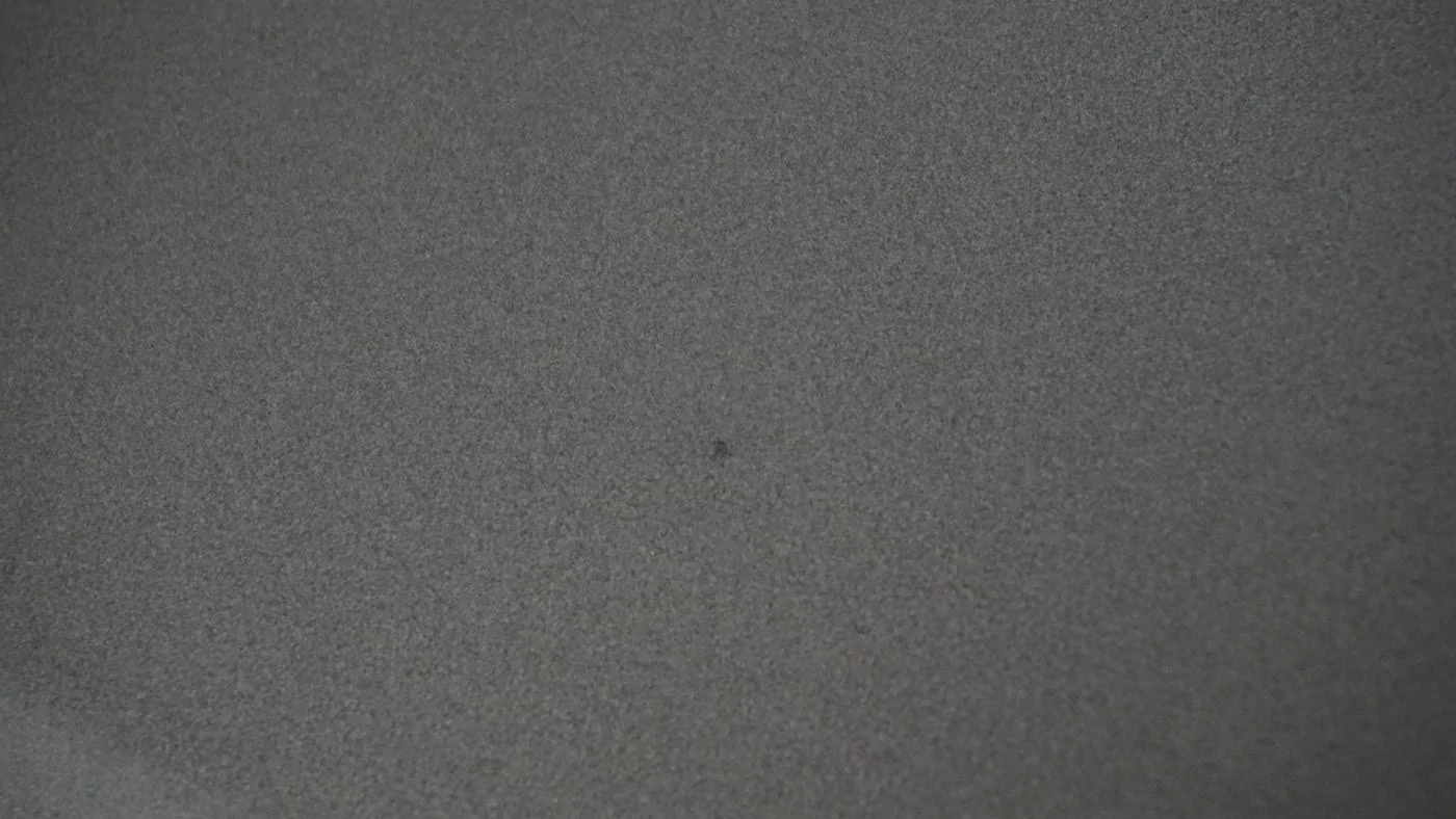

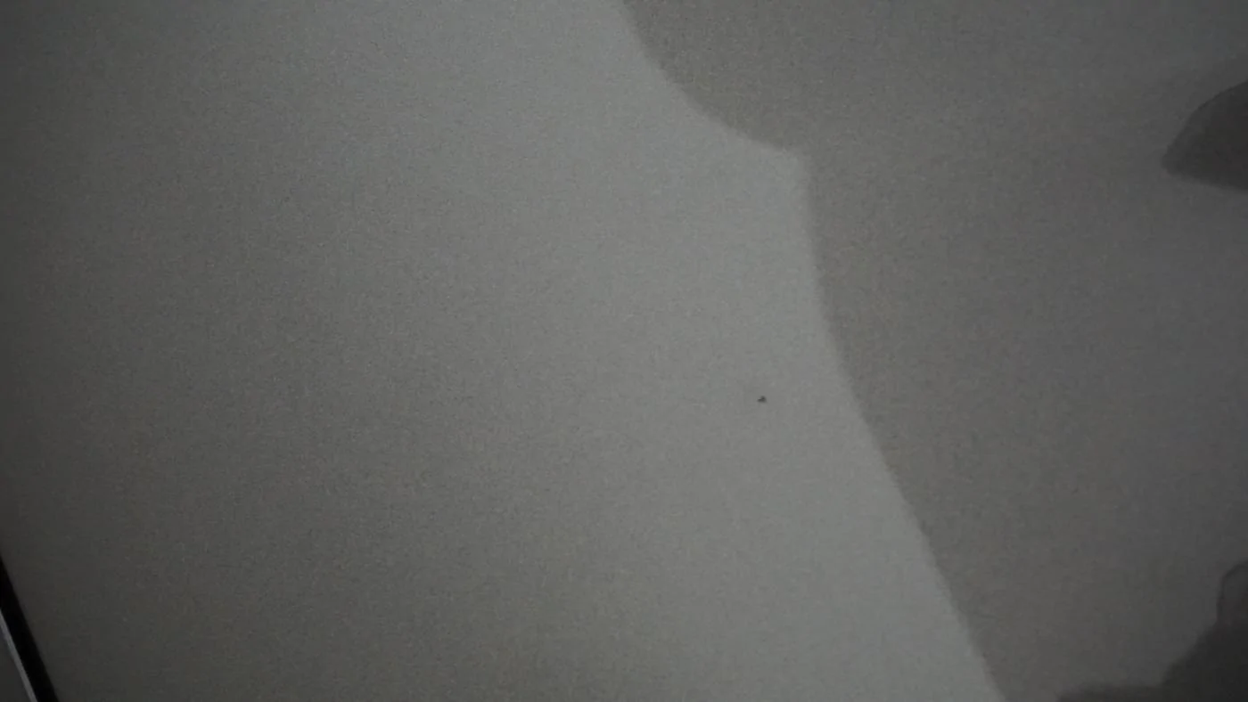

Ok, so I've just used Dr Colorchip (and thanks for everyone's advise on this), and I've attached the results. From the picture, it makes the blend look a little better (probably because of focus), but it's really a bit darker than the paint surrounding it (and same paint color code as my car).
Did I miss something about it going to take a lot longer for the color to blend in or something, or is this going to be the final result? The attached pictures are about 45 minutes after I applied the third coat. While it looks much better than a white chip, it almost looks like this went from a white chip to a dark grey chip and perhaps I just had higher expectations.
Blk2015GT
Jan 2, 2015
2,846
755
2015 GT
No. It's just a function of metallic paint. I had the same issue on my Vista Blue 2009 Mustang where the touchup spots were a bit darker. It's because the metallic paint has metal flake in it and the touchup isn't reflecting the light the same as the uniformly sprayed paint.
