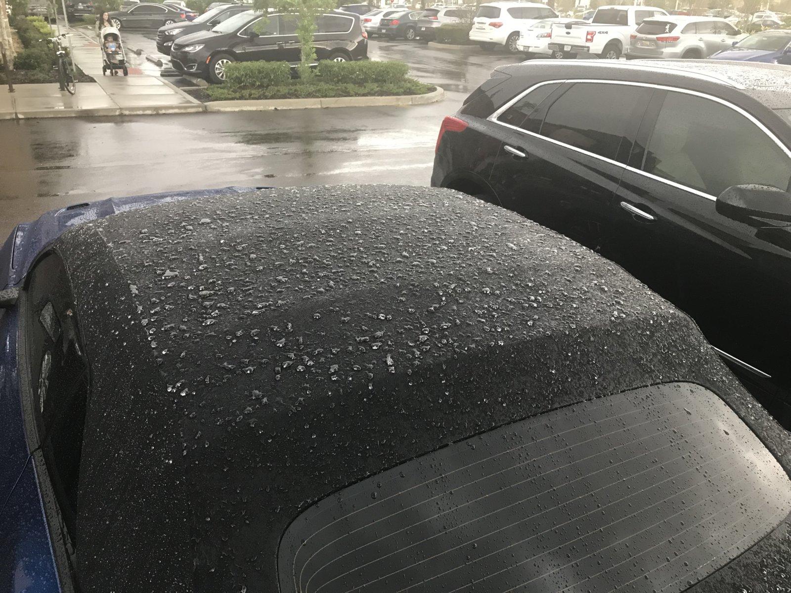

Top protected... rain water beads up nicely

Did the 303 cleaner and protectant. Rain water beads up nicely.

I did a treatment with 303 last weekend. Not particularly happy with the result, as only a portion of the top performs like the OP's picture, although I believe that it was my fault and I simply did not put enough product on the top. I think, however, that the next time I do it I am going to use a brush to apply it as I have seen in several Y-T videos, which I think gives you a better idea of how much you have put on.
I did a couple coats (enough to use the entire bottle). First coat was not enough. I then applied a 2nd coat and it works as the picture shows.

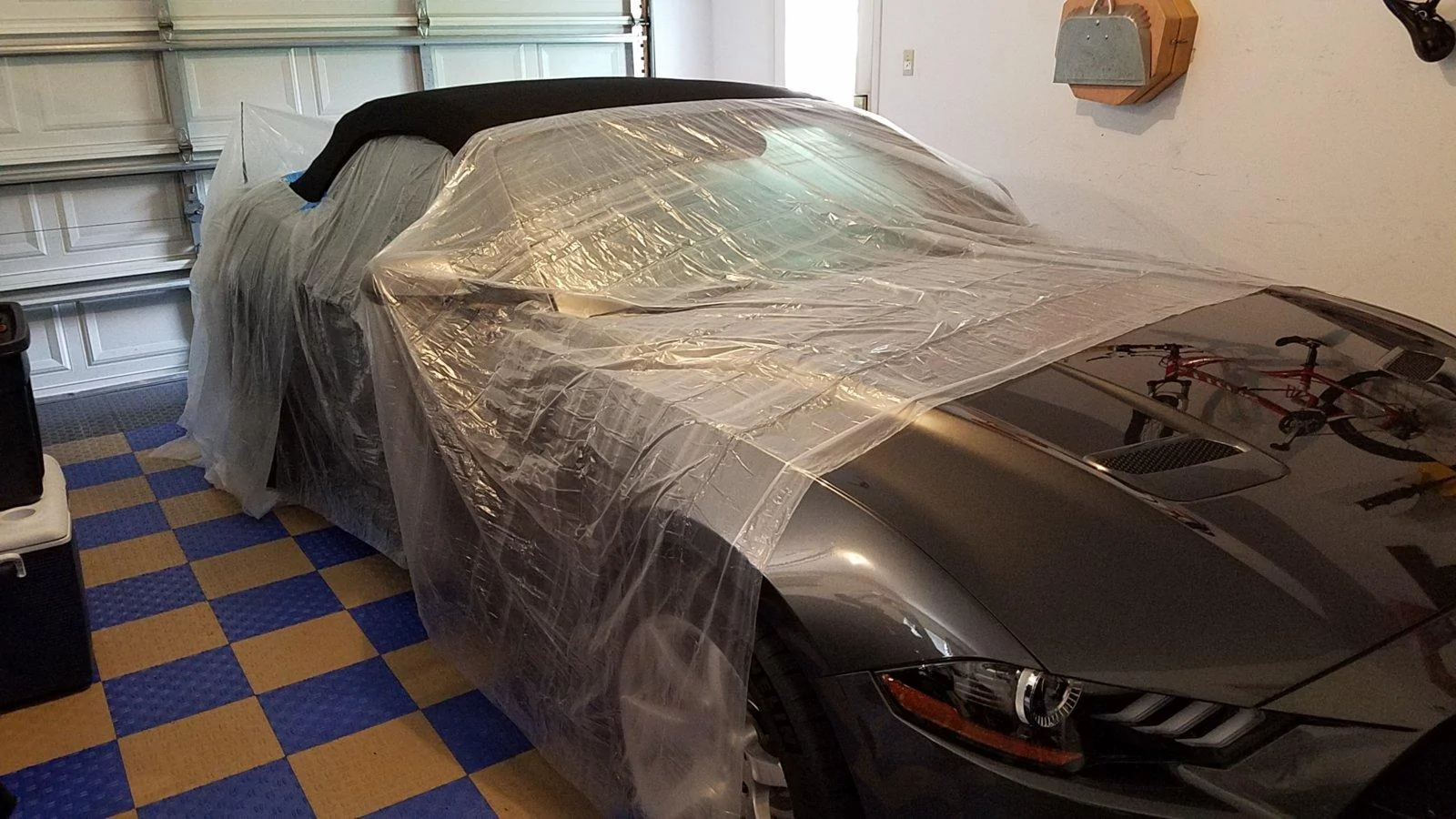

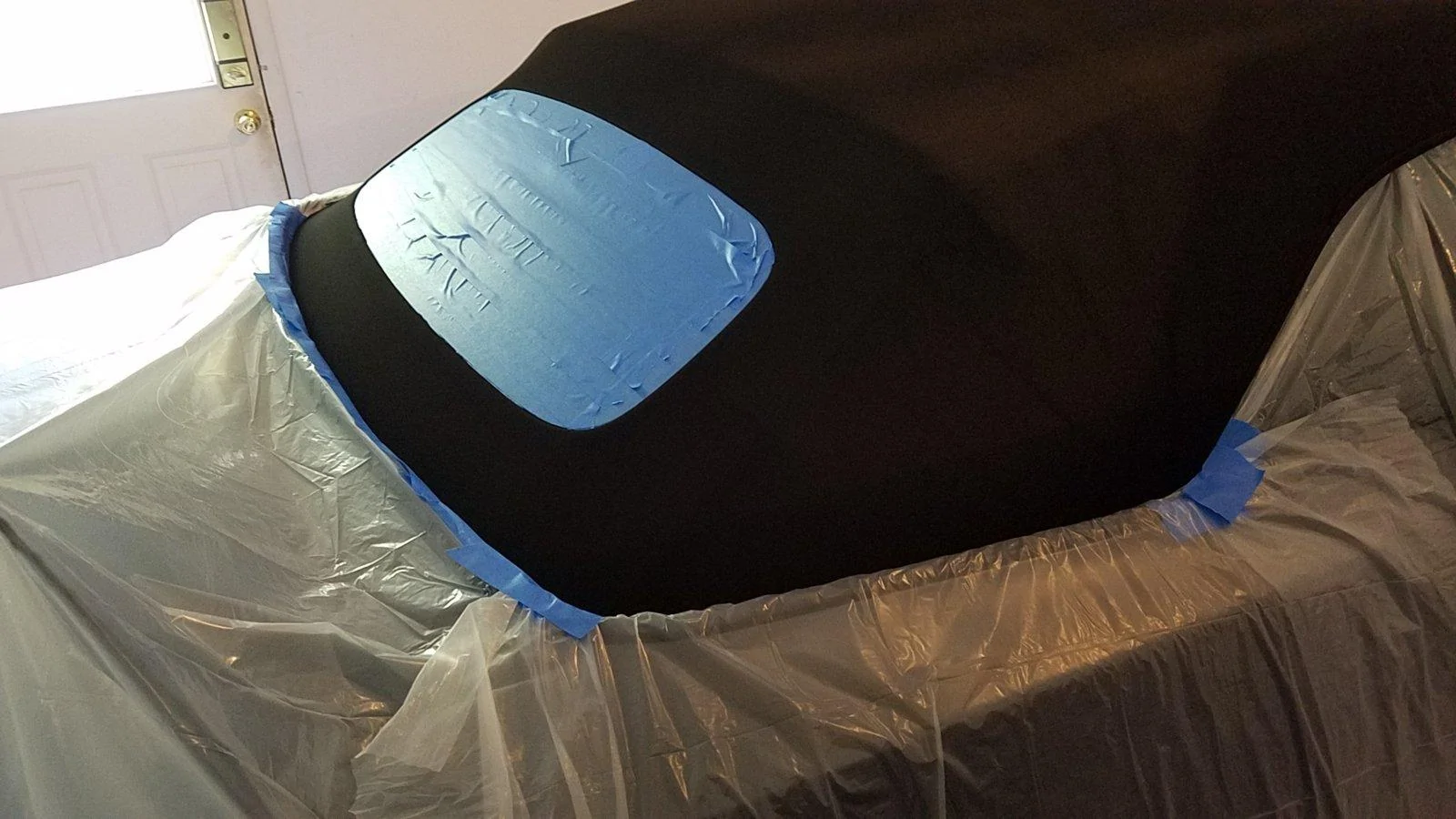

A couple of pictures of how I'm guarding against protectant overspray with about $5 worth of 1mm vinyl sheeting and medium tack painters tape. I've read many warnings about how hard it can be to remove once set.

@sdiver68 great idea. I went nuts with the spray and if it wasn't for my car being ceramic coated I don't think I would have gotten it off the paint.
