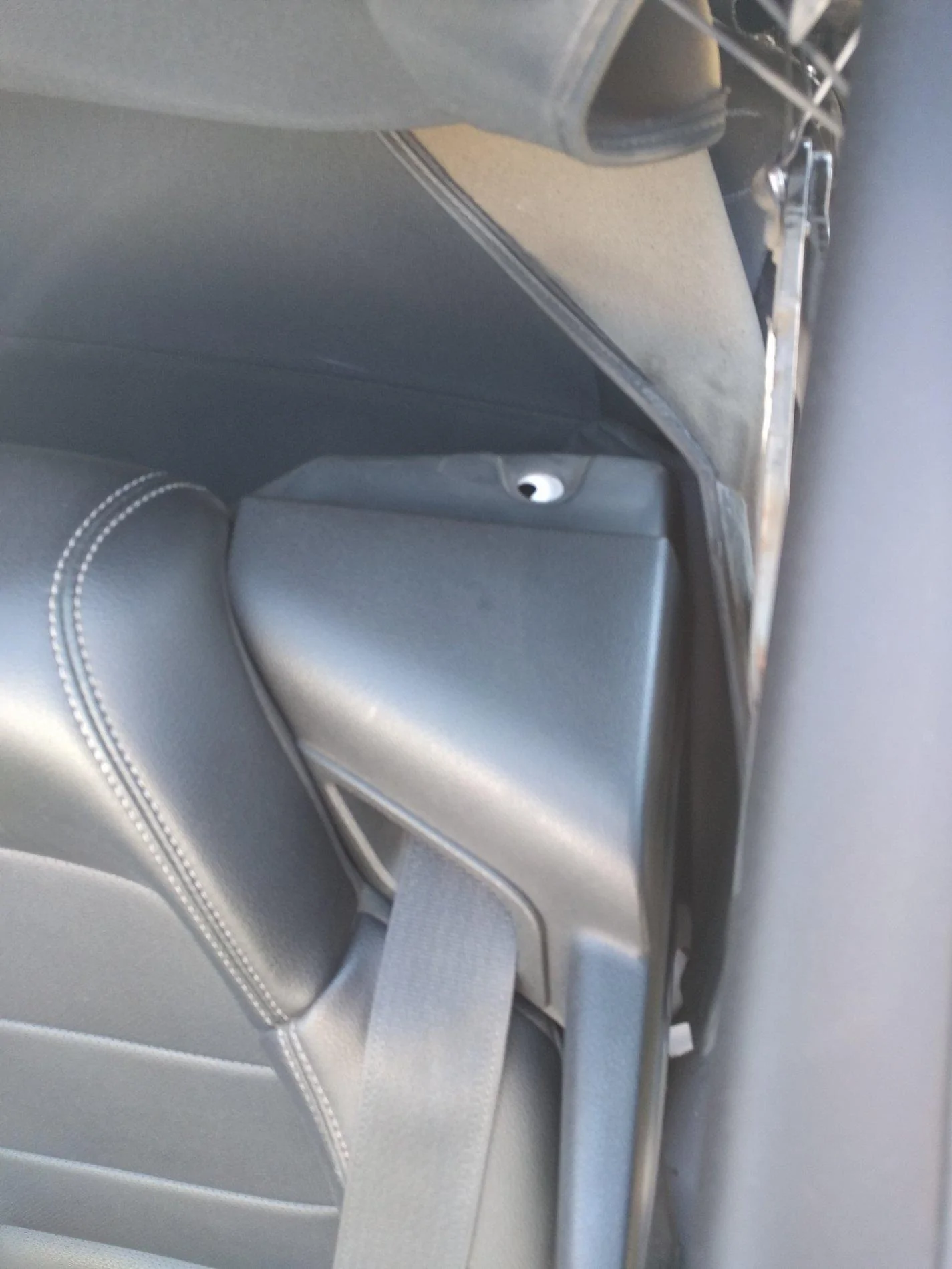

When the top is down it is sitting crooked. Driver's side rubber stop it rests on is missing. I have already been to the Ford dealer and they can't find it in their drawings. I tried to find it myself on parts.ford.com. I have an Oxford White 2015 Mustang GT Convertible. Could someone please help me locate a replacement rubber stop. Thanks

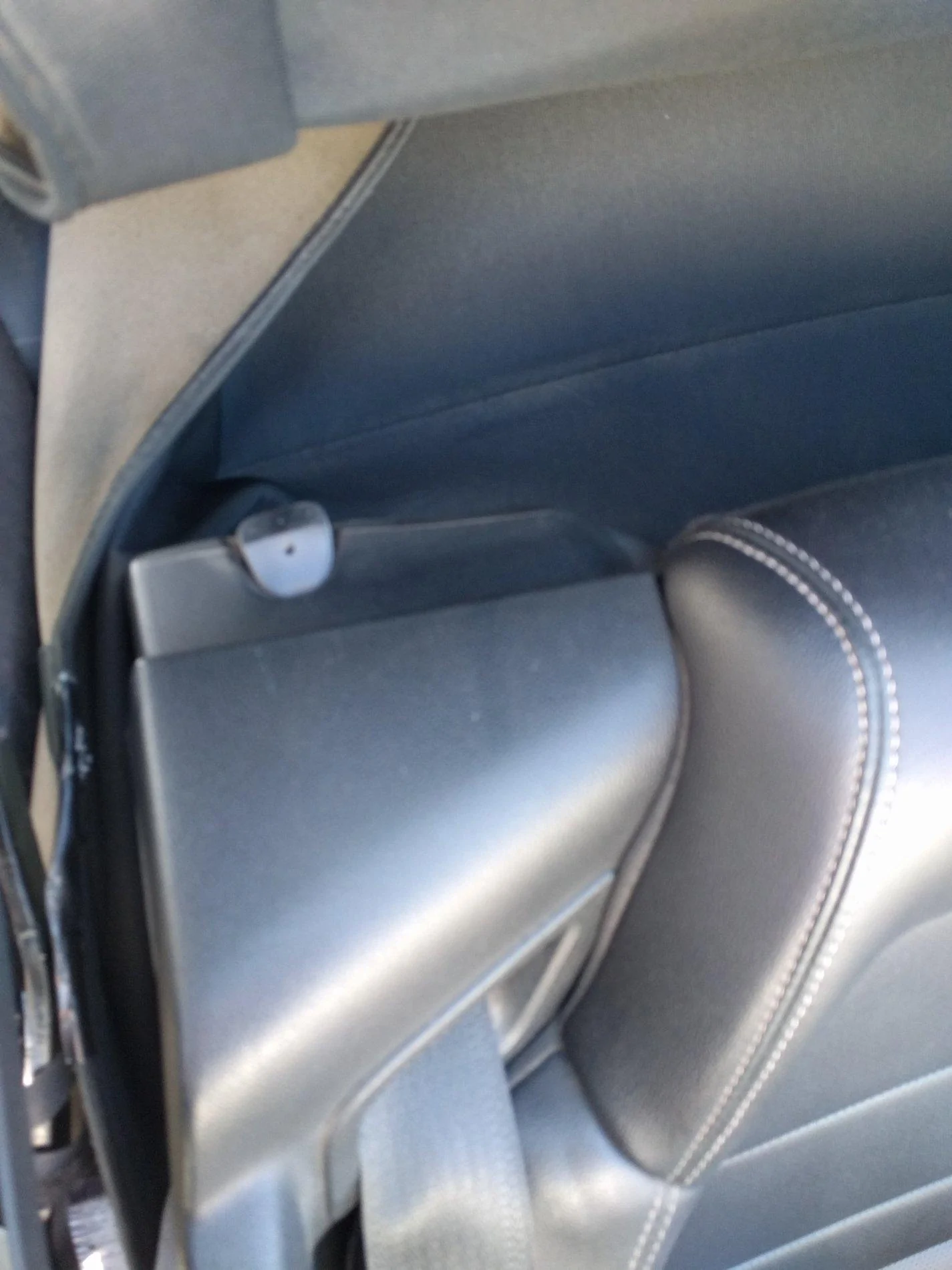

Send pix please.
Mine also sits a little crooked.

Thanks for the pix.
I have both items. I wonder if they are adjustable so that I can lower the one side.

I just checked and the one on the driver’s side is missing from mine too.

Crisis averted. Found the missing stop under the back seat. Found a puddle of water under the seat on the driver's side. Suggest everyone with a S550 vertible remove the rear seat and check for water.
