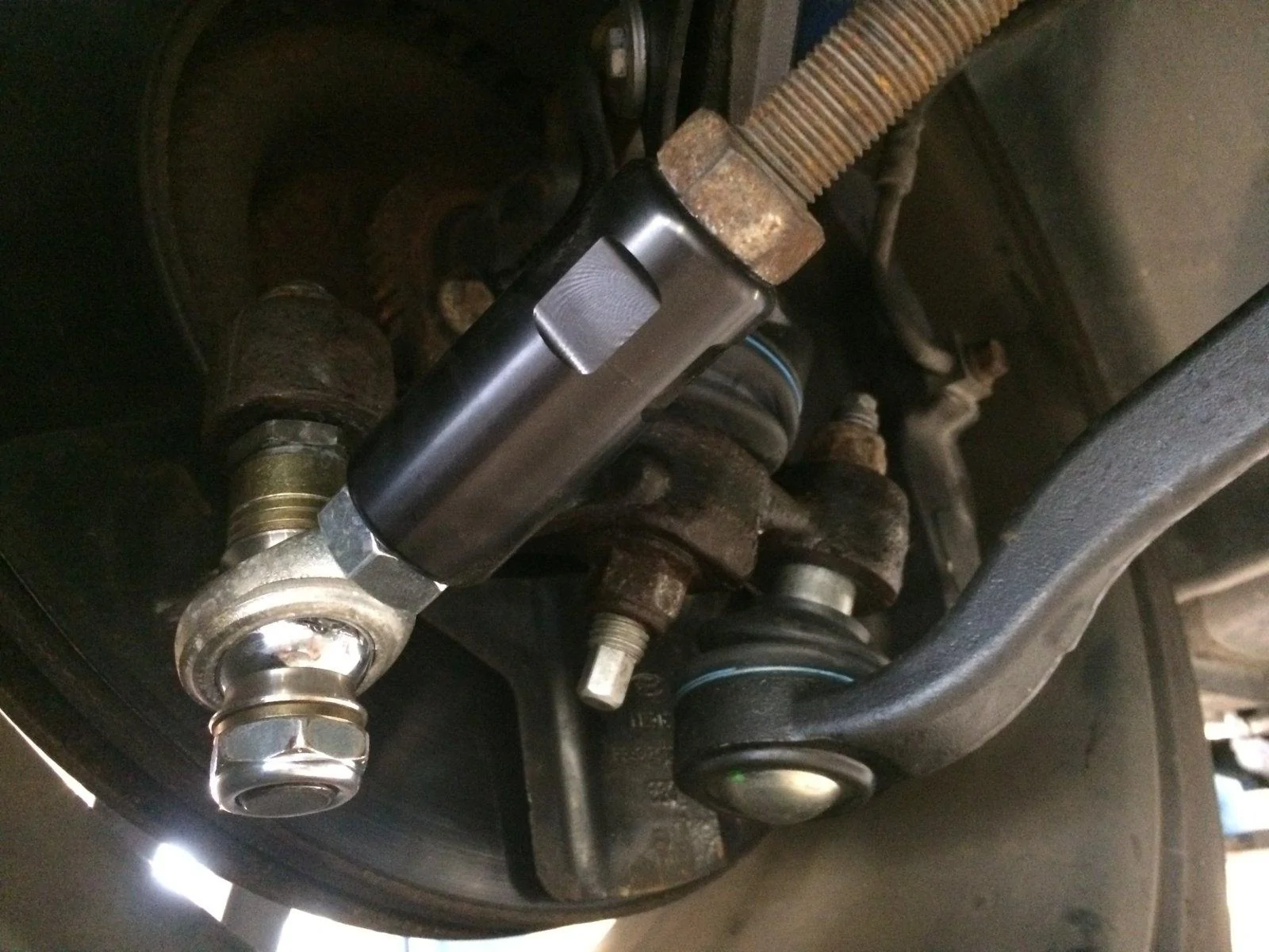

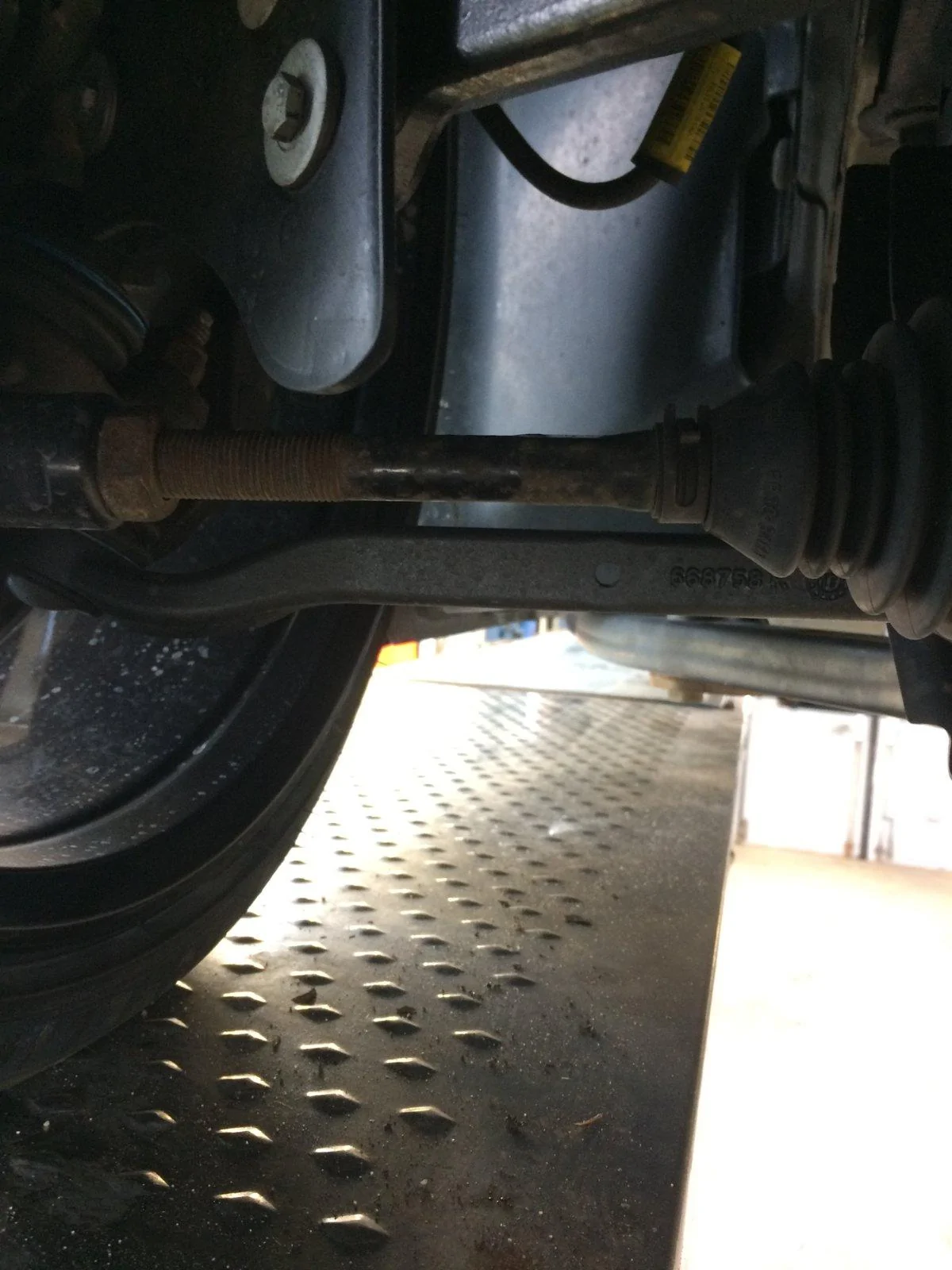

I was pretty surprised on the amount of toe-out too, even with the bumpsteer kit installed. Originally I had more of the bumpsteer "stack" closest to the bottom retaining nut, so I lifted the car back up and set the bumpsteer kit "stacks" to this:
Not only is the steering rack now parallel with the arm, but with only a very minor eyeball alignment I was able to get positive toe (albeit too much) of .20 front right/.16 on the front left. I think the key is in the washer stacks. Not much is needed to get things close enough until an alignment shop handles the rest.
