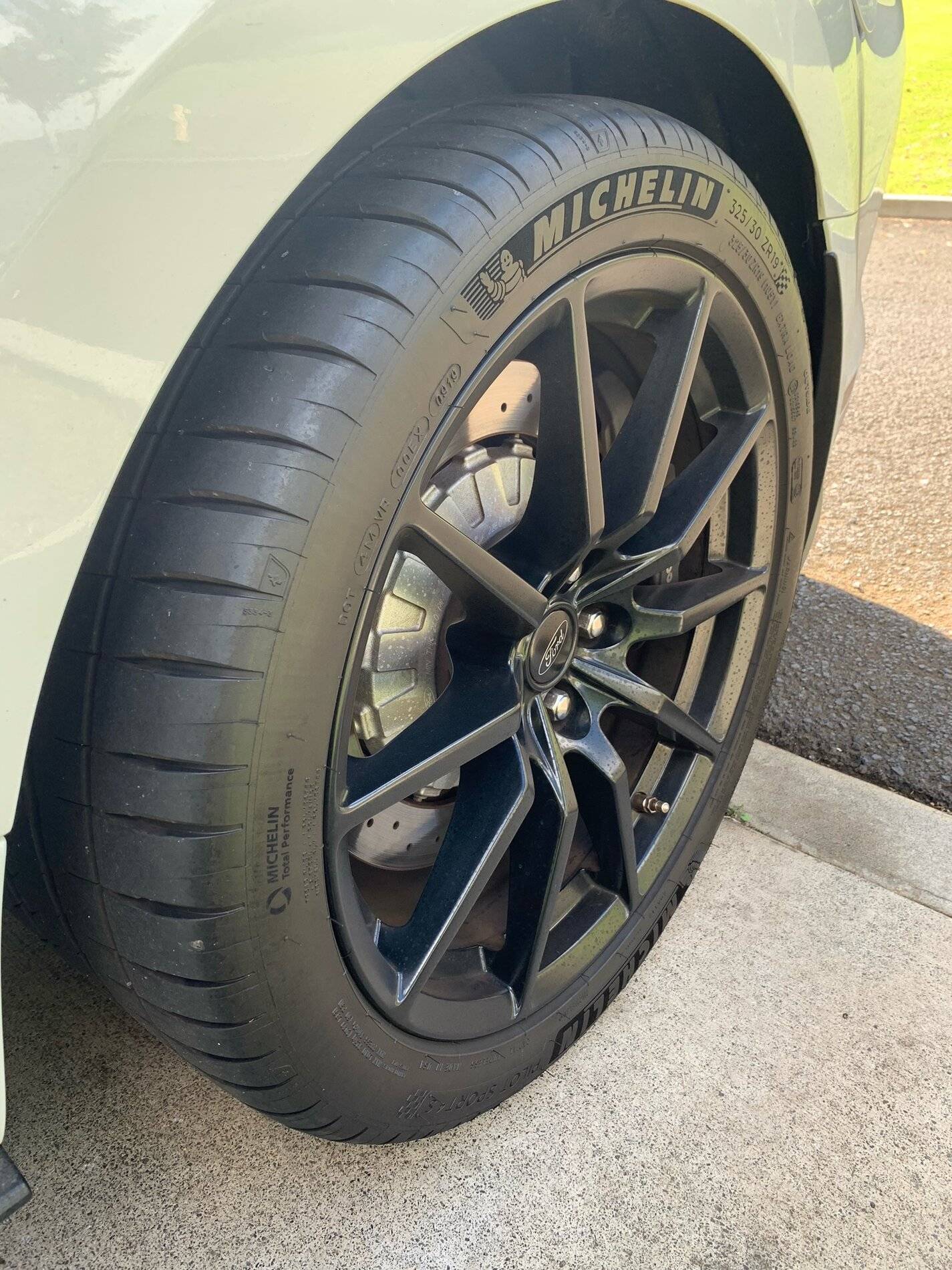

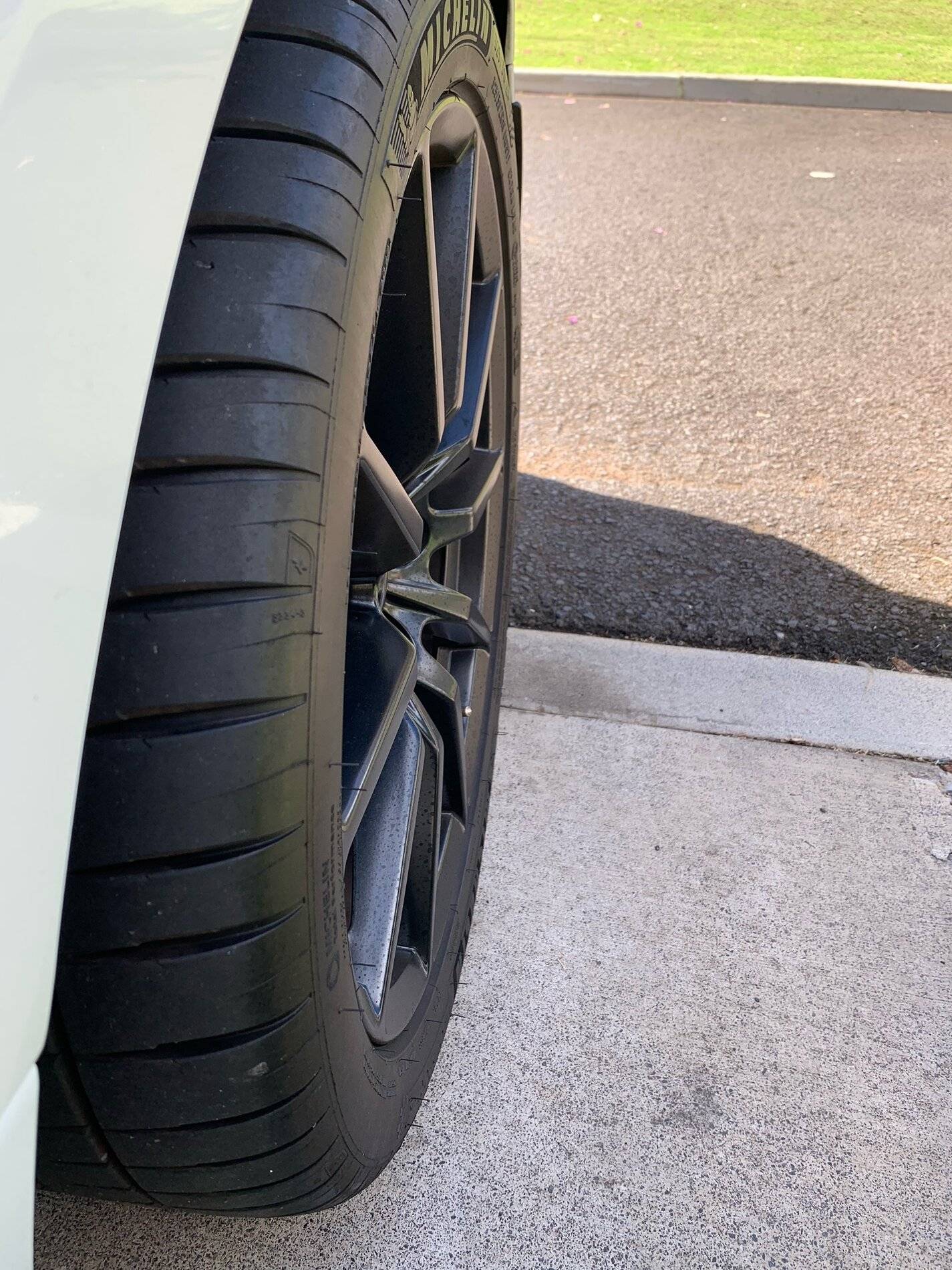

I will be running 305\30\19 in the front when they get worn. my rears are 325\30\19 on non R rim. you'll be fine
If it's not too much of a hassle can you take a photo of your wheel and tires. Would like to see how it looks on the stock rims. I might actually do this myself.
