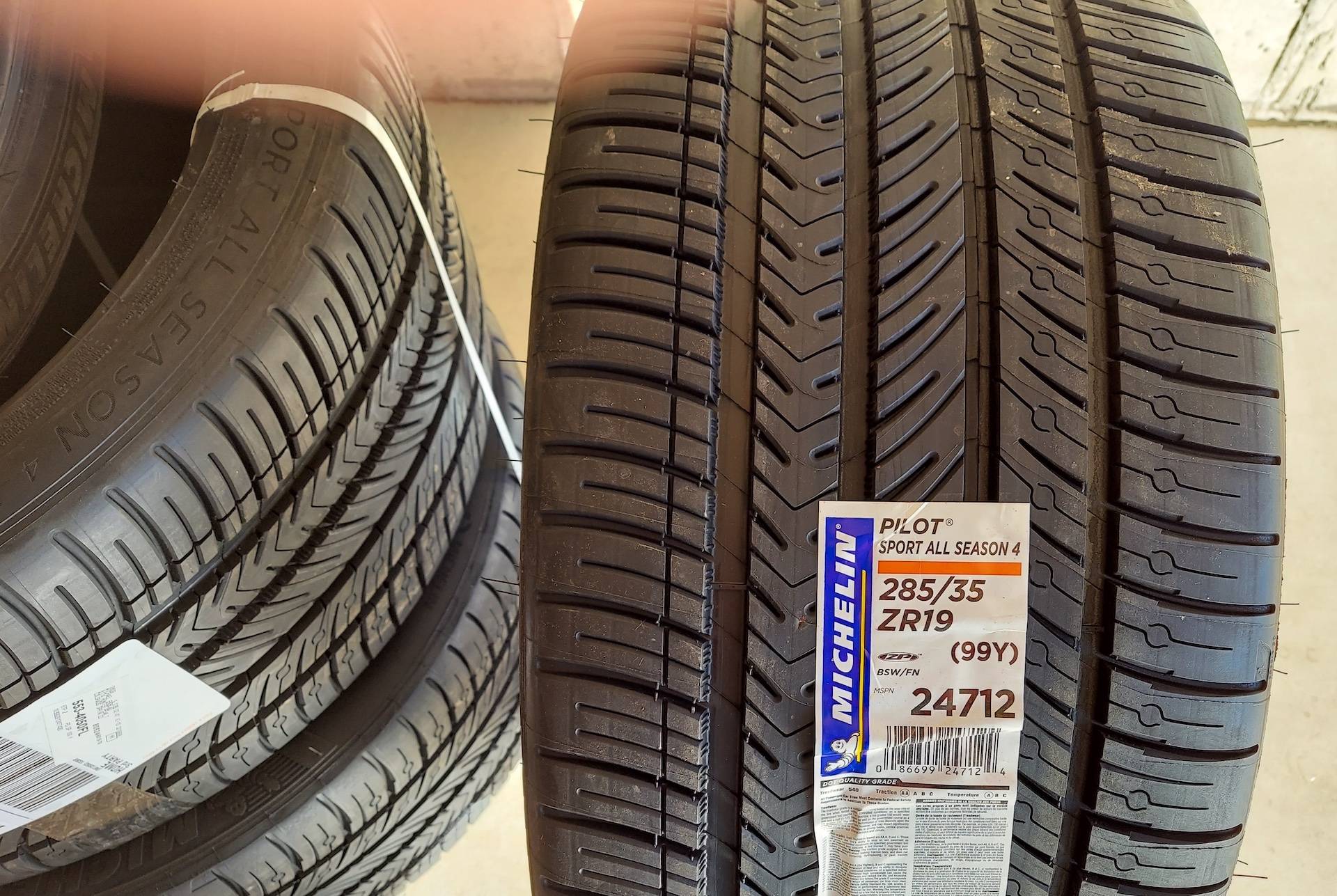

I've been using Michelin's A/S 4 tire on 19x10s for two seasons now, to include driving in weather near 32 F / 0 C. I've always gotten great traction, in both hot and cold temps. The tires get great reviews. One to consider as an A/S.
https://www.michelinman.com/auto/tires/michelin-pilot-sport-all-season-4

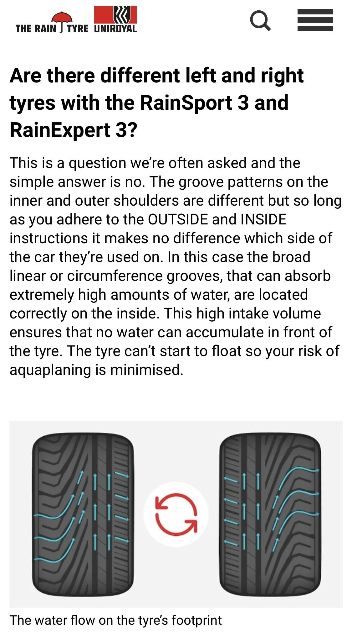

An asymmetrical tread. The tires are marked "outside" and "inside". See a supporting Uniroyal infographic below, provided by @WD Pro previously.
