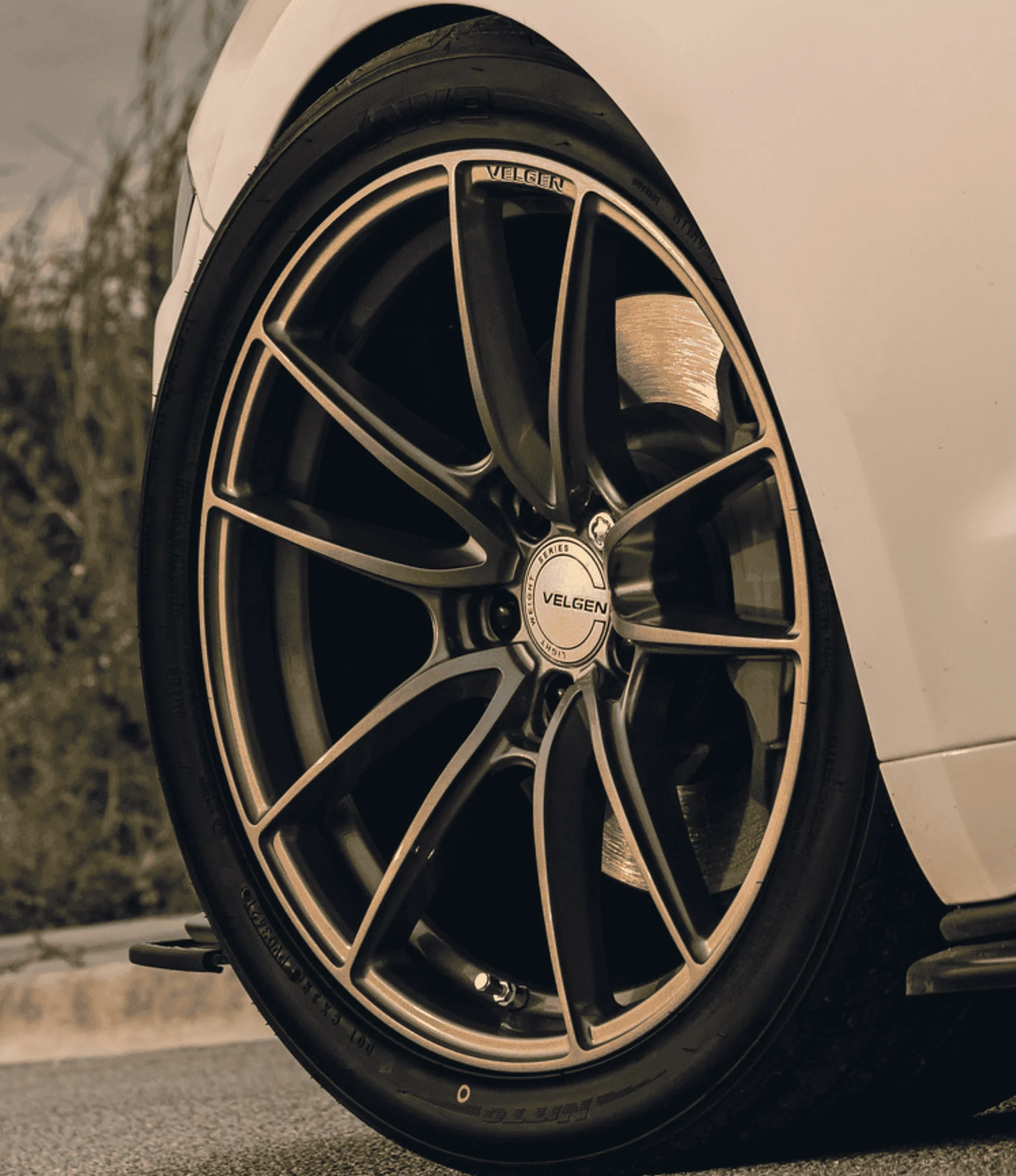

You shouldn't have a problem at all. What tire brand are you running ? the right tire should be protecting the wheel like the images below. this is a 19x10 with a 285-35-19 and lowered

Thanks for your help, greatly appreciate it!!! I didnt buy new tires yet, but def will be soon.. Is there any that you would recommend? 285/35/19's. I'm looking for an all season, def not pirelli since i have them already and they suck.
