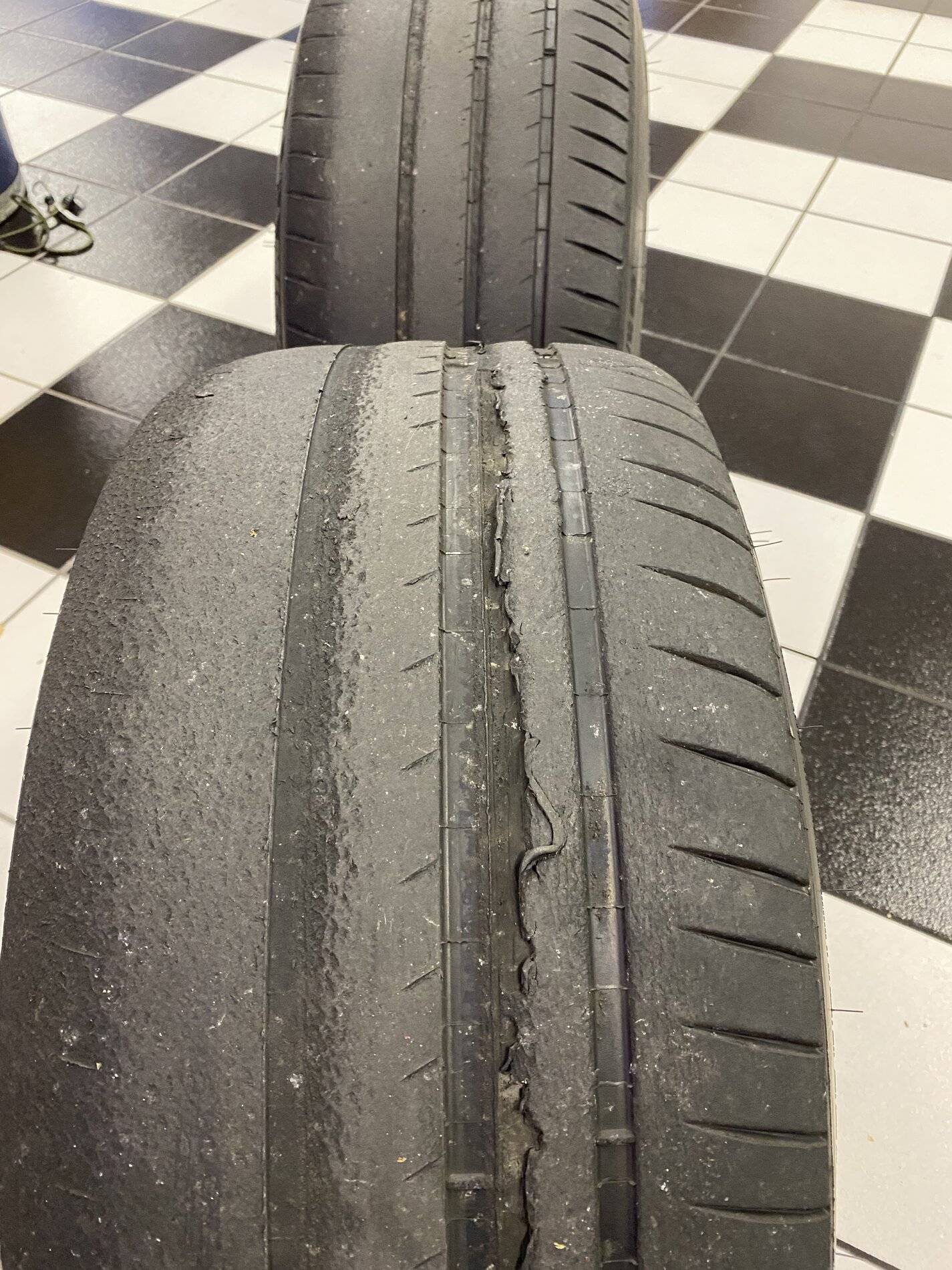

This is my left front after 2 track days. It looked fine after the first day and all others look perfect. Anything I should be concerned with? I feel like the track is pretty even between left and right turns. I’m running about 2.5 degrees of negative camber. Appreciate any thoughts

I ran 10 track days last year with -2.5 camber as saw similar results, my inside tread had very little wear. I just changed to -3.1 camber and saw great results. You can see that it looks like your inside is not even showing any signs of wear. After I switched to -3.1 my inside wall was wearing great.

I agree, more negative camber would help a lot and look at any long RH turns that are killing that tire. I get -2.7 to -3.0 with the factory camber plates and would like to have more. My tires wear are more even than that. What pressure were you running? Based on the wear I'd suggest increasing it, especially if you can't get more camber.
