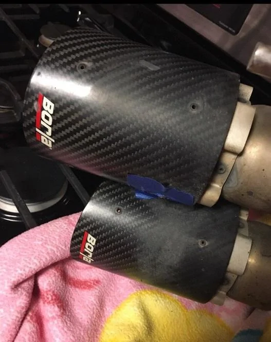

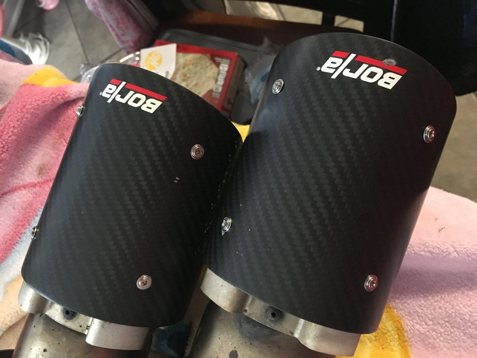

Currently running Borla Ataks with carbon fiber tips. I have noticed some wear between the tips on both mufflers. It’s weird because the tips are not touching and physically can’t because of the gap between them. I also noticed some whitening/fading of the clear coat and some of the hardware that holds the carbon fiber tubes onto the metal tips are wearing out. Some of the screws are missing and the rubber washers are decaying. Anyone else have similar issues and what did you do?

Here are some pics....
Had to tape off one of the screws so I could go at it a little harder with the tiny allen head to get it off. Had one that I had to dremel a slot into for a flat head as well. You can see how part of the finish is whitening.

Here you can see where it looks like they were rubbing which ate through the clear.

Wet sanded with 600 grit then 1,000. Used some old polish real quick by hand.. Also got new hardware with lock washers to hopefully prevent any from seizing up again. I wanted to make it easy to get them back off when I get time to fix them properly.

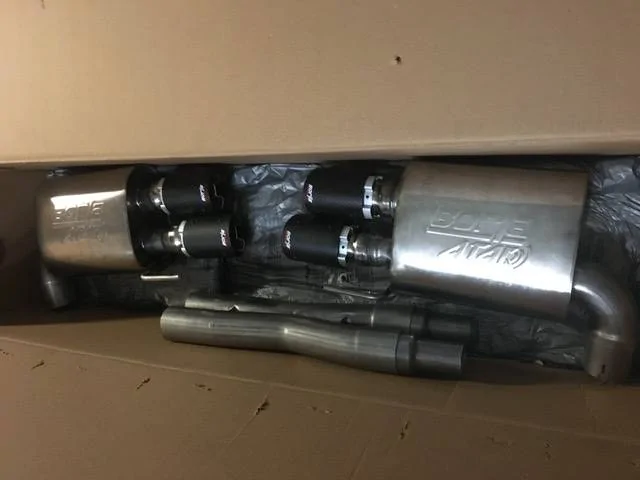

UPDATE:
Got home from work to find a big Borla box on the porch! I was told 10-14 days for it to ship. I had no idea it would show up so fast. There’s also an x-pipe in there. The packing slip just shows the mufflers. I’ll get with Chris and see what’s up. Hoping to put them on next weekend and I’ll post some pics. They look great with the trufiber spoiler.
