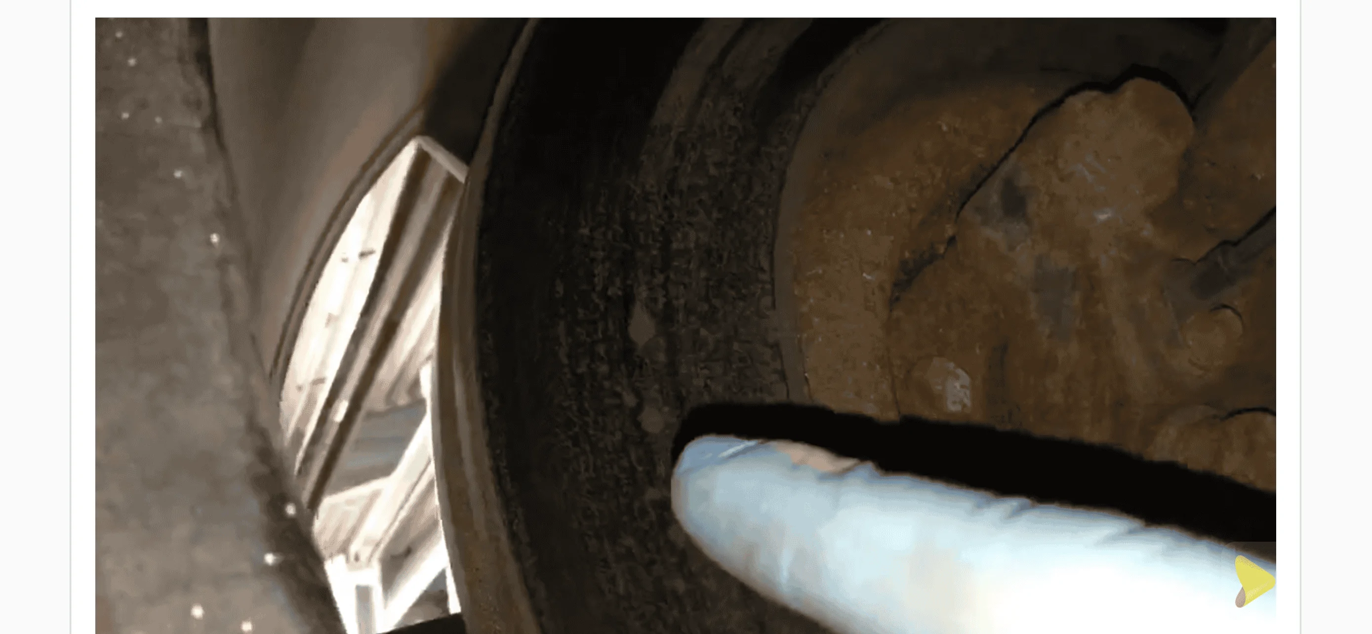

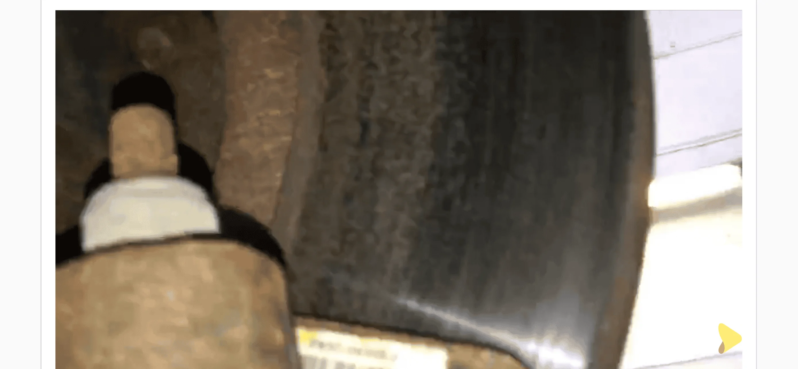

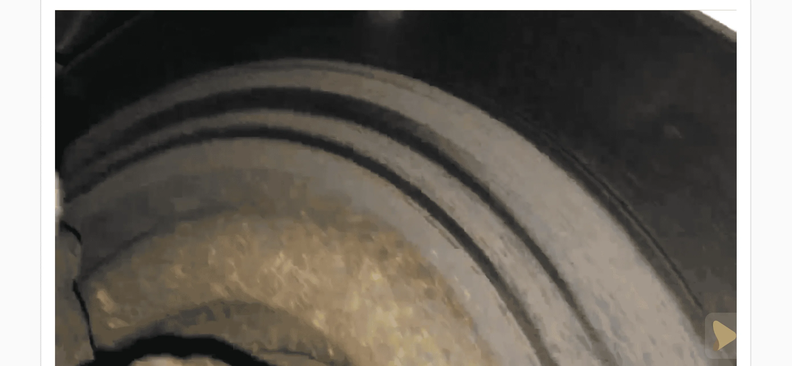

Some screenshots attached from the Dealership “Health check” video attached…

Hello; The images shown do not appear to indicate the disk is ruined. I have seen worse that people continued to use. I have seen much less pitting that some wanted replaced.
The main thing being the thickness of the rotor. If the rotor surface is still thick enough that surface pitting likely will not affect much. Bottom line is the rotors can be used if not worn too thin. Bear in mind my opinion from looking at the pictures is not the same as being there. I cannot really tell for sure. However, I have run rotors that were visually worse.
A thing some aftermarket rotors have is pits and/or grooves drilled into the surface of a rotor. The idea is the gasses generated during hard braking have pockets to go instead of being trapped between the pad and the rotor. Some disks have actual holes drilled thru them for the same reason. The drilled holes are reported to have potential as a place for cracks to start. Chamfered edges of the holes may help. My point being some small pits in the rotor is not the end of the useful life of the rotors.
The rotors pictured likely will clean up after some driving. The rusty pits will remain, but the rest of the surface should become shinny as the surface rust wears off. Here is a thing to consider. Even a shiny disk with no pits and a perfect surface can be warped and will cause a vibration under braking.
Here is what i would do. First drive the car and put some miles on the brakes in the sense of doing some stops. Does not have to be hard driving. Ordinary driving will clean up a rotor of most surface rust. The grinding noise caused by the surface rust should go away after a few stops.
Next, I would have a look at the pads to check for surface glazing and/or any other issues such as oil or brake fluid on them. (the dealership that took the pictures ought to have spotted fluid, if any, but competency is not universal.)
Last is to check with a tool to see how far out of true a rotor(s) may be.
Here is something you may not be able to do. Try to not park the car when wet from driving in the rain, at least for a long time. I get we cannot always pick a dry day. The cars with nice rotors tend to be those which are driven every day. Good luck.

Wow, do you park the car in the sea overnight? The rust on everything (not just the brakes) is far worse than mine which is a year older.
Lack of use is the big killer for brakes, you don't see rust on 20k miles/year cars.
