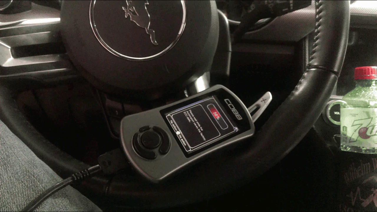

So if I get this cobb accessport https://www.cobbtuning.com/products/accessport/ford-mustang-ecoboost-accessport-v3 Do you have to leave it plugged in all the time for the performance to be there or can you set it and put it in a drawer until you need it next? Also does this caused the engine to get hotter? If you don’t plan on doing other mods such as inner cooler or exhaust or cold air intake does this work pretty well? What kind of performance can you get in regards to horsepower and torque?

From what I understand, (and this is what I did) you can store the factory tune to your Cobb device and then load the tune of your choice from the included menu to your ECU. Then remove until needed. The reason for leaving your device plugged in is for additional data (up to 6 gauges) and for data logging and/or trouble shooting.
Disclaimer: I've only had my Cobb device for a few days... and am still learning about the advantages and limitations it has to offer.

To the other questions. If you use the Accessport, no you don't need it plugged into the OBD port at all. You can flash the car, take it out and throw it in a drawer. I keep mind plugged in and on the windshield so I can watch all the parameters that the Ford gauges won't show. If you're worried about the dealership finding the tune, that's another story. The Accessport keeps the factory tune available as Stage 0 or something similar so whenever you want to go back to the dealership you just flash the factory tune back on and the car is back to normal. But they would have to actively be looking at the PCM to even notice. If you're in for an oil change or tire rotation, chances are they won't even be in there. I blew my rings out on cylinder #3. Reinstalled all my factory parts, flashed back to stock and the dealership rebuilt it all under warranty. Never found anything. But that's extreme and I have my own garage and tools.
In your case, a Cobb AccessPort with a Stage 1 tune sounds like a good idea. If you keep the car you can upgrade the tune as you add parts. If you sell it, you can sell the AccessPort on the forums for close to what you paid. It's a premium high resale item because they work and they're quality. Another route, you can purchase a small, upgraded aluminum radiator from the for sale forums for very cheap. It goes right in the stock location with no modifications or tune needed. Even on the stock tune, the car will run so much better thanks to you lessening the heat soak that plagues these motors. Dealers shouldn't have a thing to say about it either. Intercoolers are 100% positive mods, like using premium fuel.
Just a note, stage 0 isn’t the factory tune. It’s a ā€˜simulated stock’ tune. When you install the ap it saves the factory tune to the device, the only time it’ll put that back on the car is when you choose the uninstall option to unmarry it. Semantics, I know, but if you have it flashed to stage 0 and the dealer flashes the ecu for an update or something, your ap is now married to an ecu that it thinks doesn’t exist.
