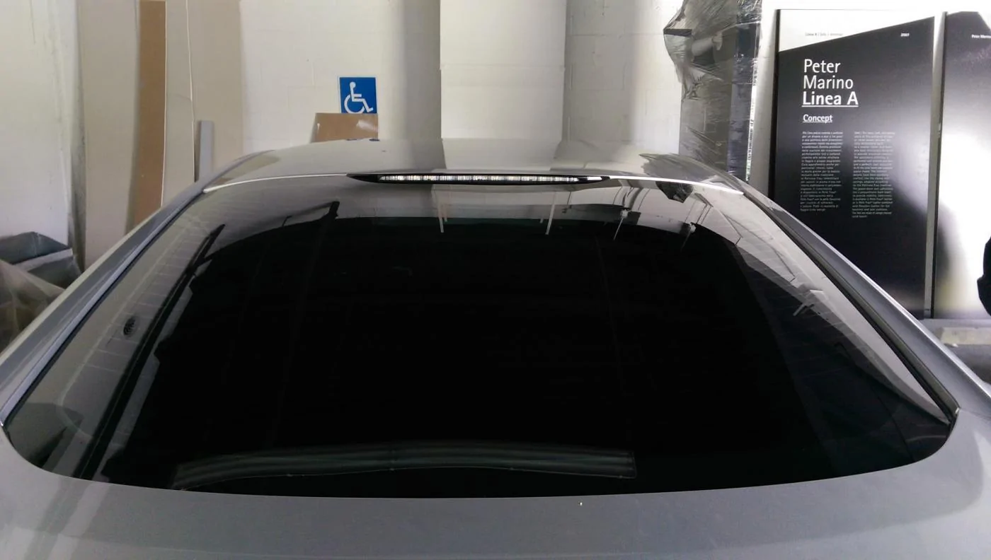

The US GT that my dealer has got for his display, because there are no UK ones yet, looked like the picture above.
Bit shocking that they are selling them like that.
Welcome to American labor union quality

And you are still believe on Santa?
My dealer did cut out all windows in the back to measure the body on some spots. Believe me that the crooked rear window has nothing to do with the sealant. It was already posted from a couple owners. The left rear quarter panel is a bit lower welded in than the right quarter panel. I posted already pictures month ago about this issue.
As long customers don't care what quality the new Mustang has, FORD will not change the poor quality they produce. Shipping out Mustang LE with the same issues shows really that FORD doesn't care at all. :crazy:
So... have you bought a GM yet?

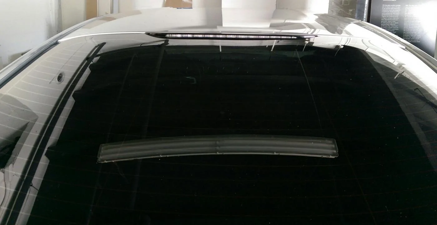

I am going to see a dealer this week to look at fixing this that has re/re'd the glass with new glass on a few cars already with great success. Mine is off by about an 1/8th to 3/16th. I connected with a member that had it done by this dealer (and lead me to them) who is very happy.
Having said this, I've asked around (dealers and glass shops) and I have not walked away with a lot of confidence that everything will be okay when it is done. Concern really was more about what it will look like after replacement and whether it would be level. Paint scratching at frame was also a concern by some however with the wire/string method of removal this should not be an issue if done by an experienced glass tech.
There are likely sheet metal issues (roof line is a little lower on drivers side) and or there may not be enough sealant on the drivers side to compensate if necessary. In addition the suction cups that lay the glass in on the drivers side at the factory do not hold the glass in place long enough for the sealant to set up properly so when it releases the glass sinks (this last point was noted by a member who used to work at Ford). This is also not helped by the third brake light not being aligned properly (again likely sheet metal issues).
In my case the fix 'maybe' just leveling the 3rd brake light, not sure. It is slightly off level with roof line. Adjustment may not make enough of a difference. Fix may involve adjusting glass and light. I've seen a lot of 17's with this problem too.
