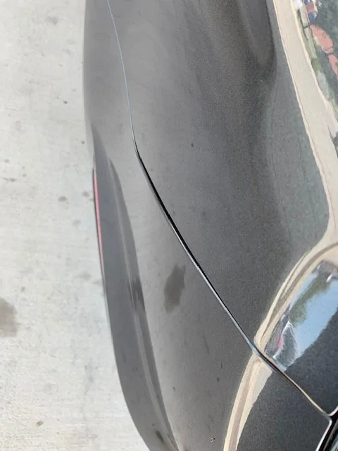

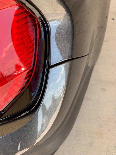

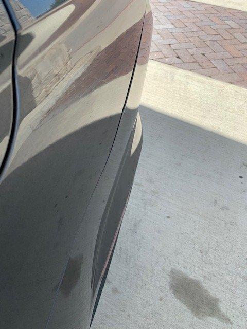

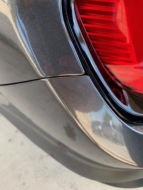

I noticed that the bumper on my new 2019 GT premium had a larger gap against the quarter panel on one side than the other. I also noticed the opposite side had a very tight gap and the bumper bulged out a bit on that side. I'm taking the car to Ford's local collision shop tomorrow where they claim a new bracket will fix the issue. They claimed they had this bracket problem on the GT350's but are now seeing it on GT Premiums.

Mine is a stock GT premium. It came from the factory this way. Only had it a month and discovered this misalignment 3 weeks ago. Ford says they think it could be a bad batch of rear bumper brackets, which is what they found on GT350’s that had they same problem. So they are replacing that right now. If that doesn’t correct it then they’ll have to put a new rear bumper on. I should know something later today. I’ll post the results when I know.

Thanks. I got the car back from the Ford collision center. The panels fit a lot better with the new bracket. But the collision guy did say the same thing you just said. I guess from time to time the panels can pop out after a bump or something. And he said the panel will reseat if I hit it as you said.
