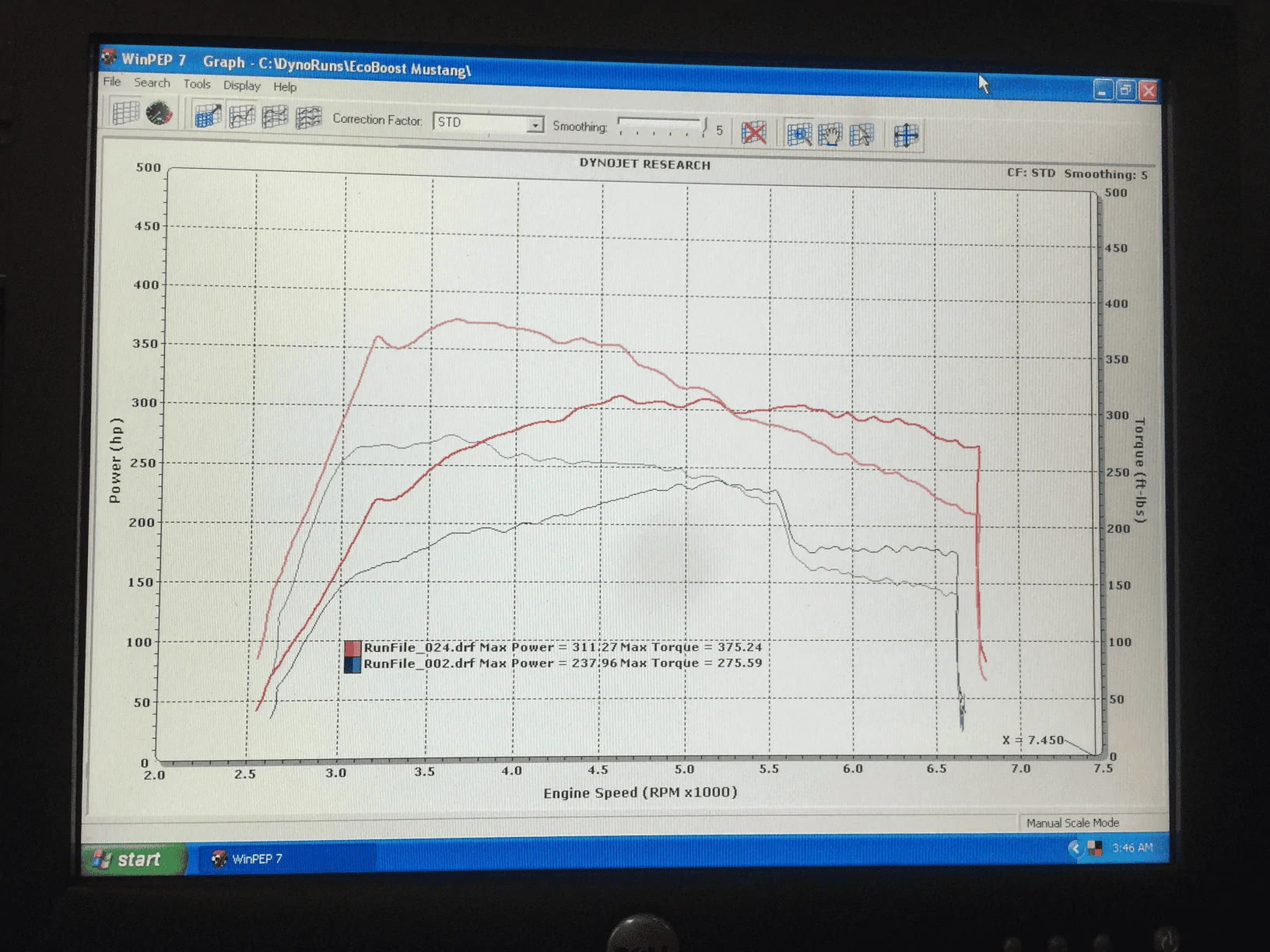

My old dyno with my old 2.3t, that was without a DP/Exhaust, stock wastegate actuator and with a custom tune by a general tuner, so I know the 2.3's potential, though the HPP does seem interesting

That looks like a typical 93 octane tune, on your Eco. The stock clutches are different on the Eco & GT. Clutch life is very dependant on the driver. Torque and driver technique is what will most shorten the clutch life. On stock or lightly modified cars, you can get good life out of them as long as your not hard on them or doing a lot of high rpm dragstrip style launches. The more torque you make, the harder you launch, and the more city driving you do, the shorter the clutch life.
