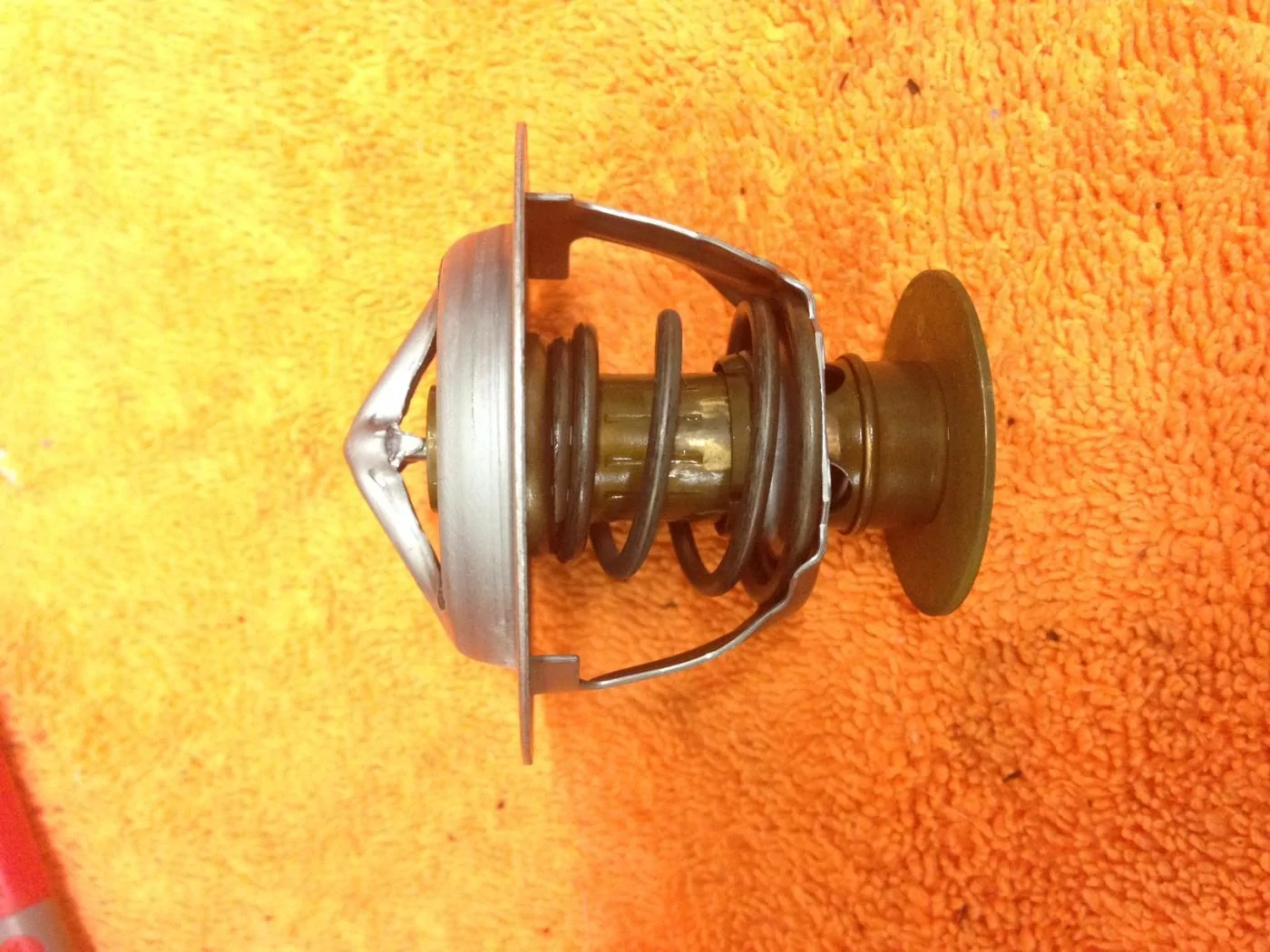

Here are the pics of the thermostat that I pulled out.
[/URL][/IMG]
[/URL][/IMG]
[/URL][/IMG]
[/URL][/IMG]
Thanks any number on the bottom? in the center in the hole.
looks like an evenflo 160.
