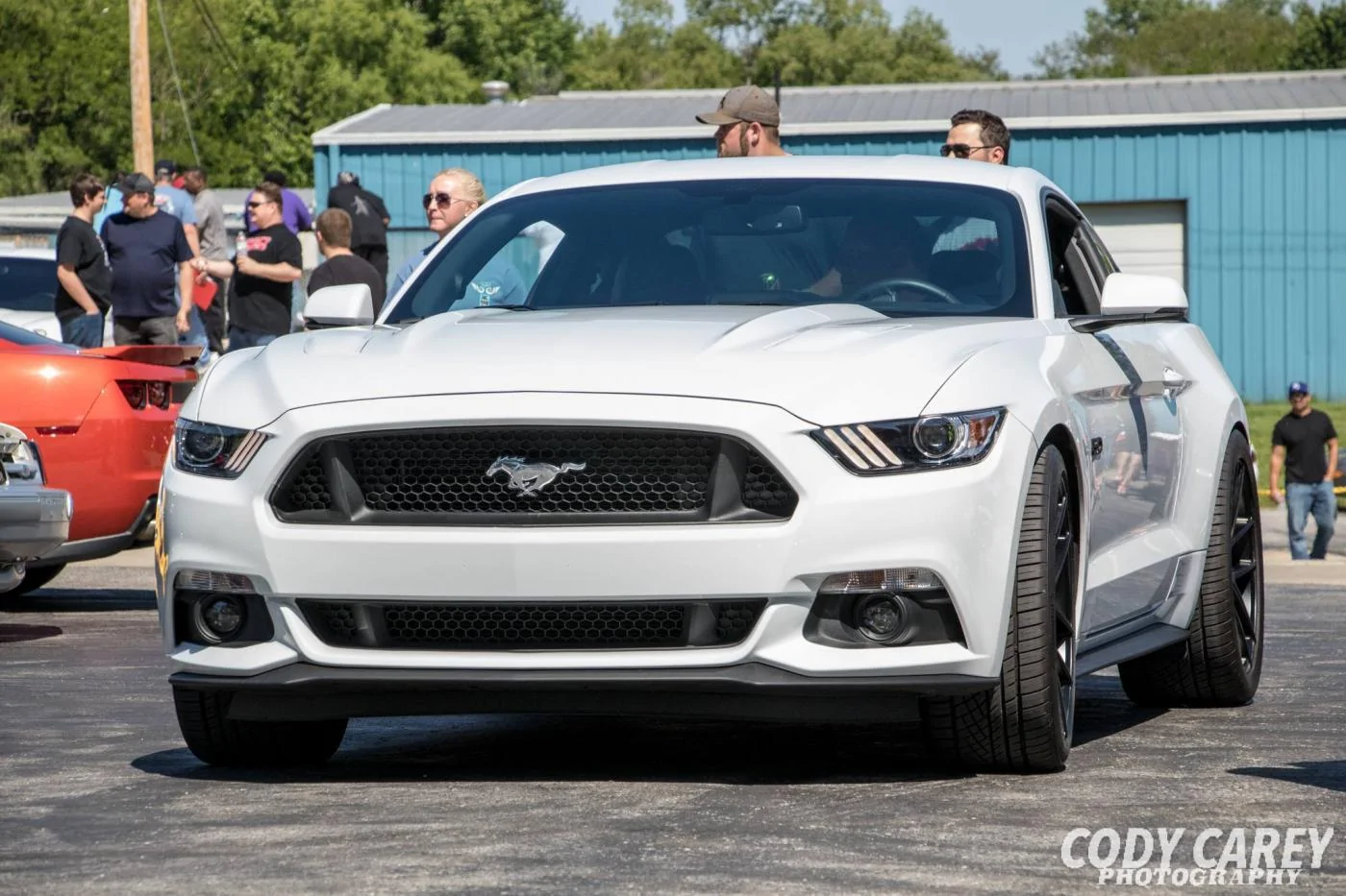

19x10" +35 Project6gr wheels. (Offsets wont change for 20s). MPSS tires in 285. I have a little more camber than most with 2.4 in front and like 1.7 in back.

I haven't stuck a caliper back there, but probably 6-12mm. Enough to wedge a bit of your finger in between the shock and tire.
Wider tires, more camber = less clearance
Lower offset = more clearance
In the end it works out fine.
