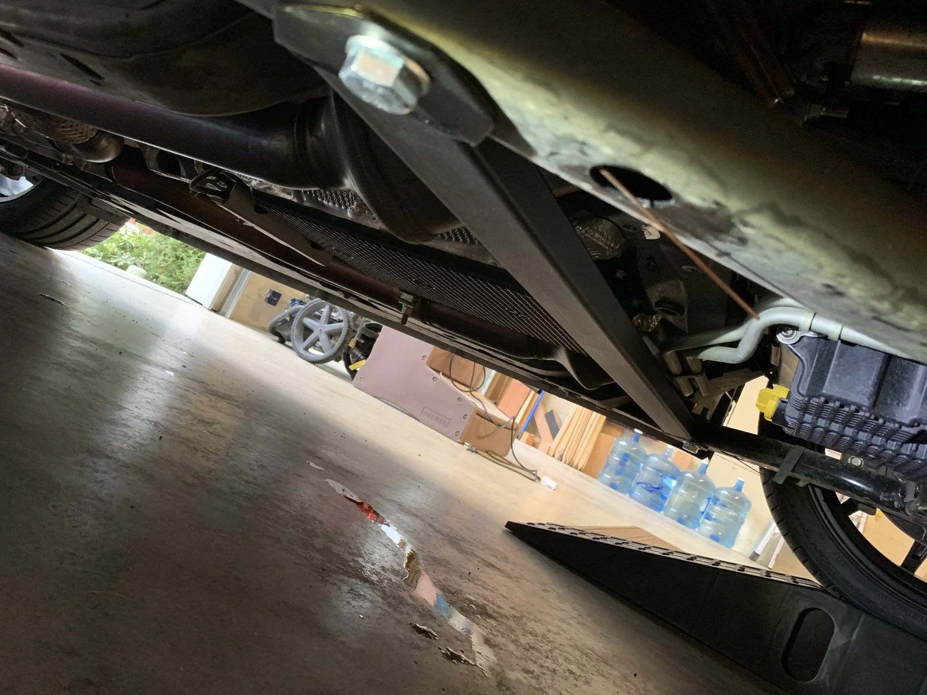

Purchased the Steeda G Track K Member Brace about 2 weeks ago. Super looking forward to the install. Got the Mustang on the ramps and went to install the spacers. Bang-issue. The spacer was too large to fit all the way down the rail. Tried several times no luck. I have a 2019 GT CS. Contacted Steeda (even though I purchased through CJ). John answered right away. Knew the issue and asked for Photos. Got an email next business day from Scott. All over the issue. It appears that the rail they put on my car was skinner than the designs. Scott had Steeda engineering on it, new spacers out the door that day. Wow! That’s service. Thanks Steeda.

Purchased mine one week ago also and I have yet to install it as due to this COVID19 issue all dealers are closed....but looking very much forward.
How did you figure out that the spacers were not correct? I am a bit concern! picture of the first set?
Also...it seems that is a 2-point not the g-trac K brace?

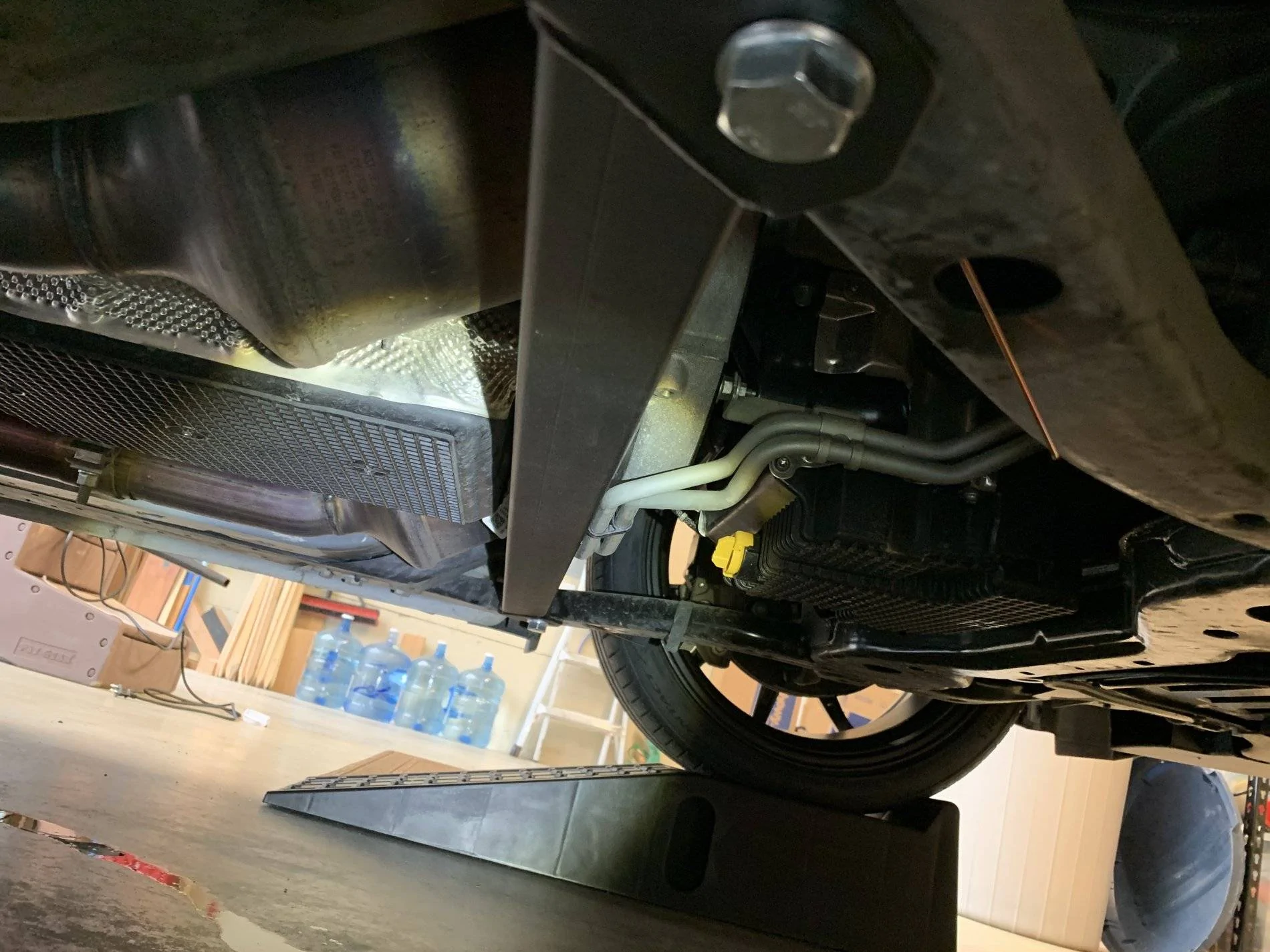

whew! those trans lines look really close to the brace you just installed? any issues there?

Correct. 2 point not extreme brace. When I tried to install spacer it got stuck half way. Figure my tube must have been a little smaller inside. Steeda sent me a shorter set. Most likely a manufacturer variance.
No issues so far. There is space, I was watching that as well when I installed. Nothing moves so all good.

is the clearance only an issue for the automatic transmission or will the m6 also have an issue? was thinking about adding this until I read this thread.
No issues on the M6.
Not an issue. Just close
