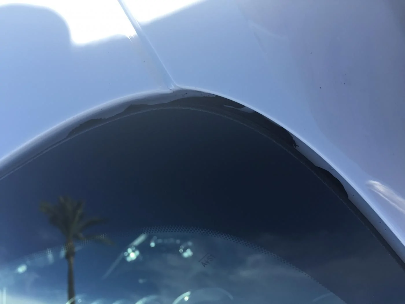

My windshield had a two foot crack occur during a road trip last weekend. I had it replaced this week by Safelite. Only positive was that they used SoundScreen OEM Glass. They did a horrible job with the chalking around the windshield as it is visible all the way around the windshield. Some of the plastic shielding below the windshield wasn't fully seated and reinstalled. On the inside the car stunk pretty bad and has a fine coating of black dust on everything. There were pieces of the old chalking and plastic bits all over the inside of the car. Found some of the black windshield chalking on the passenger door handle. I don't know what everyone else's experience was with them but I won't be their customer again.

That is unfortunate...I had to have my windshield replaced as well by safellite and he did a absolute perfect job but then again I was over his shoulder the whole time and kept reminding him to not to f*** up my baby. He laughed and was a cool guy. All in the individual installer I guess.

I think its standard procedure for Safelite to contact you at least twice concerning your satisfaction. Talk to them first, if they don't make it right you have a reason to boycott them. Not every installer graduated at the top of the class. After 40 years in the service business I can safely say no company delivers excellent service 100% of the time. Let them know and the installer gets more training or the boot.

I had a bad experience with them as well on my replacement. Had the identicle factory glass installed. I wasn't happy about having to do it in the first place as I only had about 5k miles on the car at the time. It looked brand new, I was really nice to the guy, but he apparently didn't care.
He completely half assed the install. There were scuffs in the paint around the windshield, it was slightly off center and when I drove it air was leaking in the cabin from the left side. The rear view mirror vibrated so hard you couldn't make out anything in it. They were rough as hell with the headliner. The worst part was when taking a hard right turn there was a terrible ripping noise from the seal across the top of the windshield.
A few days later they had someone else come out and re install it and the guy had a laundry list of things that were done incorrectly he went over wth me. Like most things, your mileage may vary.
