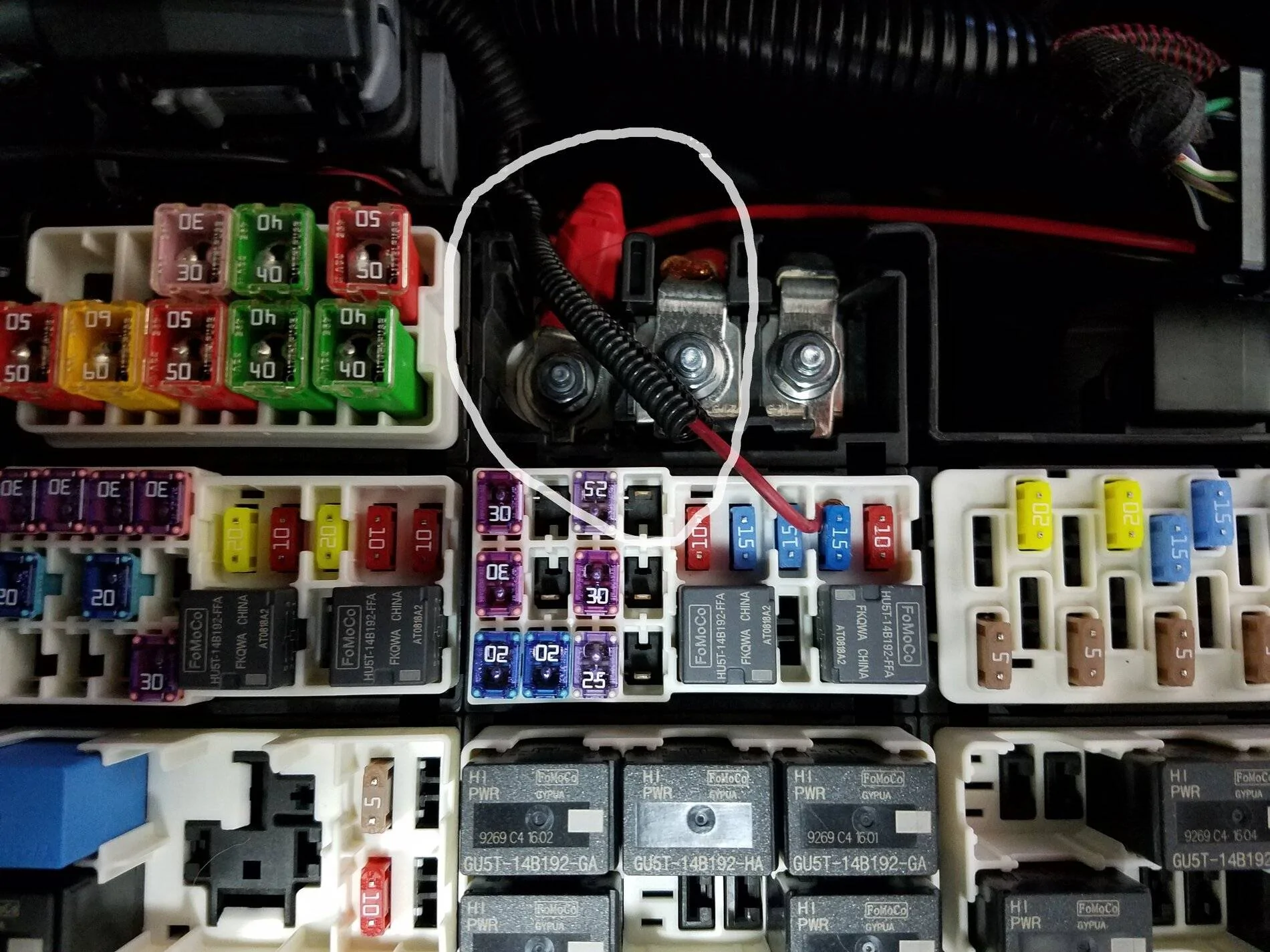

Can I power up my sub amp to a terminal that adjacent to the battery? There are 2 large terminals (see photo) adjacent to the battery OR do I connect to the positive side of the battery itself?

You want to use a thick gauge wire (no less than 4 gauge usually), so I just run from battery terminal and add a fuse very near. I try to make sure that fuse is within 6 inches of the terminal when possible. I do believe it is also fine to run from that positive terminal in your pic.
