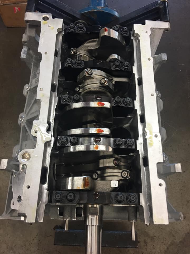

I gotta hand it to the guys at Livernois. Dan had promised me an engine, and even with the car was sold, what do you know, a couple months later and Livernois lived up to their promise, and a sweet looking gt350 sleeved shortblock showed up without notice!!!

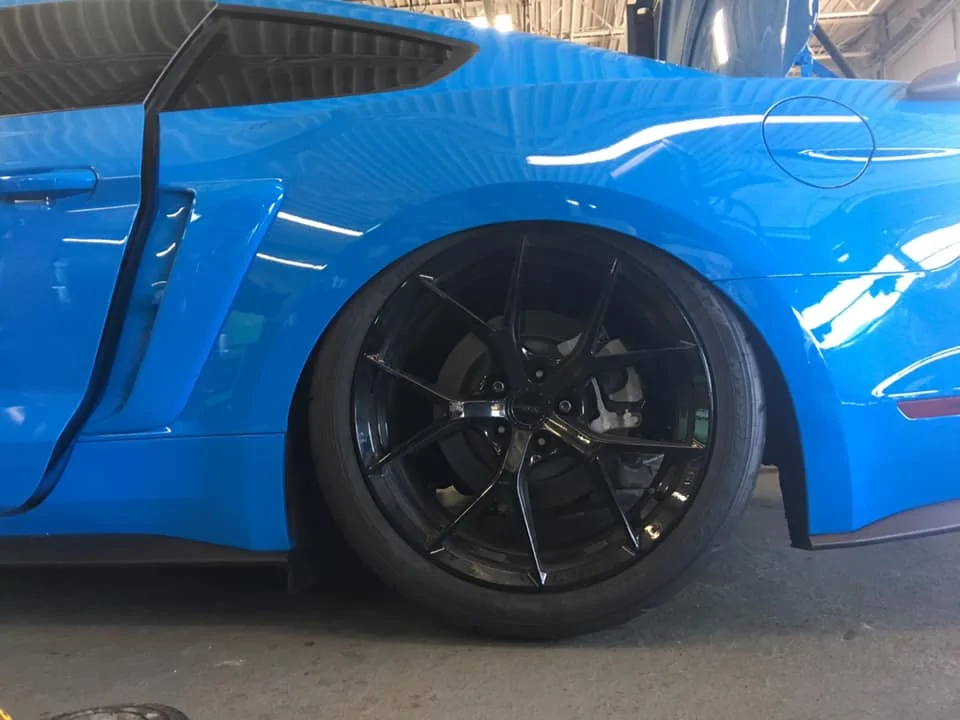

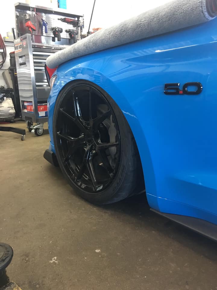

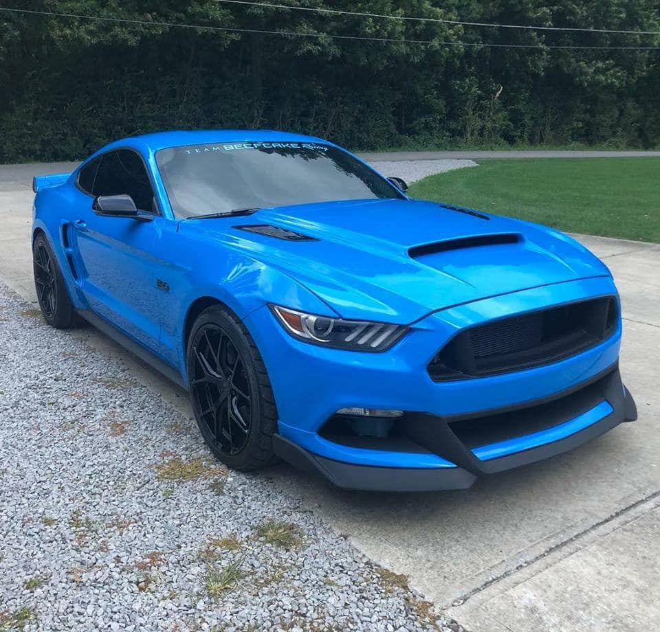

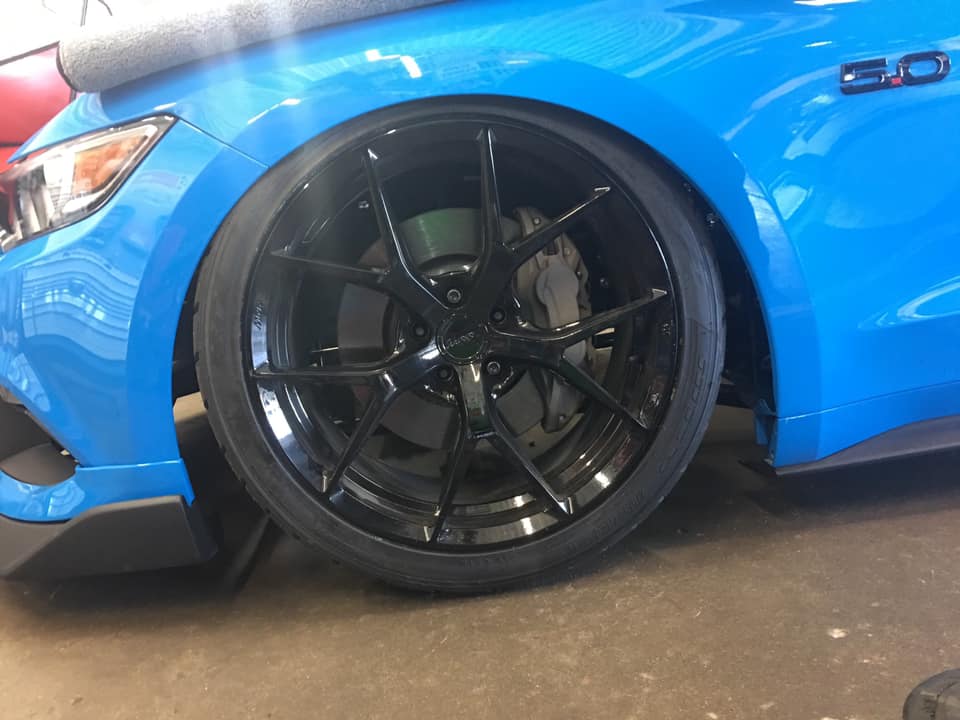

We like to throw a wrap on the cars, but as soon as we do, somehow that makes them "race cars". So, for looks we started with a Cervini's Stalker body kit, and a set of MRR FS06 Wheels with a custom offset to tuck the 315's in enough to drop the car.

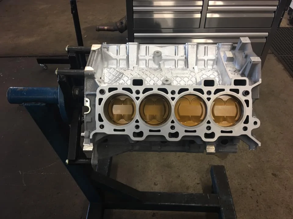

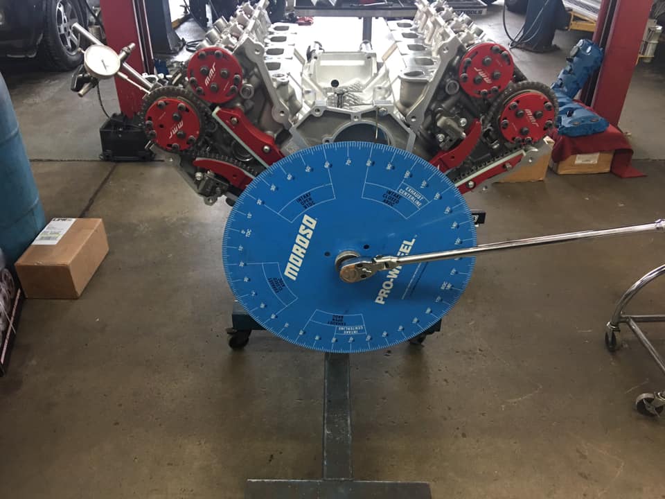

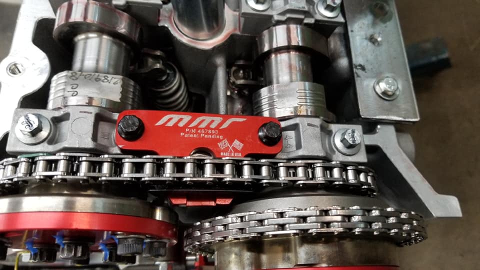

Livernois 11.5:1 shortblock. Non ported heads with a valve job, pac springs, and ferrea valves. We went with comp stage 3 n/a intake cams, and comp stage 1 n/a exhaust cams. Lockouts are by MMR along with OPG's Sprocket, Chain guides, chains, and tensioner flip bracket.

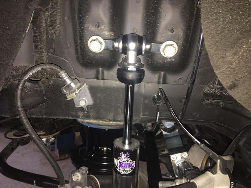

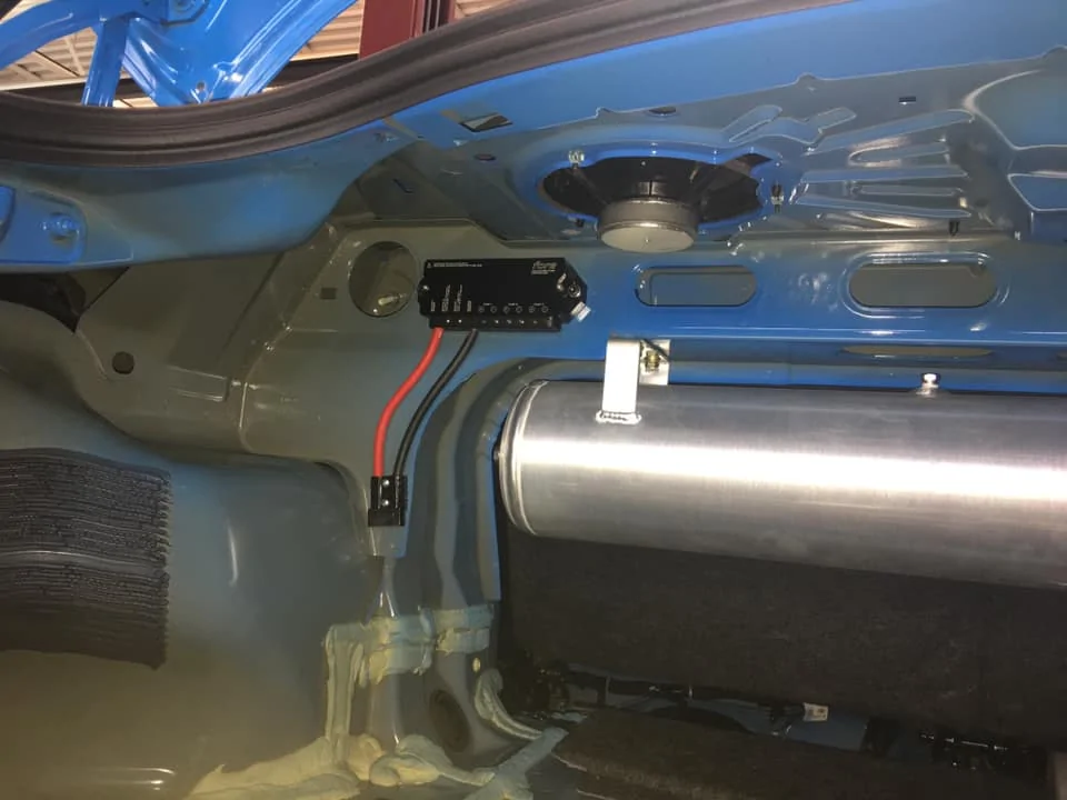

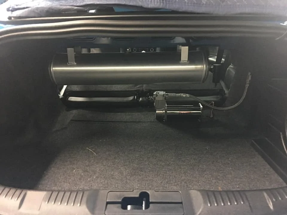

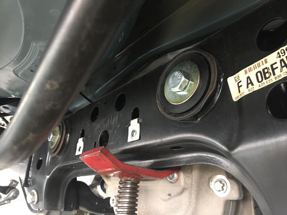

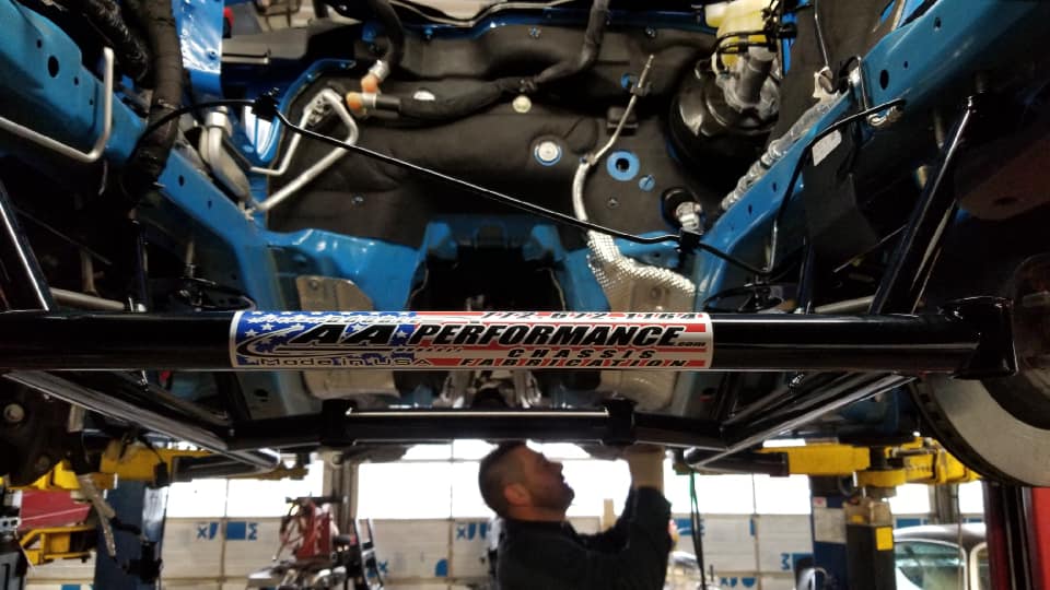

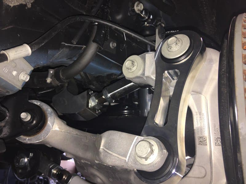

Suspension is an Airlift Air Ride Kit, substituting Viking B3020AM Crusader rear shocks. The B3020am replace the upper mount and are for 1.5" to 3" lowered cars. We also went with a full Steeda Stop the hop package, rear adjustable camber arms, and a bmr rh017 diff bolt kit. We had planned on one of the Double AA K members we offer, but the way the K mounts, we need 3 more inches of clearance for the turbos. We'll have one of steedas new S550 k members here in a couple weeks, and since it routes more like the stock k member, i think it should work fine.

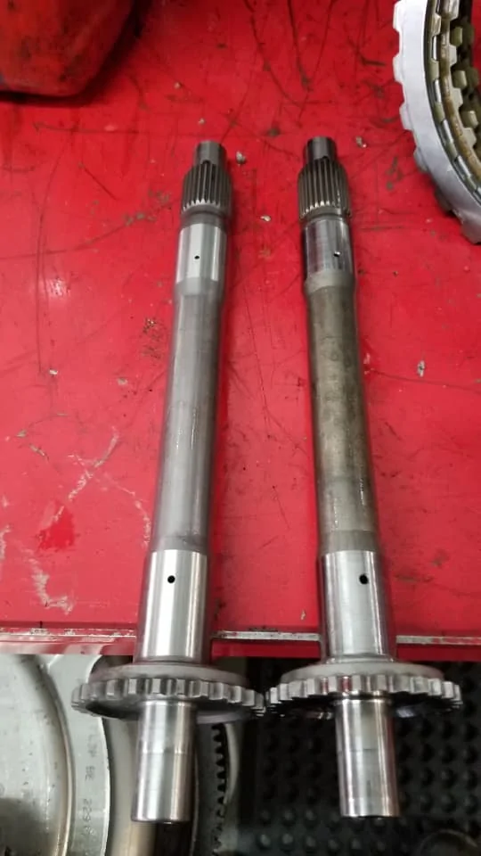

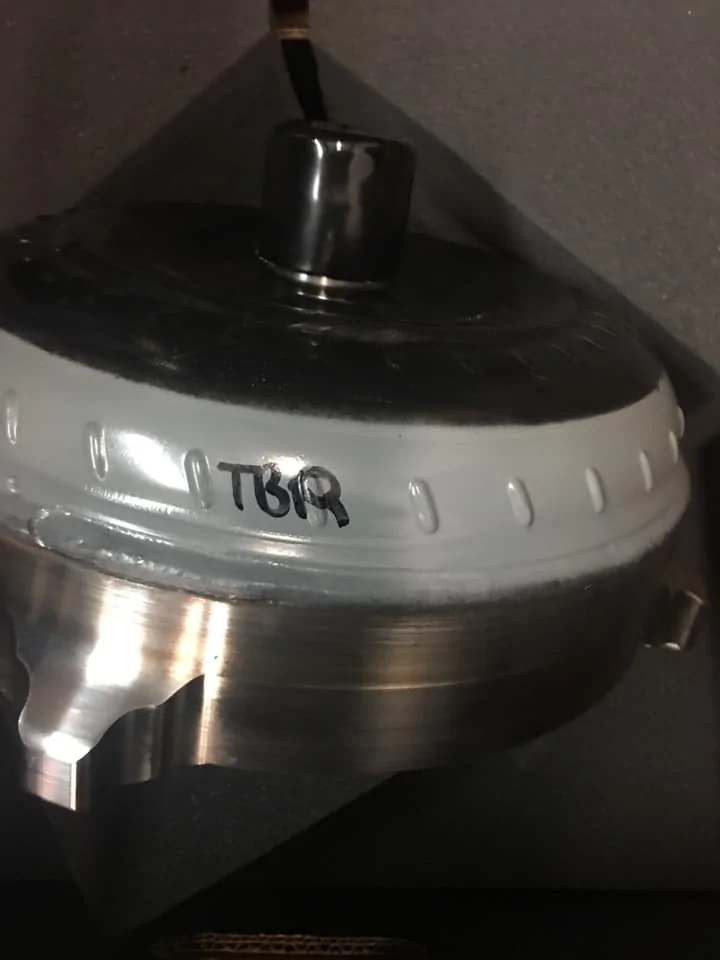

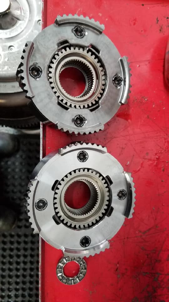

To handle all the rwhp and torque we'll be putting down, we just rebuilt the 6r80 with exedy clutches, TCS billet shaft, and MSR billet planetary and one way clutch. We do the builds in house, and have been one of the leaders in 6r80 transmissions for the last 8 years. Alot of people forget we actually worked with exedy in the testing and development phase of the clutch packs and we have built a couple hundred of these transmissions. To finish off the trans we are putting in a custom Circle D 252mm converter.

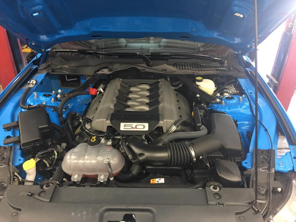

2018 Ford Mustang

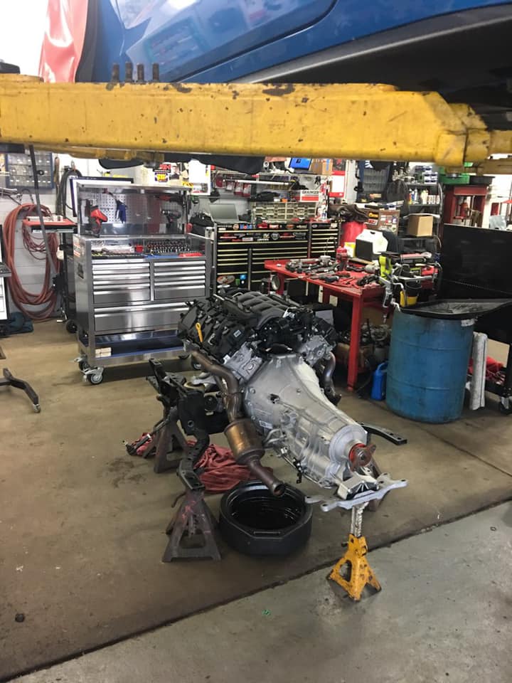

time to get started

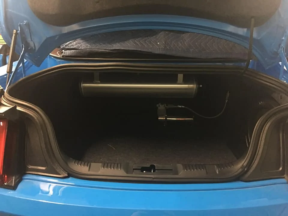

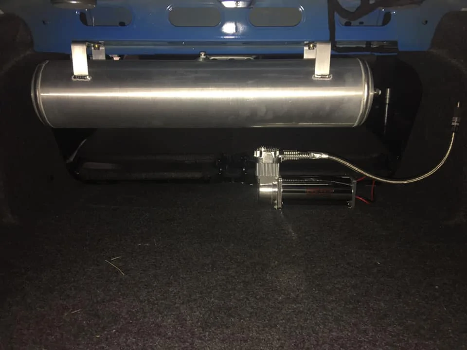

2018 Ford Mustang

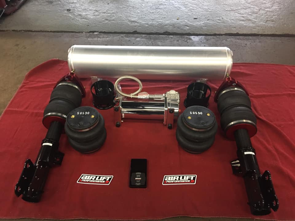

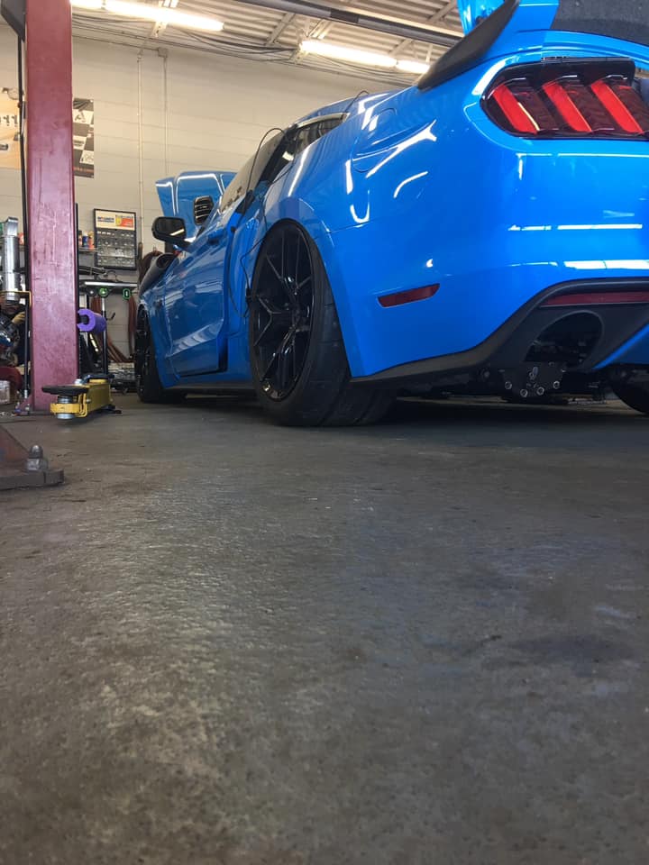

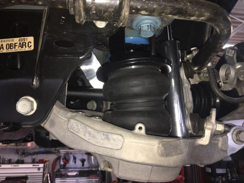

lil air action, and some clean wiring

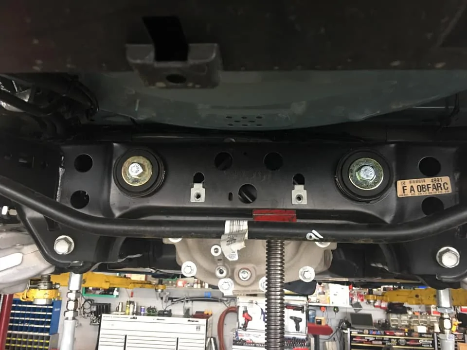

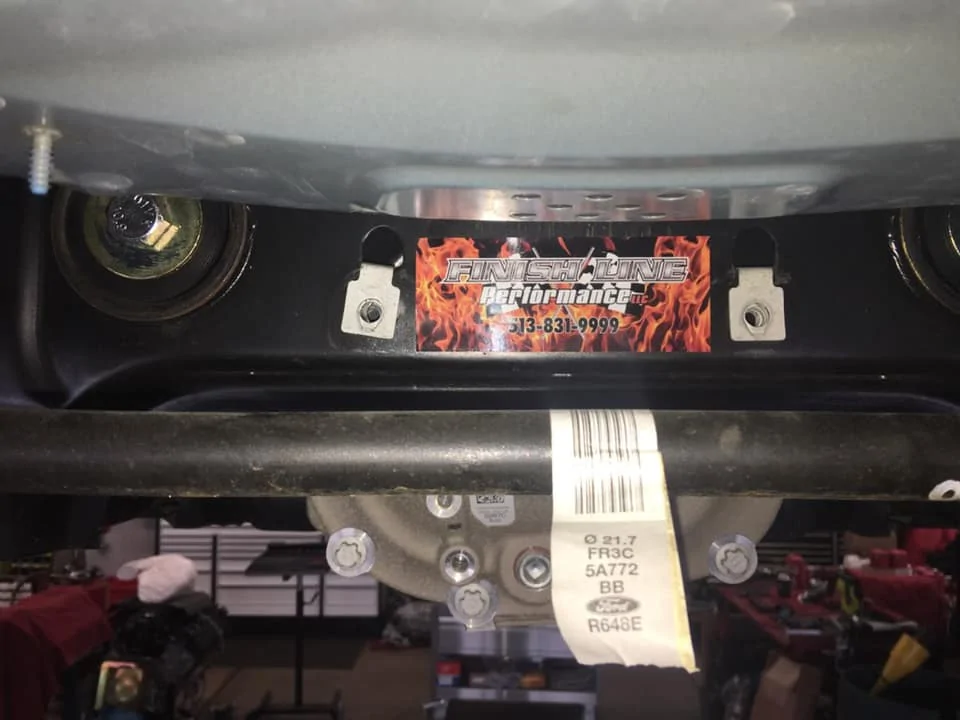

2018 Ford Mustang

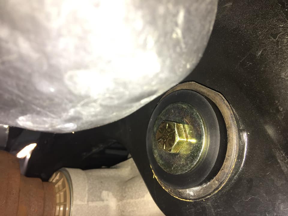

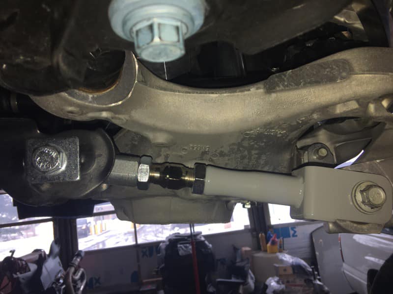

some Steeda, viking and bmr action!

2018 Ford Mustang

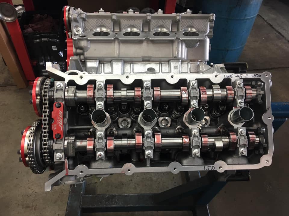

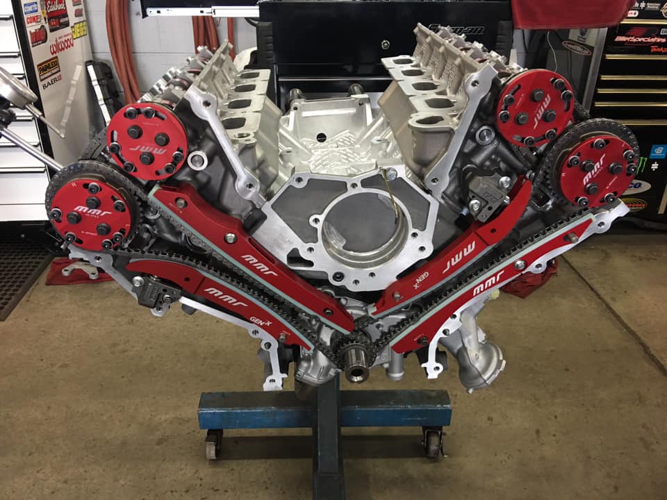

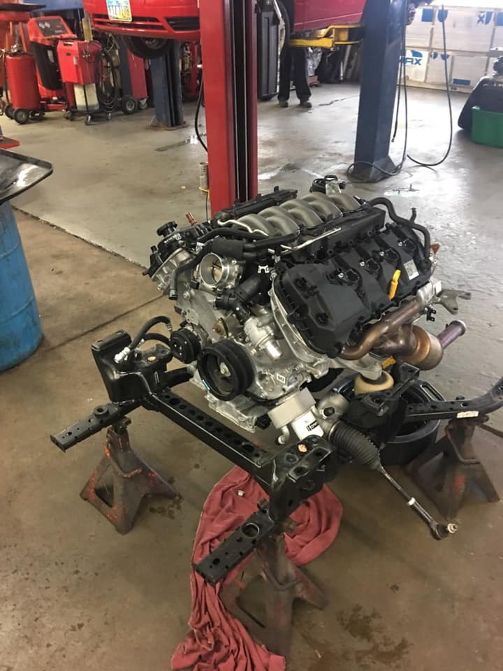

engine assembly

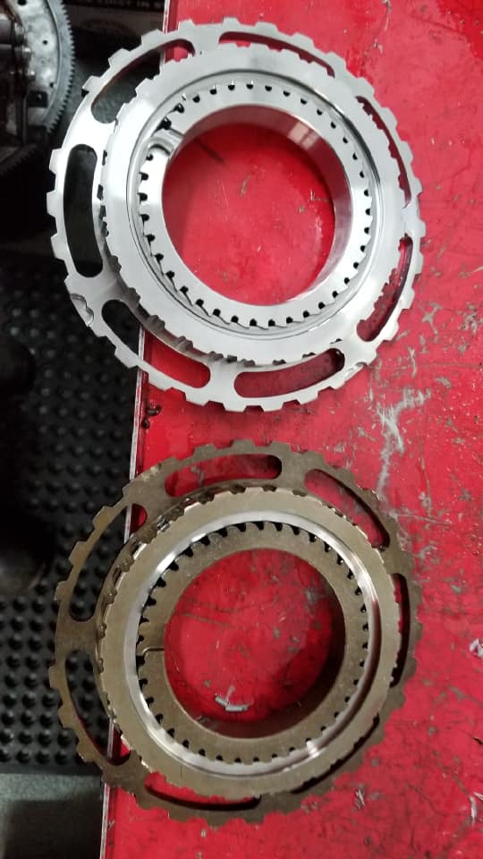

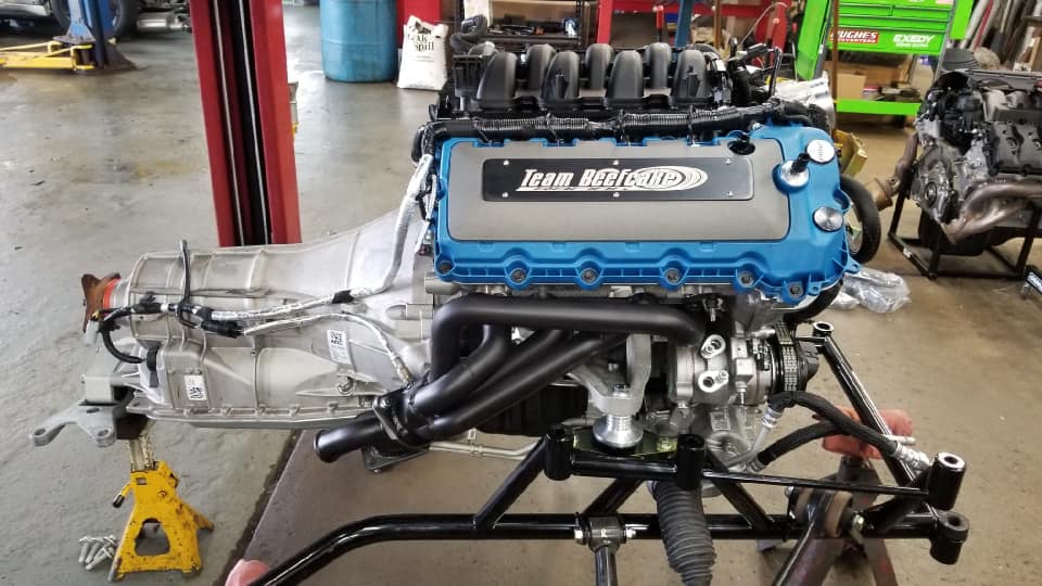

2018 Ford Mustang

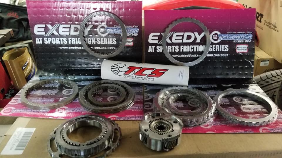

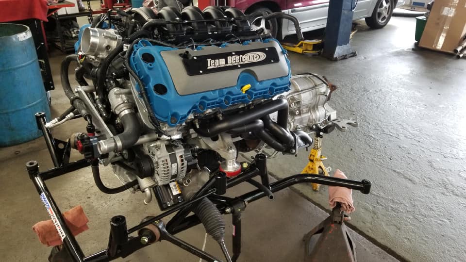

trans and assembled engine

Air Lift Fully Installed!!

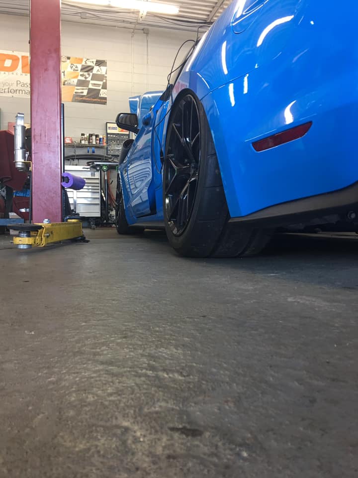

Would you please share the specifications on your FS06 wheels including the custom offset. I am bagging my 18 and would love to tuck 315's? Thanks!
so we originally had a vossen 10.5 on the rear, that had a standard offset a few more mm than these. and with the smaller wheel, the tire bulged a little more. it would actually touch on big bumps. i figured with an 11" wheel, that would spread the tire a bit more, but the standard offset on the mrr's put the wheel out about an 1/8" more.
i tt darren at mrr and we were able to take a little more off the pad, and actually tuck the wheel about 1/8" more than the vossen, that , along with the 11" wheel spreading the tire in more, the look is perfect, and works great with the air. i'll have to pull the specs up in the email tommorrow
