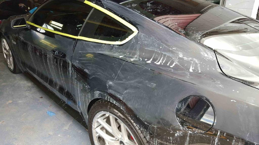

We did 2500 followed by 3000.got a lot of the peel out but take it sloooow! You can burn thru the minuscule clear and into the paint in a nano second!

Good tip. Was considering using very little press with mine to see how it fairs after a couple of passes. Are you a professional or hobbist?
