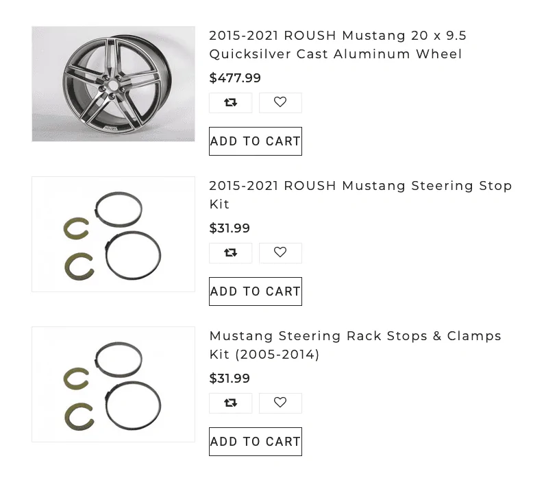

If you have 20s did you purchase the steering STOPS. Are you aware of these, go on the rack, keeps the tire from hitting/rubbing the inner fender well, no one has mentioned this .
Buying wheels for a Mustang from Roush or Ford, off set will be as it should.
9.5 is a small rim. think about 10.5 x 19, tire 305/35/19 fat grippy, many more choices rubber wise.
