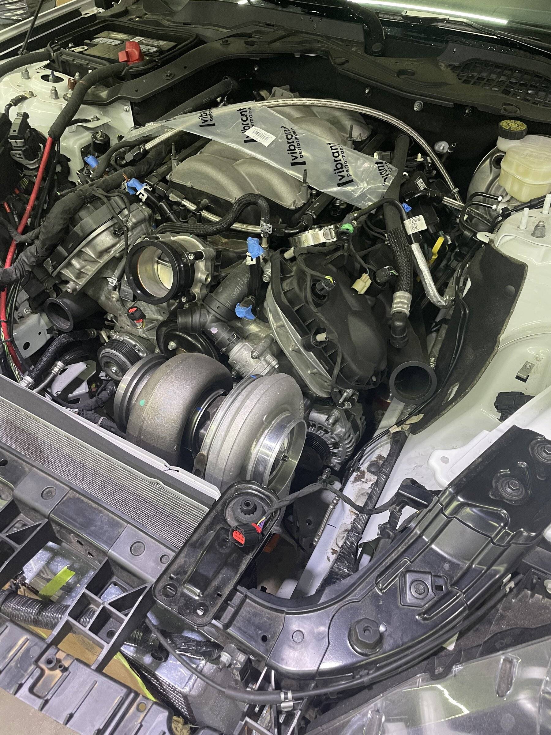

is that a BL fab kit or you did you retrofit a T6 to the On3 kit. I think it is an On3, where are you running your exhaust?
Custom kit. Exhaust will run between the engine and k member. Ac lines are getting rerouted.

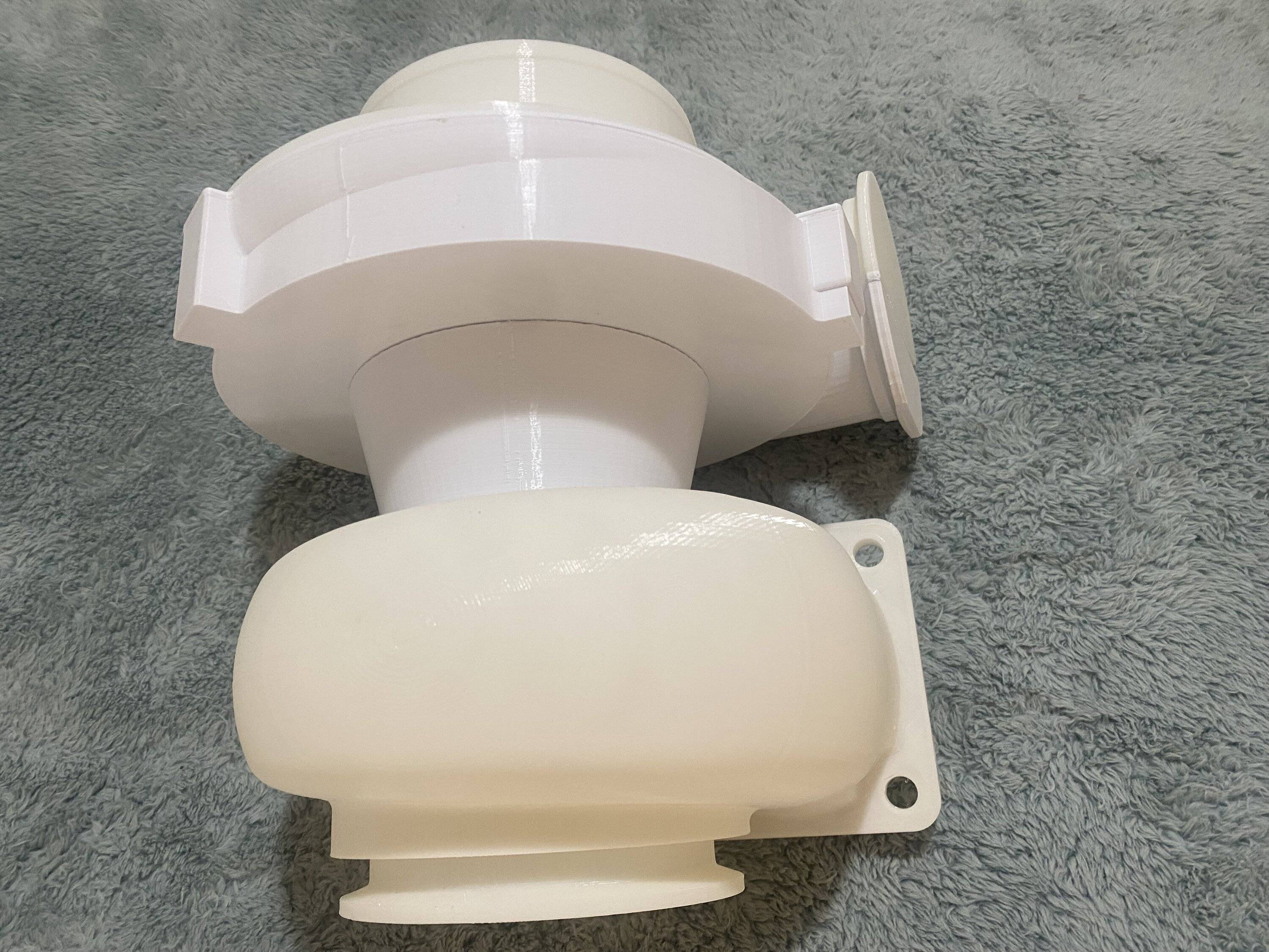

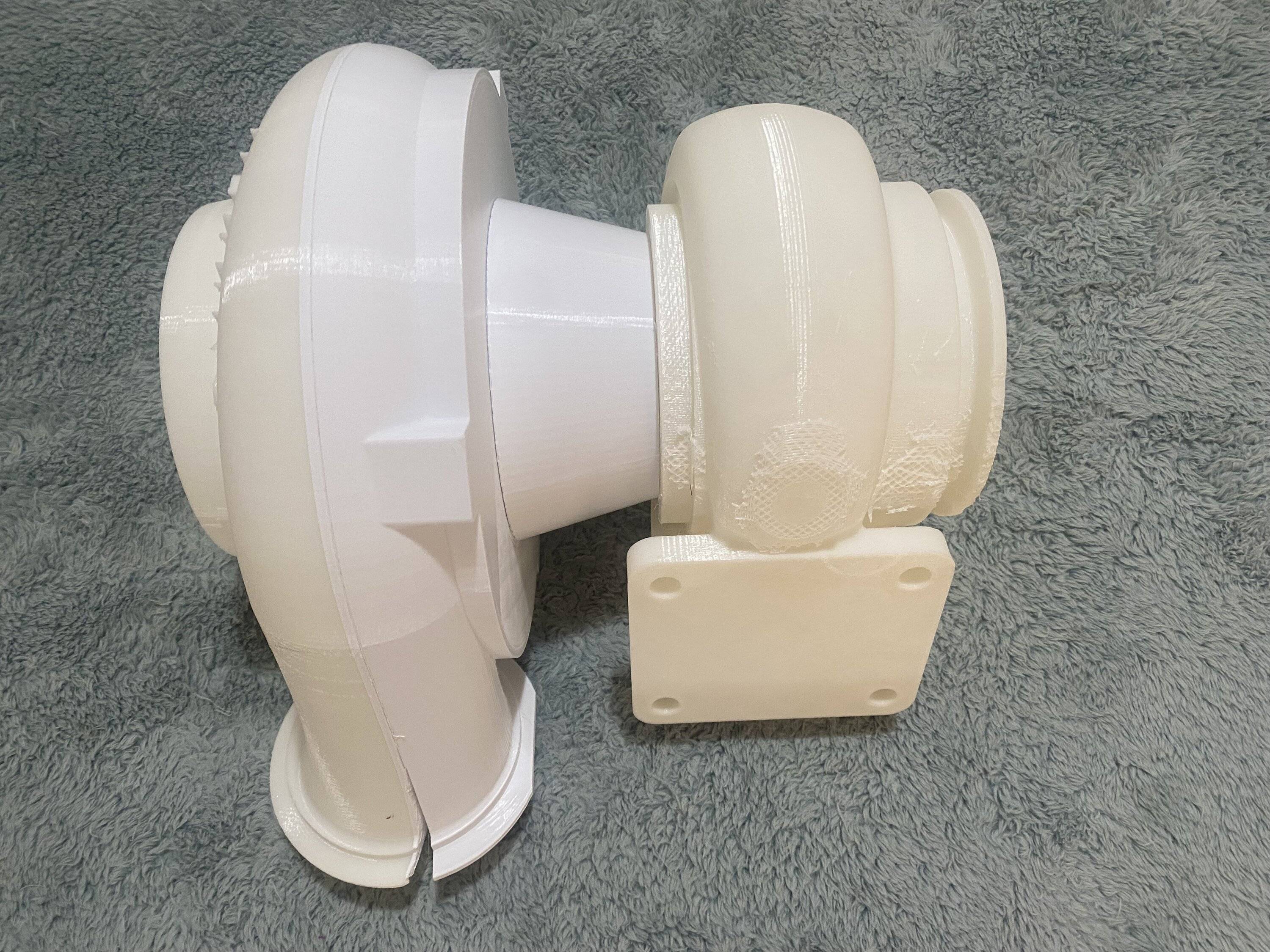

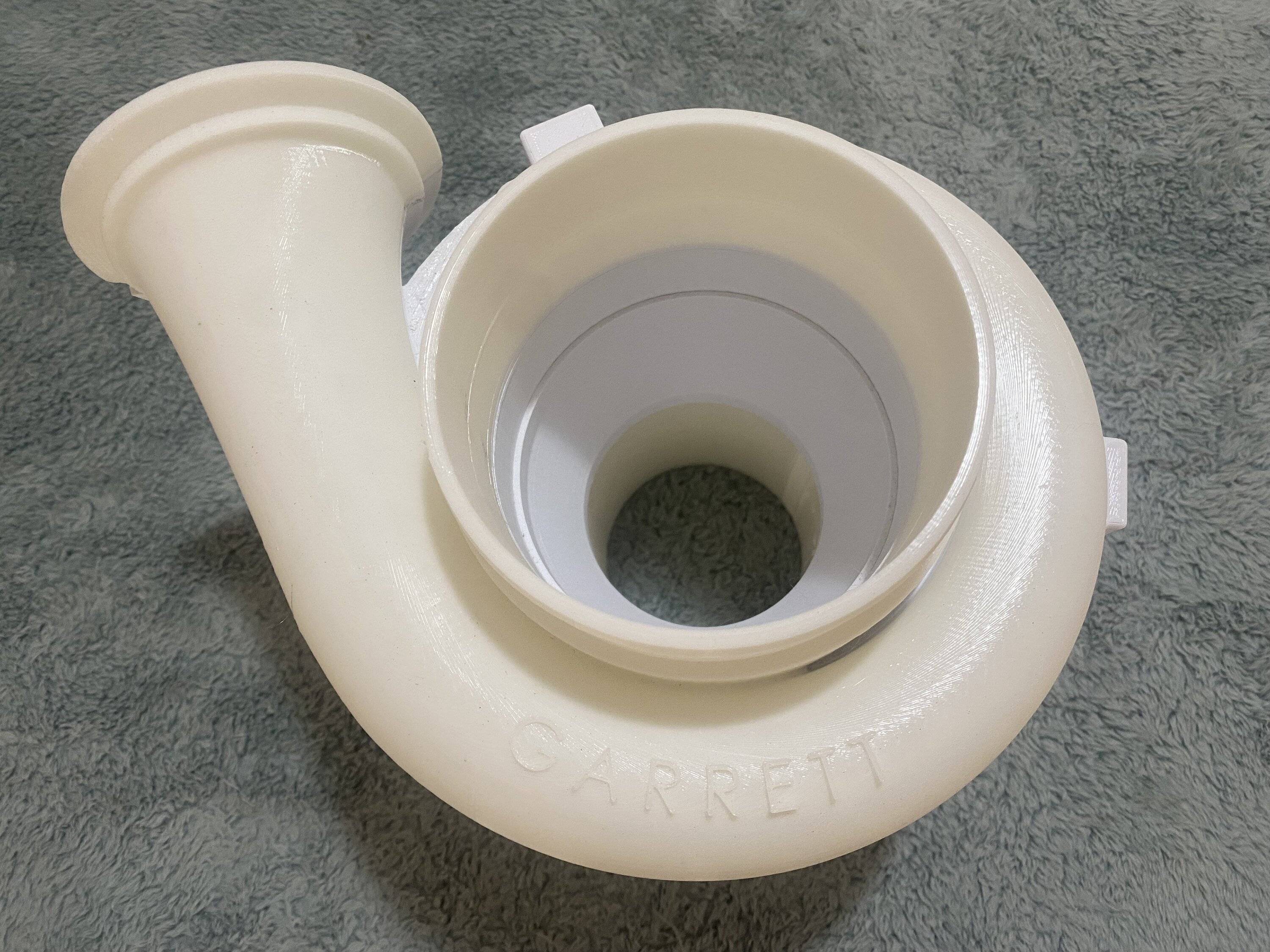

Inspired by @5.oh and spending way to much time on boost adviser and matchbot :inspect: I really like the g42-1200 as well. so I got a mate to 3d print me one to see where I can fit it on an ozzy s550.
