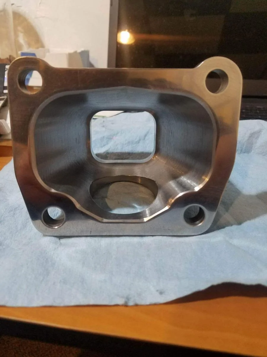

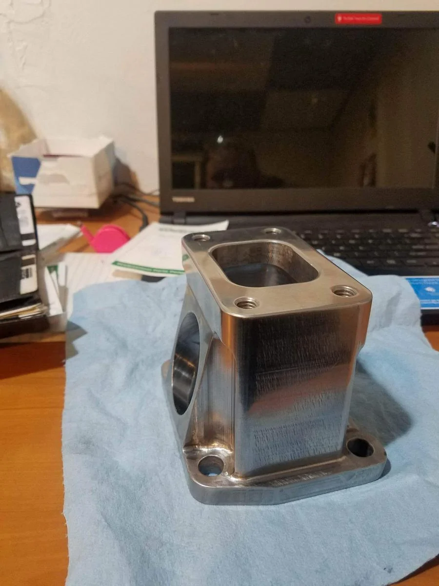

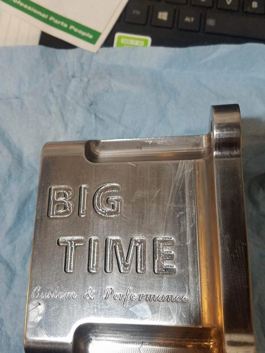

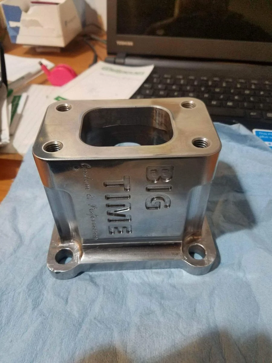

So i have some news that may interest some people on here...
Me and my friend that runs a shop designed a t3 single scroll adapter manifold out of billet steel for my big turbo build. It took a while to design the taper to make it as smooth as possible but its one hell of a piece! The turbo i am going to be using is definately on the big side so most likely will fit most t3 flanged turbos. It also has an angled wastegate port ready to have up to a 45mm flange welded on. Since we have the tooling and design finish we figured we might as well offer this to the ecoboost community so others can build their own turbo kits too. Hopefully the pictures uploaded and you guys can check it out. If we get enough people interested we might do a limited run of these! Let me know if this is something you guys want and what price range you want to try and see these at! Any questions feel free to pm me.

Wow, that's a nice piece. What is your speculative pricing on this adapter?

If you end up selling it, this will make it a lot easier for guys chasing max power. No more painstaking custom jobs.
That thing was made with love, though. How long did it take to get right?

haha about 3 months. had a rough draft made out of the oem and t3 flange to figure out spacing and dimensions then a cad file made to get the taper right, model 3d printed then finally a billet piece made after all of the tooling was figured out.
