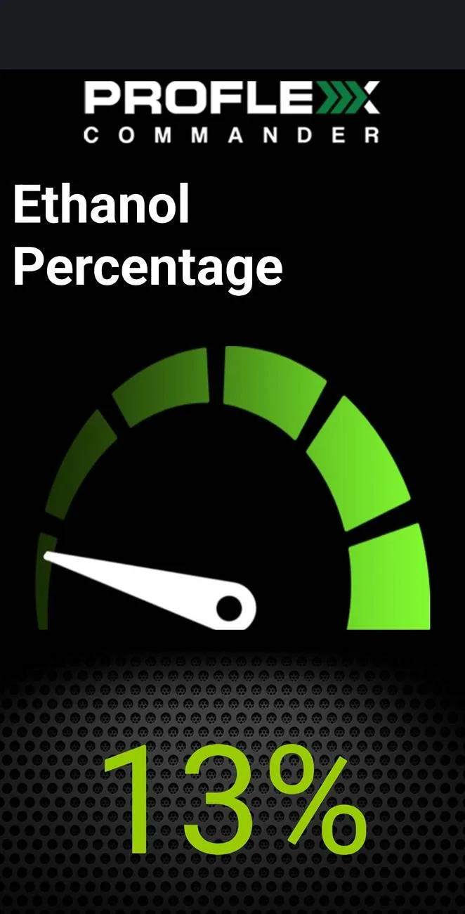

It knows the ethanol content so it can adjust without having to look at lambda

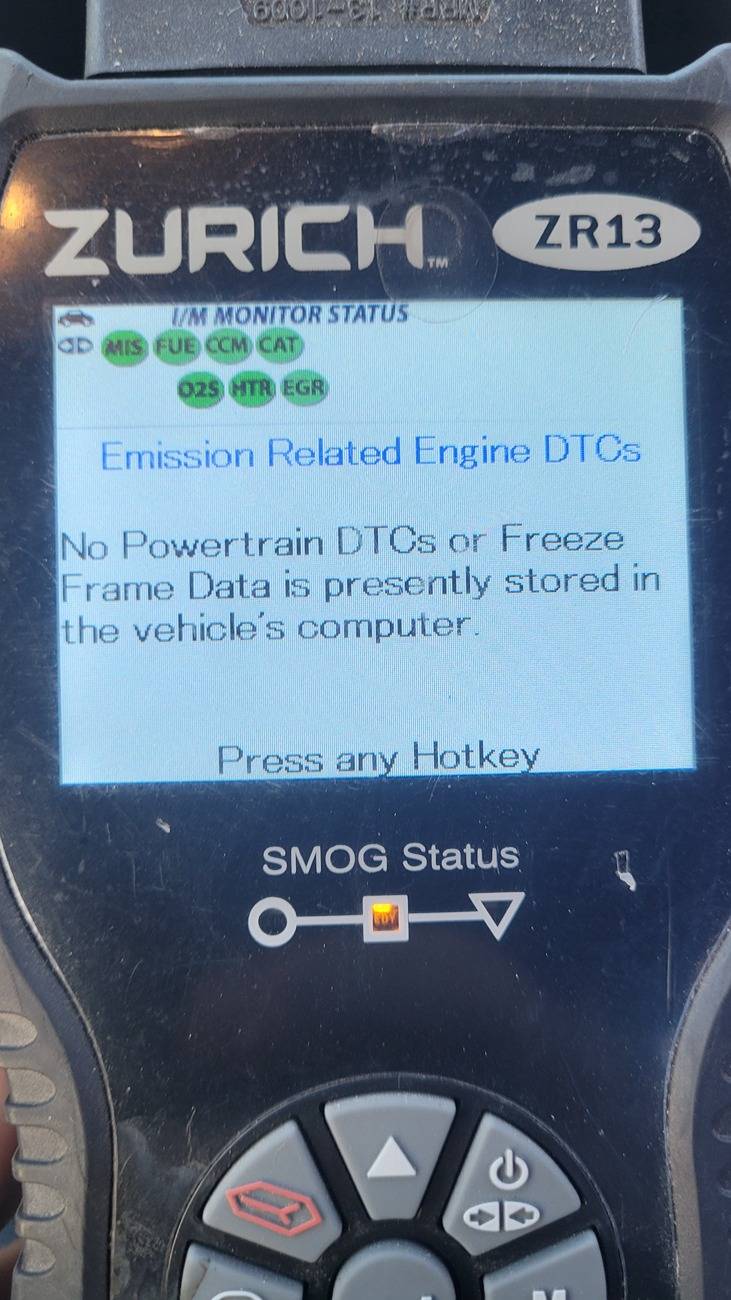

I spoke to Gray at AFD and i may send the unit back once i remove everything for smog. I also need to verify that my O2 sensors are working correctly.

Interesting

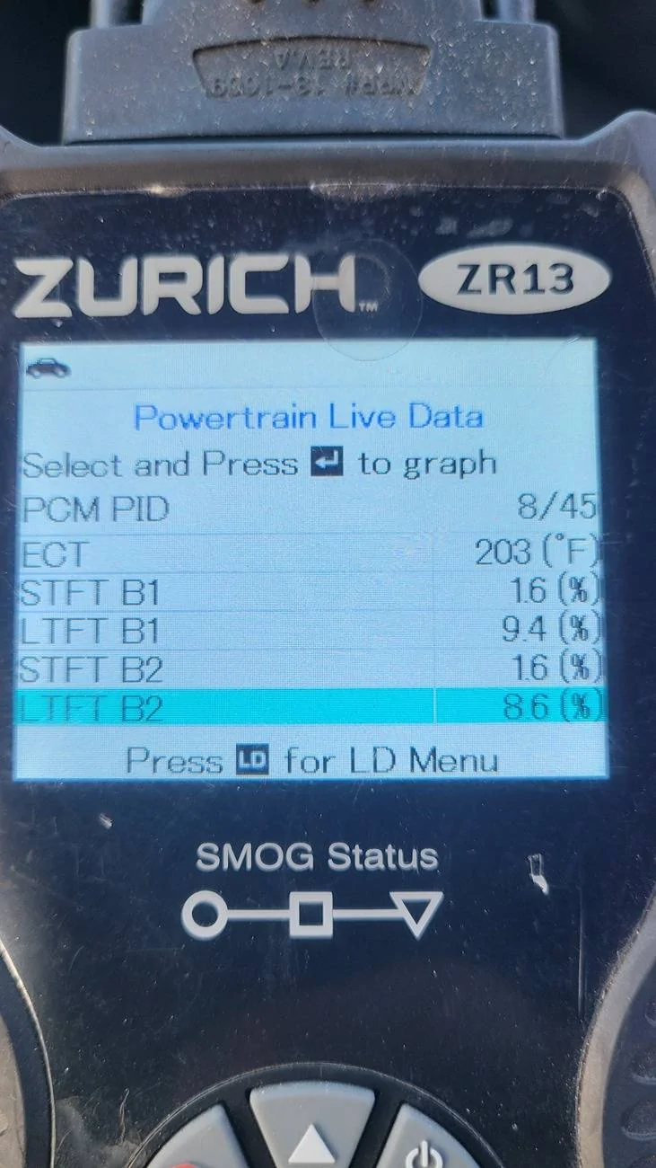

This is at idle. And I'm running straight 91 now. Understably I have a ton of variables going on right now. Same thing happened the other day. I would imagine after driving it's going to rise - pointing to the CAI.
