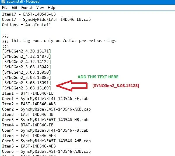

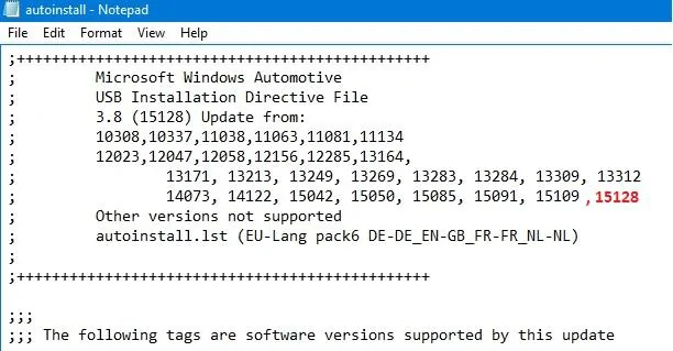

How to install EU 3.08 firmware on to a car with USA 3.08 firmware
This method is only for overwriting the same firmware version with a different location value (ie. Putting EU files on to a car with the same Fw version USA files).
It goes without saying this advice is 100% unofficial, unsupported and is not guaranteed to work. You run the potential of bricking your Sync unit, at which point I don’t know what the answer would be and it would certainly be outside of warranty.
I used this method on my 2015 Ford Focus, running Sync2 3.08.15128 (USA) and changed it to 3.08.15128 EU.
For a copy of the files needed, send a private message either to me, or to EriccB. I will send you a link to my GoogleDrive where the files are stored. Please download them and extract them to a FAT32 format USB drive. After downloading the file from me, feel free to share them further, but do NOT simply pass along the link I gave you… please host them yourself.
When you have extracted the files to the USB, you need to open the autoinstall.lst file (with wordpad) and make some modifications.
1). See photo 1. Add 15128 to the list of supported firmwares at the top of the document.
2). See photo 2. Scroll down almost to the bottom of the document, and add the following text: [SYNCGen2_3.08.15128]
This will allow the system to be overwritten with the same firmware version.
