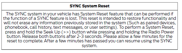

this is in the manual and sure as shit beats removing the battery...
I did that first, didnt help. I read another post on this forum and found that pulling the battery did the trick. (or one of the fuses, forget the number)
