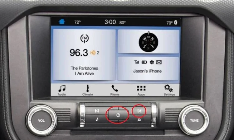

Op - try the following. This is a soft reset for the Sync3 systems in most Fords, including Mustangs. I did it once, and it worked for me, under similar circumstances:
1. Simultaneously (at the same time) press Forward button (>>) and Center power button (audio system power)
2. Continue to HOLD for ~10 seconds. The screen will go black.
3. Release buttons at black screen. System reboots.
Tried this, no luck
