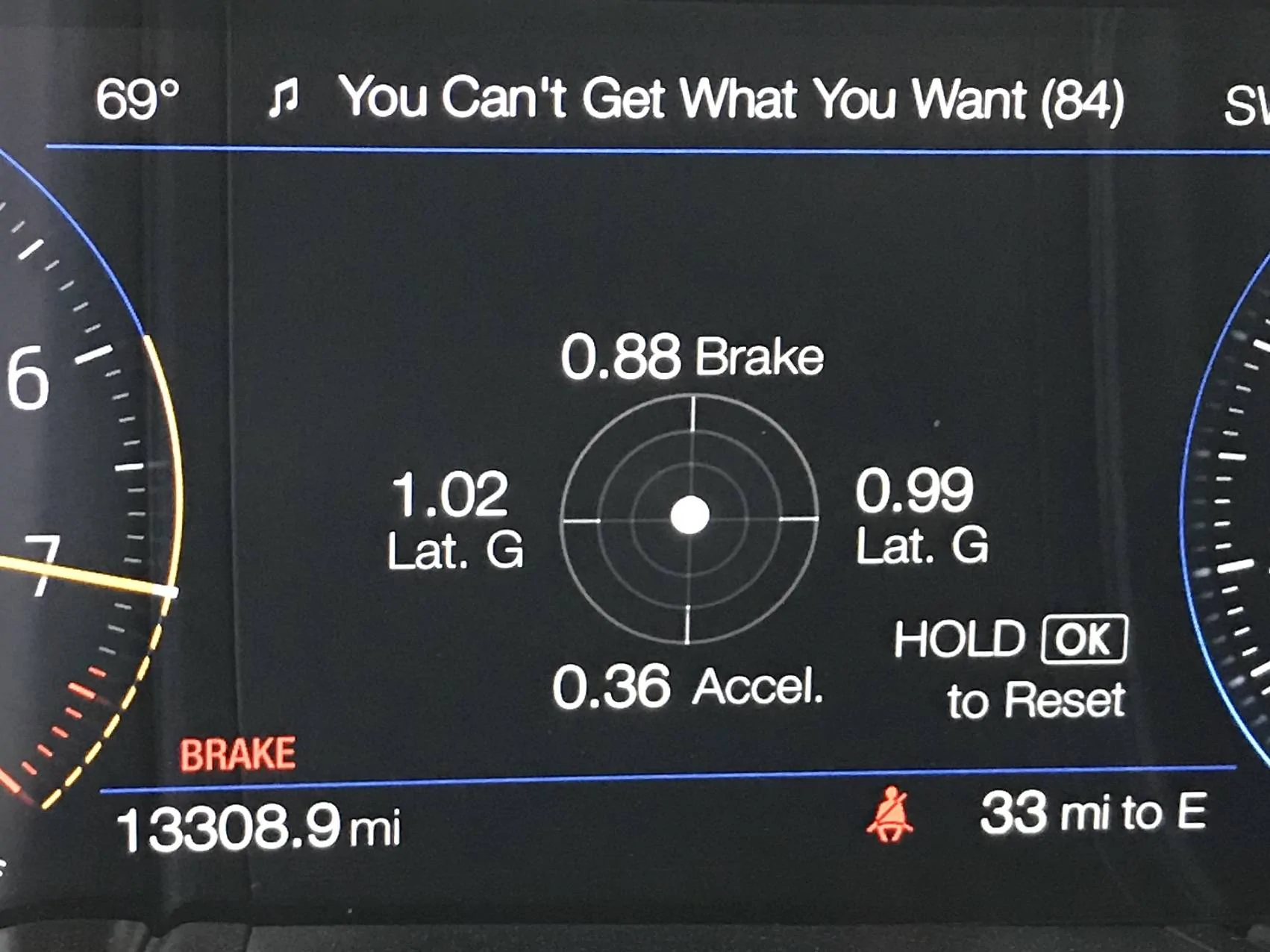

Stock PP1 suspension is plenty competent for anything on the street. Before you start modding, go do a track day or a good trip on some curvy mountain roads. I think you will be impressed. Here is a picture of the g meter after a track day. Since the I have added some Steeda camber plates, jacking rails and got a good sport alignment and I am happy.
