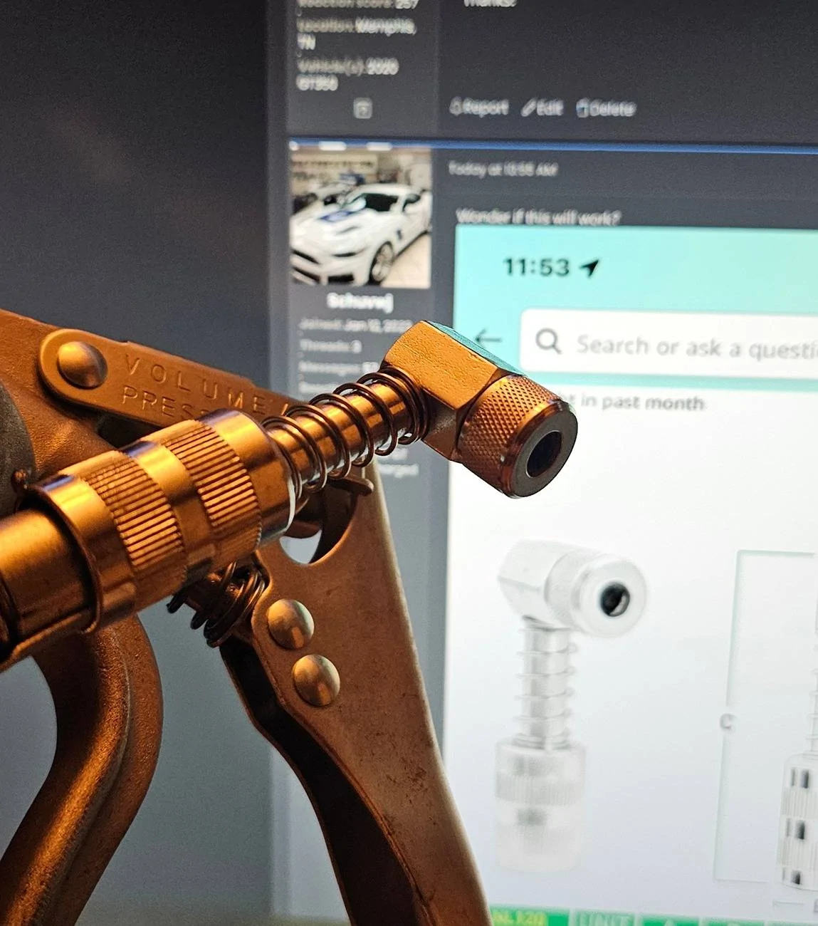

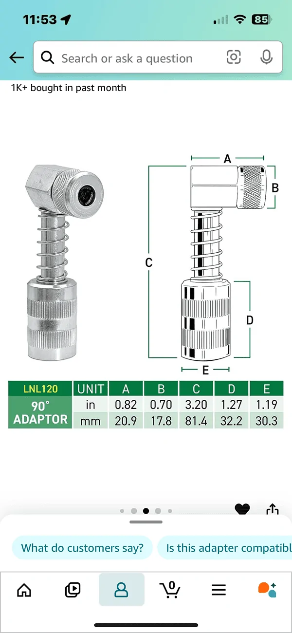

Schuvwj
Jan 12, 2023
82
49
William
2025 Mustang 60th Anniversary Convertible
Wonder if this will work?

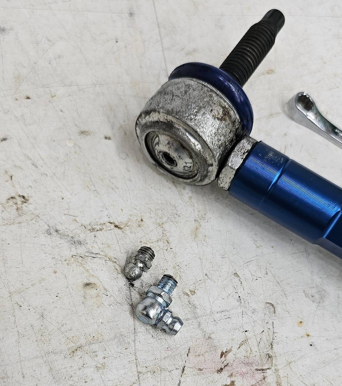

mavisky
Nov 17, 2018
2,399
3,303
Cumming, GA
Kyle
2018 GT350
1/4-28 is right. I use allen screws in place of the grease zerk fittings on mine as the clearance is so tight on the GT350 there's not much room for the actual fittings.
