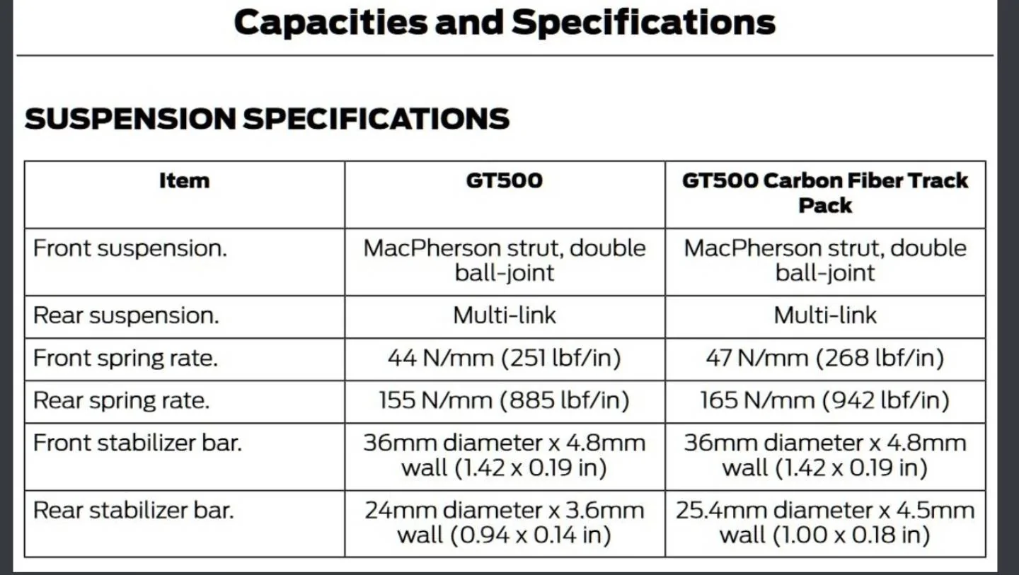

I can't find the size of the OEM sway bars or if they are hollow .
Has anyone upgraded their sway bars?
What did you go with?

Does anyone know if the ford performance track sway bars will work on front and back?
They do, that's what Shelby American installed on my car. Slightly bigger than stock CFTP if I remember correctly.
Could you notice a big difference ? I presume it would take out most of the body roll since the OE is hollow.
So I can't give you an.absolute answer because I hadn't driven my car for over a year while it was at Shelby American. That, and they changed the springs to adjustable height springs. A few months after having the car back, I took them out for stock CFTP springs. So, 1.5 "ish" years between driving it on stock suspension, to where it is now.
That said, I find the body roll less than I remember.

Kept the stock front sway bar.
I went with the Steeda 1” adjustable rear sway bar. Run it on the medium setting.
OP, take heed in this post. That's a quality rear bar and the adjustment gives you the opportunity to tune it to fit your needs.
